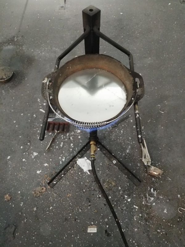

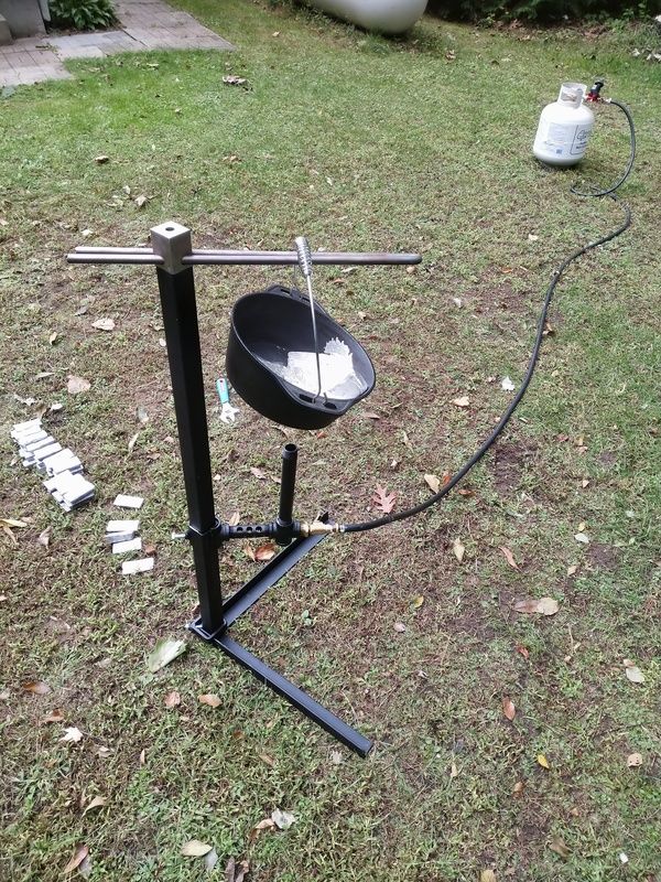

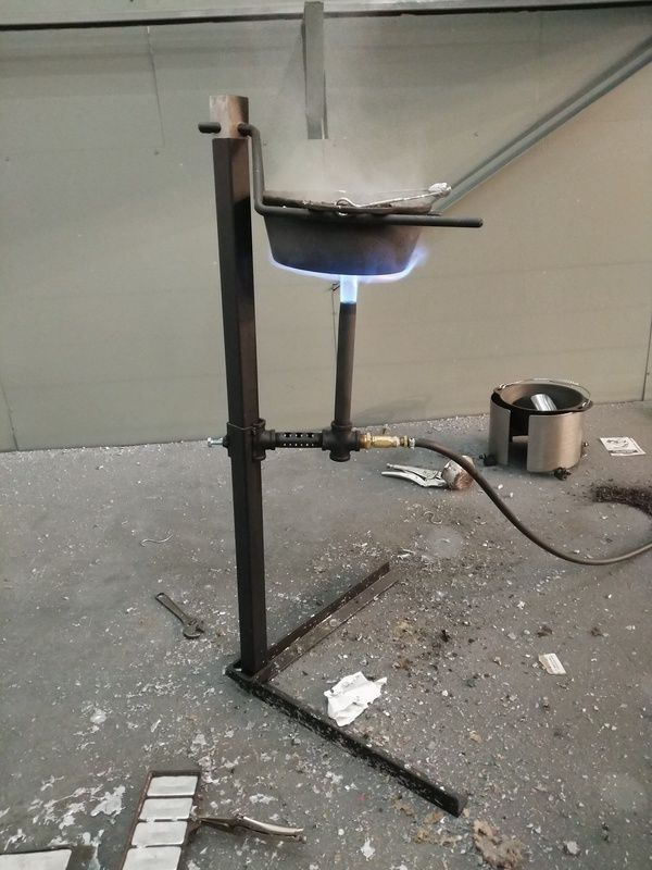

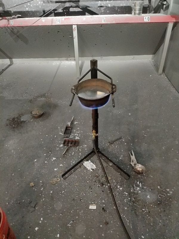

So, without further delay, here's my newest addition to my casting set up ...
I started with a home made forge torch, built along the lines of some outlined on YouTube ... Inspired by designs like this ...
http://www.youtube.com/watch?v=PaaH1Sbr ... e=youtu.be
Instead of drilling through holes and using set screws to to secure everything in place, I took a 3/4 NPT - 1/8 NPT reducer, tapped the inside of the reducer, and secured my 1/8 nipple to the side I tapped, then used the 3/4 npt thread to secure the brass fittings into a black pipe cross, tightening until the fuel hole lined up with one of the perpendicular holes. I chose a cross instead of a plain T to allow for more air intake.
Originally I thought I would just hang the cast iron pot from the handle, but that wasn't very safe. The pot was very easy to tip and when full of molten lead, would not have been fun. Here's a picture from my first trial run.
The solution was a set of angled rods instead of a straight piece doubled back.
This actually worked out great. Originally I was going to weld them straight out from each other, but realized when mocking it up, the taper of the pot would force the arms open allowing the pot to rest on the side tabs.
My regulator is set much lower than anyone on YouTube (around 3psi), but they're building foundries, presumably for steel and aluminum, and I'm melting lead. Melt time was very fast, next time i'll be starting with a full pot, which is optimum, so it should be even faster, I'll time it when I start her up.
Another great advantage is for alloying metals. When I was done, I flipped the pot just to see how much the lead would stick, it fell right out. I could stamp the details in that 25 pound puck and store it until I wanted to use that alloy again, without using a different pot.
I was able to process about 200 lbs of range scrap lead in 6 hours, and I see some easy changes I can make.
I am on the lookout for another cheap cast iron pot, I want to drill into the side and install a spigot of some sort, allowing for bottom pouring, and using more of the lead in the pot than the ladle method I used on Saturday.
Quick edit: forgot one of my favourite parts - it all breaks apart or folds together into a nice, compact package for storing! The legs fold against the spine, the torch slides off and coils up with the fuel line and regulator, and the pot arms slide forward to pack flat. Very small space friendly.
