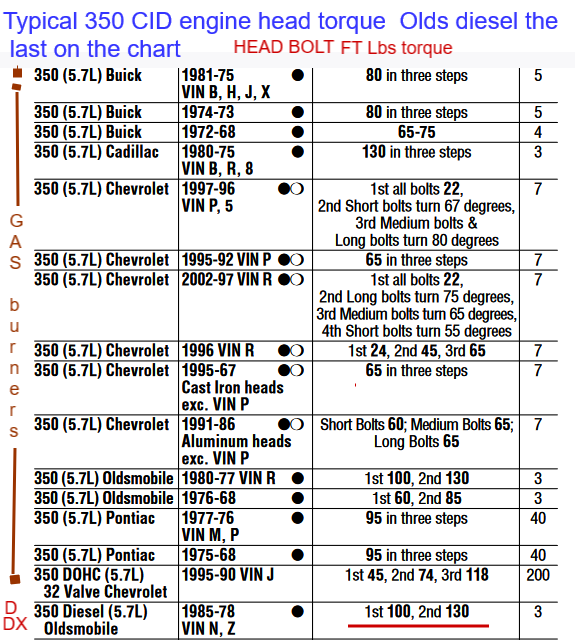

Did you ever do anything with your DX diesel, yea I know it's been 8 years since your post.
I was a GM mechanic of the OLDS engine for most of the time they where out running around, and got very proficient at it, with the proper GM training in NEW ORLEANS LA. I actually got a shoulder condition from torquing so many head bolts, first pass was 100 ft pounds the second pass was 130 ft pounds, it was very awkward when the engine was in the vehicle, it was easier to torque head bots on Caterpillar 3208 while sitting on a truck chassis or frame.
Most people were and still are MIS-informed and UNeducated about the OLDSMOBILE DIESEL engine project.
While the block and the heads where very similar. BUT they where not identical. The engine was rushed out without many trials. and research.
One of their main failures was not adding an extra eight to bolts to the original ten bolt head pattern.
https://www.popularmechanics.com/cars/a ... e-diesels/
"""πšƒπš˜ πš‹πšŽπšπš’πš— πš πš’πšπš‘, π™Ύπš•πšπšœπš–πš˜πš‹πš’πš•πšŽ πš™πš˜πš πšŽπš›πšπš›πšŠπš’πš— πšŽπš—πšπš’πš—πšŽπšŽπš›πšœ πš‹πšŠπšœπšŽπš πšπš‘πšŽ πšπšŽπšœπš’πšπš— πš˜πš— πšπš‘πšŽ πšπš’πšŸπš’πšœπš’πš˜πš—'𝚜 πš πšŽπš•πš•-πšπš›πš˜πš 𝟹𝟻𝟢-πšŒπšžπš‹πš’πšŒ-πš’πš—πšŒπš‘ πš…πŸΎ. π™³πš˜πš—'𝚝 πš‹πšŽπš•πš’πšŽπšŸπšŽ πšπš‘πšŽ πš•πšŽπšπšŽπš—πš πšπš‘πšŠπš πšπš‘πšŽπš’ πšœπš’πš–πš™πš•πš’ πšœπš•πšŠπš™πš™πšŽπš πš—πšŽπš  πš‘πšŽπšŠπšπšœ πš˜πš— πšπš‘πšŽ πšœπšπšŠπš—πšπšŠπš›πš πš‹πš•πš˜πšŒπš”. πšƒπš‘πšŽ πš—πšŽπš  πš‹πš•πš˜πšŒπš” 𝚠𝚊𝚜 πš›πšŽπš’πš—πšπš˜πš›πšŒπšŽπš πšŠπš—πš 𝚠𝚊𝚜 πš‹πšžπš’πš•πš 𝚘𝚏 𝚊 πšœπšπšžπš›πšπš’πšŽπš› 𝚌𝚊𝚜𝚝-πš’πš›πš˜πš— πšŠπš•πš•πš˜πš’, πš‹πšžπš πš‹πš•πš˜πšŒπš”πšœ πš πšŽπš›πšŽπš—'𝚝 πš›πšŽπšŠπš•πš•πš’ πšπš‘πšŽ πš™πš›πš˜πš‹πš•πšŽπš–.
π™Όπš˜πšœπš 𝚘𝚏 πšπš‘πšŽ πšπš›πš˜πšžπš‹πš•πšŽ πšŒπšŠπš–πšŽ πšπš›πš˜πš– πšπš‘πšŽ πš‘πšŽπšŠπšπšœ πšŠπš—πš πšπš‘πšŽ πšπšžπšŽπš• πšœπš’πšœπšπšŽπš–. π™³πš’πšŽπšœπšŽπš• πšŽπš—πšπš’πš—πšŽπšœ πš˜πš™πšŽπš›πšŠπšπšŽ πšžπšœπš’πš—πš 𝚊 πšŒπš˜πš–πš™πš›πšŽπšœπšœπš’πš˜πš—-πš’πšπš—πš’πšπš’πš˜πš— πšœπšŒπš‘πšŽπš–πšŽ. πšƒπš‘πšŽ πš’πšπšŽπšŠπš• 𝚐𝚊𝚜 πš•πšŠπš πšœ πšπšŽπš•πš• 𝚞𝚜 πšπš‘πšŠπš 𝚊𝚜 𝚊 πšŸπš˜πš•πšžπš–πšŽ 𝚘𝚏 𝚐𝚊𝚜 πš’πšœ πšŒπš˜πš–πš™πš›πšŽπšœπšœπšŽπš, πš’πšπšœ πšπšŽπš–πš™πšŽπš›πšŠπšπšžπš›πšŽ 𝚐𝚘𝚎𝚜 πšžπš™, πšŠπš—πš, πš’πš— πšπš‘πšŽ 𝚌𝚊𝚜𝚎 𝚘𝚏 𝚊 πšπš’πšŽπšœπšŽπš• πšŽπš—πšπš’πš—πšŽ, πš’πš'𝚜 πšŒπš˜πš–πš™πš›πšŽπšœπšœπšŽπš πšžπš—πšπš’πš• πšπš‘πšŽ πšπš’πšŽπšœπšŽπš• πšπšžπšŽπš• πš’πš— πšπš‘πšŽ πšŒπš˜πš–πš‹πšžπšœπšπš’πš˜πš— πšŒπš‘πšŠπš–πš‹πšŽπš› πš’πšπš—πš’πšπšŽπšœ. πšƒπš‘πš’πšœ πš•πšŽπšŠπšπšœ 𝚝𝚘 πš–πšžπšŒπš‘ πš‘πš’πšπš‘πšŽπš› πšŒπš˜πš–πš™πš›πšŽπšœπšœπš’πš˜πš— πš›πšŠπšπš’πš˜πšœ πšŠπš—πš πšŒπš˜πš–πš‹πšžπšœπšπš’πš˜πš— πšŒπš‘πšŠπš–πš‹πšŽπš› πš™πš›πšŽπšœπšœπšžπš›πšŽπšœ πšπš‘πšŠπš— πšŠπš›πšŽ πš™πš›πšŽπšœπšŽπš—πš πš’πš— 𝚊 πšπšŠπšœπš˜πš•πš’πš—πšŽ πšŽπš—πšπš’πš—πšŽ. πšƒπš’πš™πš’πšŒπšŠπš•πš•πš’, πšπš’πšŽπšœπšŽπš• πšŽπš—πšπš’πš—πšŽπšœ πš‘πšŠπšŸπšŽ πš–πš˜πš›πšŽ πšŠπš—πš πšœπšπš›πš˜πš—πšπšŽπš› πš‘πšŽπšŠπš πš‹πš˜πš•πšπšœ 𝚝𝚘 πšŒπš˜πš–πš™πšŽπš—πšœπšŠπšπšŽ πšπš˜πš› πšπš‘πšŽ πšπš’πšŽπšœπšŽπš•'𝚜 πš‘πš’πšπš‘πšŽπš› πšŒπš’πš•πš’πš—πšπšŽπš› πš™πš›πšŽπšœπšœπšžπš›πšŽ.
πšƒπš‘πšŽ π™Ύπš•πšπšœπš–πš˜πš‹πš’πš•πšŽ πšπš’πšŽπšœπšŽπš•, πš‘πš˜πš πšŽπšŸπšŽπš›, πš–πšŠπš’πš—πšπšŠπš’πš—πšŽπš πšπš‘πšŽ πšœπšŠπš–πšŽ 𝟷𝟢-πš‹πš˜πš•πš πš™πšŠπšπšπšŽπš›πš— πšŠπš—πš πš‘πšŽπšŠπš πš‹πš˜πš•πšπšœ 𝚊𝚜 πšπšŠπšœπš˜πš•πš’πš—πšŽ πšŽπš—πšπš’πš—πšŽπšœ, 𝚜𝚘 πšπš‘πšŠπš πšŒπš˜πš–πš–πš˜πš— πš™πš›πš˜πšπšžπšŒπšπš’πš˜πš— πšπš˜πš˜πš•πš’πš—πš πšŒπš˜πšžπš•πš πš‹πšŽ 𝚞𝚜𝚎𝚍 πšπš˜πš› πš‹πš˜πšπš‘ πšπš‘πšŽ πšπšŠπšœπš˜πš•πš’πš—πšŽ πšŠπš—πš πšπš’πšŽπšœπšŽπš• πšŽπš—πšπš’πš—πšŽπšœ""""
https://fme-cat.com/livedocs/662(2-1).pdf
Fel-Pro No. 8983 PT. BLACK Printoseal, standard thickness.
Use when pistons project above deck not more than .025” or when the cylinder block has never been resurfaced (except when replacing a GREY colored Printoseal gasket).
Fel-Pro No. 8716 PT-1, GOLD Printoseal , nominal .010” thicker. Use when pistons project .026” to a maximum of .032” above deck or in conjuction when the cylinder block has also been resurfaced (or when replacing a GREY colored Printoseal gasket). Both of these gaskets are manufactured with a 4.170”bore size and will cover cylinder bore sizes from standard 4.057”up to an overbore of 4.097”.
The additional bore size of the gasket also accommodates minimum uniform chamfer.NOTE: Resurfacing of the cylinder head does not determine the choice of head gaskets for this engine. Select the correct gasket according to the piston projection measurement above the deck of the block.The thickness of the head gasket in relation to piston projection will determine the final critical compression ratio.CAUTION: To obtain optimum sealing conditions on the cylinder head gasket surface, the fuel injection pre-cup inserts should be flush with the casting surface. Under no circumstances do we recommended a variation of more than .002” above or below the casting surface.
HEAD BOLTS FOR GM DIESEL ENGINE 1978-80A new type head bolts is available for the 5.7l engines
https://studylib.net/doc/8256762/torque-tablestm page 20
+9Image
Tore down many 350 D DX models and Standadyne fuel injection pumps and cleaned many injectors and put them back successfully, sometimes heads had acceptable minor cracks. The heads with severe cracks where chucked from so much heat exposure to overheating due to owner neglect when they ignored the temp light due to overheating from lack of coolant.
The worst I ever experienced was an engine that the injectors springs turned blue the owner basically grove it until it nearly seized, he did not succeed. The engine quit running when the fuel would no longer be atomized by the injectors at 1200 PSI. When I checked the injector pop off pressure many could hardly manage 200 PSI somewhere well below that 160 to 180. I did not tear the engine down for inspection from my recollection, it would have been a futile endeavor. some of the plastic and rubber parts visible to the naked eye had started to melt and changed their appearance the vehicle was bought off by GM the ower probably bought labor vehicle somewhere else I believe he was an out towner that happened back in 1983.
I still remember the dark blue Cutlass sedan, in fact, I took out the extra 20-gallon aluminum diesel tank bolted in the trunk out of it and took it home before they hauled out for scrap. Never even put the injectors and tried to start it, The GM factory representative and my manager gave it last RIP rites before deciding to take the heads out if, It sat at out GM dealership for months. I Always wondered what it looked on the inside.
Those engines where built tough They later found out some of the head bolts where faulty material.
