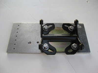

I've completed a couple more mods from my list of off-road/camping/expedition/overlanding/bling! requirements
On board air compressor
I finished up the mechanical part of the compressor install
Here is the compressor's bracket fastened to the thick aluminum base plate. I keep a box of miscellaneous metal plates and angle which get repurposed into things I need for the 4Runner or trailer.
This view shows the dense foam vibration absorption layer between the metal plates.
How the compressor looked on the plate during a test fit. Note that I had swapped out the OEM white plastic connector for a 45 Amp Anderson Power Pole connector. The original connector developed corrosion on the contacts, overheated and melted.
Compressor is installed! The pressure switch and outlet are screwed in too.
