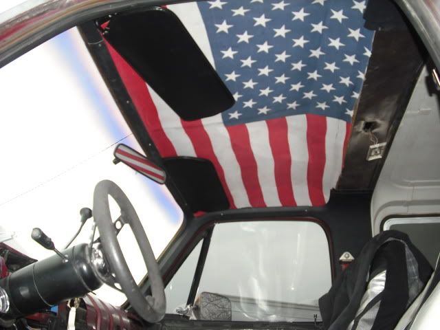

Regulator wrote:Image
America, F@%K YEAH!
and 3M FTW :wink:
Diggin on that dangling dome light :wink:

Regulator
Posts: 1416
Re: Fixing my sagging headliner.
Post by Regulator » Mon Oct 18, 2010 8:22 pm
lonewolf15002000
Yep, I know about flag etiquette. That cheap printed flag started fraying on the end well before it was otherwise damaged. Now, I wasn’t gonna burn my flag just cause of a bit of frayed ends. Hell we all get a bit frayed once in a while. As a headliner that flag has gotten more attention, respect, admiration and positive comments than it ever did on the pole. I think it’s happy there. Ironic that it is a symbol of my freedom to do exactly that. Isn’t America great?!
Darkaxel
Dash is out too. Pretty much had the whole cab torn out for cleaning, painting, repair ext.
