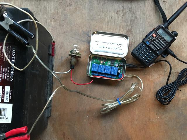

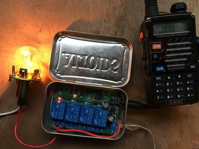

Anywho, they arrived yesterday and been playing with one. Just bench testing so far, luckily I had a 2.5mm to 3.5mm audio cable as the headphone jack on the Baofeng is 2.5mm but the DTMF decoder jack is 3.5mm. The decoder did come with a 3.5mm to 3.5mm cable.
Fits perfectly in a Altoids tin. Connected to a 12v battery to power the DTMF decoder and an auto lamp (just for testing purposes). This shows the overall setup with only the single power LED lit on the decoder:
The default config for the decoder is to momentarily close (1 second) the relay when the corresponding DTMF signal is received, this wasn't what I wanted so I changed the mode to "toggle" so the relay stays latched (open or closed) by soldering the "M0" pad closed. With the auto lamp connected to relay #4, sent a DTMF "4" from a different radio and the relay closes and stays closed until another "4" is sent:
Next will be wiring this into my motion sensor alarm to remotely activate/deactivate it. Have a 12vdc flood lamp *somewhere* that I may connect on one of the other relays for outside lighting around the polebarn. Another possibility I've been thinking about is the ability to remote start my Honda EM5000 generator, we bought the remote start kit for it but rarely used it. When the battery on it died I never replaced it as the gennie never takes more than 3 pulls to start anyway.
