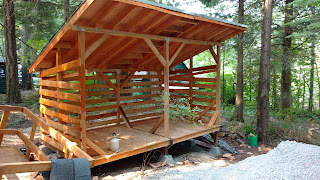

After becoming fed up with tarps and other such things over the last Winter, I resolved to build a woodshed.
My property is sloped (good for drainage, bad for building stuff), so I had to build it on stilts. I dug three trenches and filled them with gravel, then framed out the floor on piers.
After that I did a standard 3/4" plywood floor.
The frame for the roof is mostly made of 4"X4"s.
The roof is built from 1/2" plywood and 12' 2"X6"s.
I installed your basic tarpaper and shingle roof.
After putting up some fence planks to keep the rain off and staining it, I'm done:

Thanks for all the positive comments. I should've mentioned that I started by looking at these plans, although the finished product is very different: https://www.epa.gov/sites/production/fi ... iagram.pdf

While I know there are many considerations required for keeping firewood dry (like airflow), I am woefully uninformed in this subject. Can you go into some of the considerations or limitations you had to keep in mind when constructing your woodshed? Are there specific desirable features you made sure you included in the build?

You pretty much hit the nail on the head - you want to keep the rain off it but also allow it to breathe.
In the research I did before I built the thing people kept mentioning having a 2' overhang on the front side. I went with a little bit more than that to be on the safe side. A week or two ago we got almost two inches of rain one day (temperate rain forest), and everything stayed dry.
The fence slats have the spaces between them so that air can flow through but the majority of the rain is kept off the wood. This seems to be a very common design here, pretty much every woodshed I've seen is built that way.

Nice work. I built mine similarly. If I recall correctly I got my basic design info from a solid fuel heating book from a guy based in New England. But yeah the basics are the same wherever it rains I guess - keep the water off and allow it to breathe.
Most of the guys around here (mostly talking about outdoor boilers) just literally pile their wood (not stacking), often right up against a building, without splitting, not seasoned, etc. This is the basic reason their boilers smoke like a coal fired locomotive giving wood heat a bad name. Of course these are the same knuckleheads that burn railroad ties.
Do you know the capacity? I believe mine is 5 cords stuffed to the gills.

If I did my math right it holds six cords.
Pretty much everybody has wood heat up here. Some folks have propane tanks and you will still come across the odd oil burner here and there. It rains a lot more than in the lower elevations because storms hit the mountain side, so pretty much everybody pays some level of attention to keeping their wood dry.
