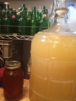

Here's the batch I started about 2 weeks ago.... The primary fermentation is coming to an end, I'll probably end up racking it shortly (next day or two).

Another good yeast to use is a Champagne yeast, don't know the exact kind but it was at the home brew supply in a yellow packet.
This newest yeast I used was a wine yeast..... Unfortunately I lost the data on my phone which I was using to keep track of the Mead. I'll be going down to the local home brew supply store tomorrow to get another 3 gallon carboy, so I'll see if I can find the yeast.
So check back tomorrow for pictures of the racking process!

Keep posting pics Halfapint, I'm not much of a picture taker. Even when we had our MBOs, I had a chapter person post pics :)
Edit:
Last night I timed the bubbles again ... 1 every 26 seconds, I think I'll be racking these 2 this weekend. These are 2 experimental batchs. I used the basic dry mead recipe from storm the castle but to 1 jug I added 2 pasilla peppers and the other 2 ancho peppers. If they taste like crap, I just made cooking wines :)
Edit 2:
Current batches I have fermenting:
1) Orange clove mead (same one as Ana is making) - 3 Gallon, D47 yeast
2) Orange clove mead - 3 Gallon, 1116 yeast
3) Apple pie cyser - 3 gallon, whatever yeast was on the recipe
4) Dry Pasilla Pepper mead - 1 gallon, can't remember yeast
5) Dry Ancho Pepper mead - 1 gallon, can't remember yeast
6) Basic Sweet Mead - 1 gallon, can't remember yeast - friend came over wanting to see how I was doing it
7) Basic Sweet Mead - 1 gallon, can't remember yeast - friend came over wanting to see how I was doing it
