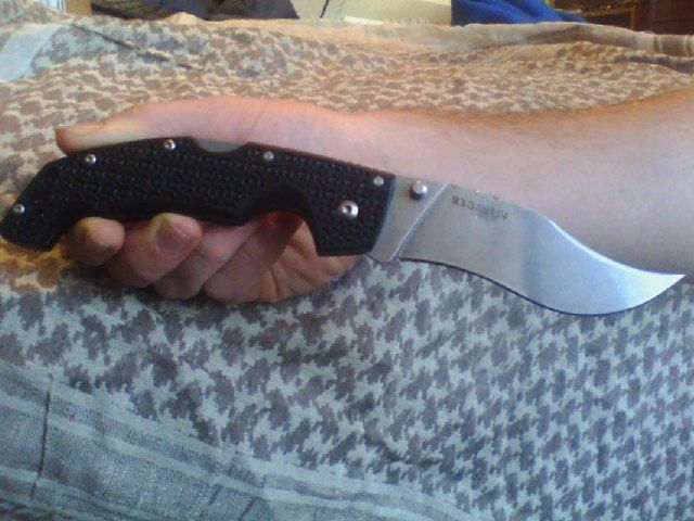

I use a fine stone, then white jeweler's rouge on leather. I started out using it for leather knives, but then immediately started doing it on all of my other knives.
I haven't used an angle guide in years, so far all of my knives are in good shape. I find it helpful to have the tips of my fingers just grazing the sharpening media, it helps with angle reference (for me anyway).
In the field I routinely pass my knives several times over my pant leg after each use. My pants have taken some wear and tear from this, but until then day I stab myself in the thigh/groin, I will continue to do this.
Edit:
In fact, my new knife, Cold Steel Voyager/Vaquero Large, has only been maintained* with the "pass it over the pant leg" technique so far. I need to go buy a round rod for the concave edge!
*I did scratch out the O, Y, and A in "Voyager" on the blade minutes after receiving it using my fine stone, as well as working the spine with a round file a bit.

KentsOkay
Posts: 3207
Re: Knife Skills: Stroppin' Gangnam Style
Post by KentsOkay » Fri Dec 21, 2012 5:12 pm
Jeriah wrote:
KentsOkay wrote:In fact, my new knife, Cold Steel Voyager/Vaquero Large, has only been maintained* with the "pass it over the pant leg" technique so far. I need to go buy a round rod for the concave edge! *I did scratch out the O, Y, and A in "Voyager" on the blade minutes after receiving it using my fine stone, as well as working the spine with a round file a bit.
Oh...oh you...you're good...you're GOOD. I haven't had any interest in that knife, but now I want one so I can do this very thing to it. And then give it to a friend of mine, who would appreciate it.
And also get "FRONT TOWARD ENEMY" etched on my Scottish Basket-Hilt Broadsword.
I slapped some mustard on it too, for a bit of tarnish. Looks good, I'll upload a picture at some point.
KentsOkay
Posts: 3207
Post by KentsOkay » Fri Dec 21, 2012 5:50 pm
TA-DA, picture doesn't do it justice but w/e
