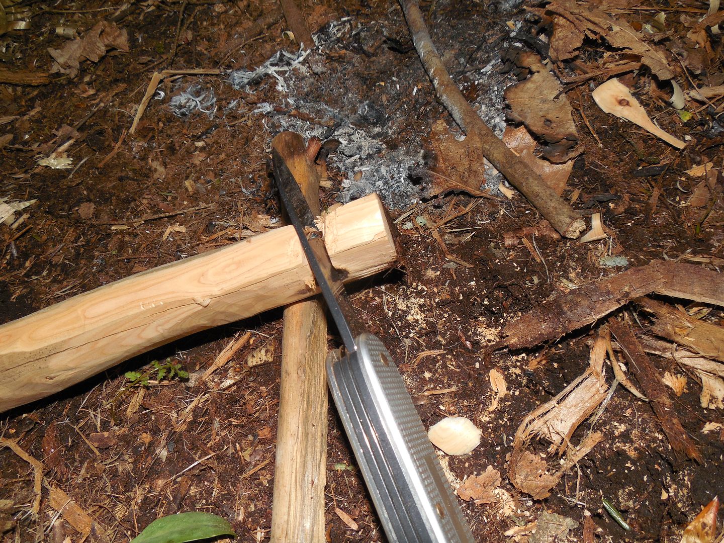

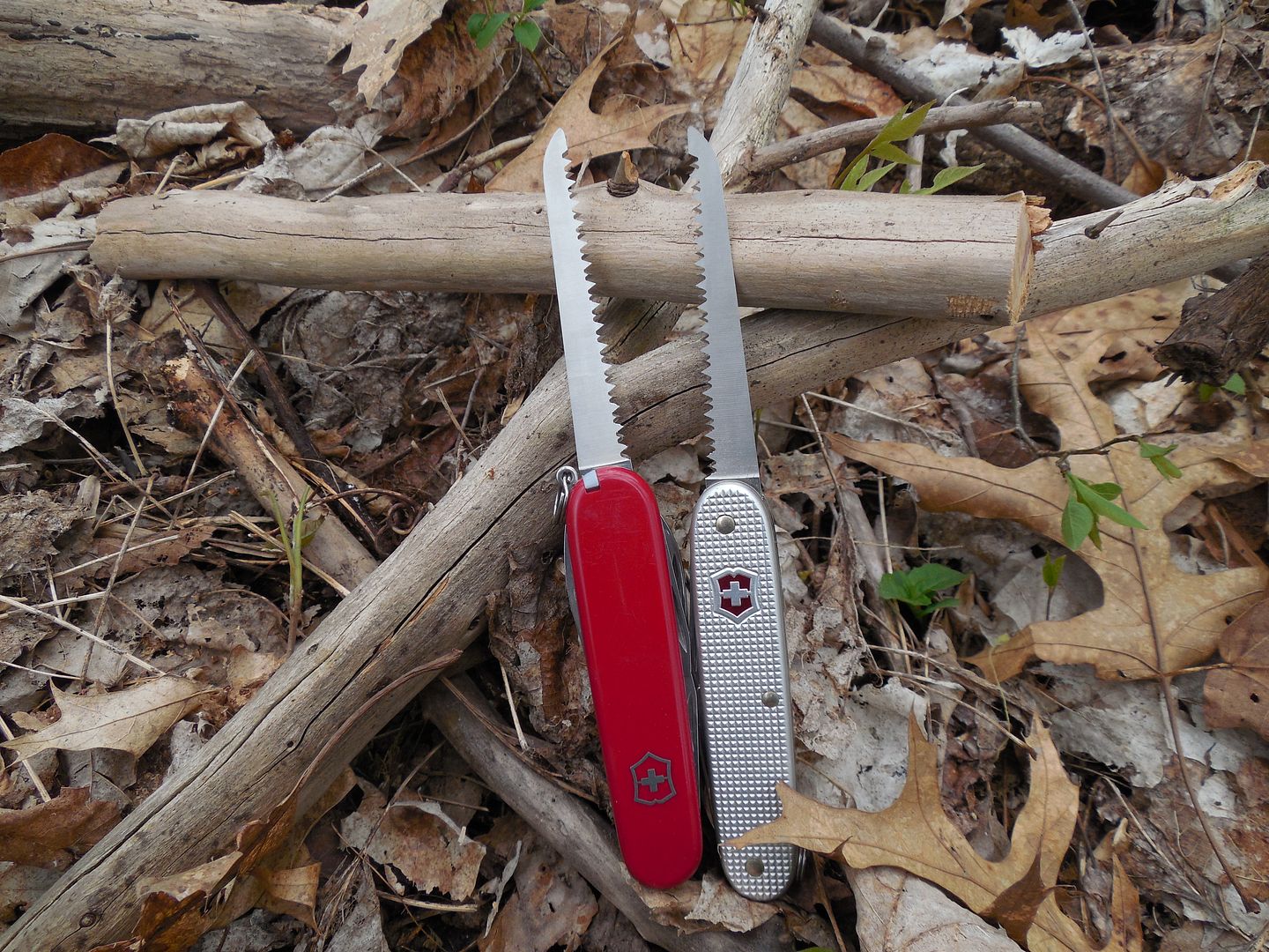

Up first we will employ the saws from each knife.
Near as I can tell they both are identical and made short work of the cedar branch. Also used the saw from the hiker later on to cut a green cooking stick. There is not much red heart wood in this cedar branch which is just fine for my intended application.

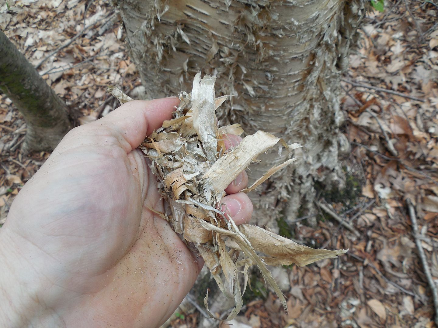

Yellow Birch bark. They hydrocarbons within will make for a great accelerate and tinder combo.
Spring has sprung.
The outer hanging bark can be harvested without doing harm to the tree.

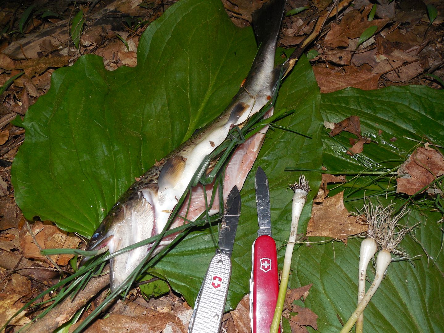

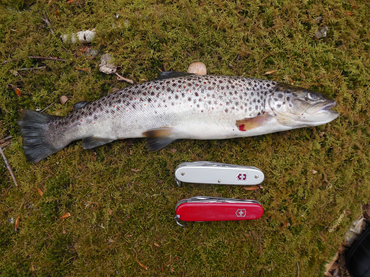

I used the short blade from the hiker to kill it. The short blade did a good job as it was the right length for the task. Having two blades is a pro of the Hiker.
Cleaning the trout using the Farmer blade.
As expected it did just fine. Going to leave the head on.
All done.

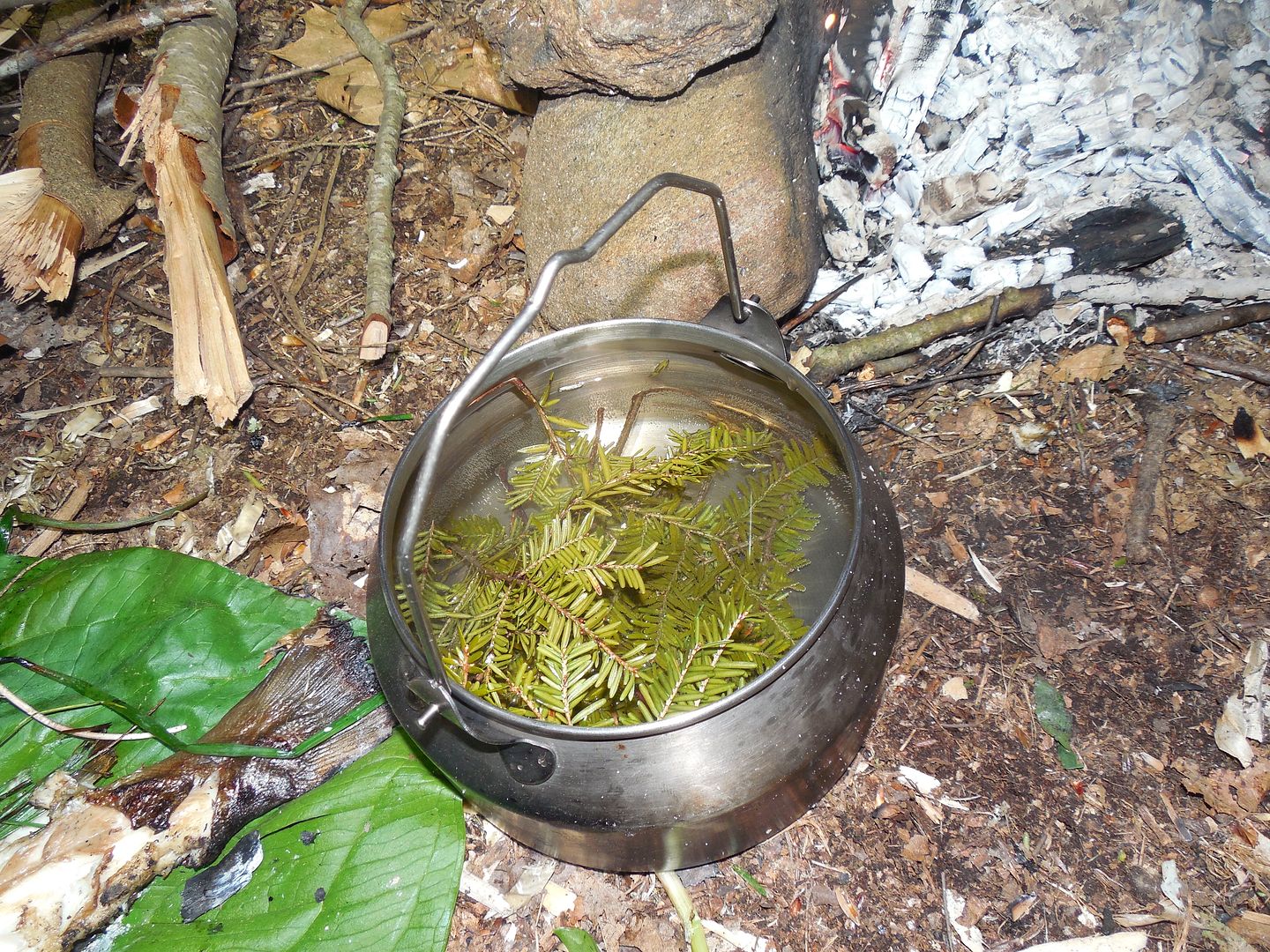

Some Hemlock needles. DO NOT EAT HEMLOCK THE WEED. THOSE WILL KILL YOU. That said the conifer tree needles such as these makes good tea.

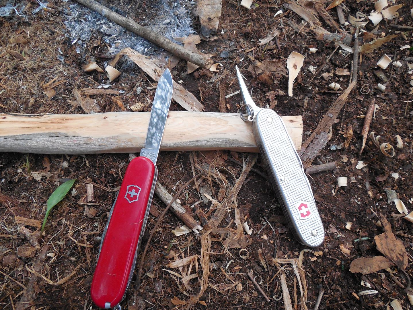

Decided to make a cedar fireboard for future use. Though I have multiple modern methods of fire starting if my back was against the wall would try to build another means before it's actually needed. Gear sometimes vanishes. Both knives did a good job shaving the board and cutting a V groove etc etc. Not looking to spend too much time rather an activity of opportunity and convenience for potential use only if the unlikely should happen.

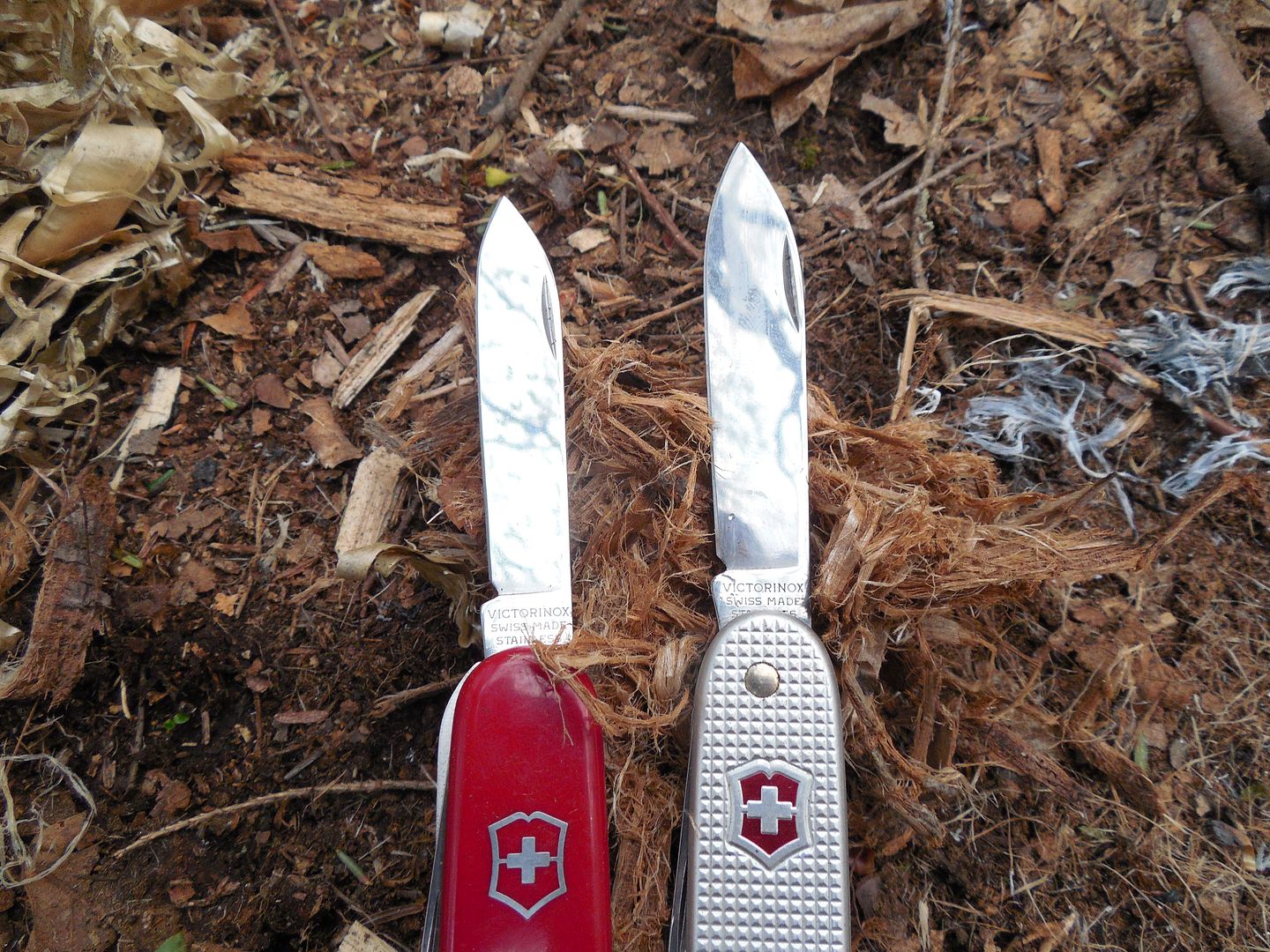

The blade on the Farmer appears to my eyes as both larger and thicker than the primary blade of the Hiker.

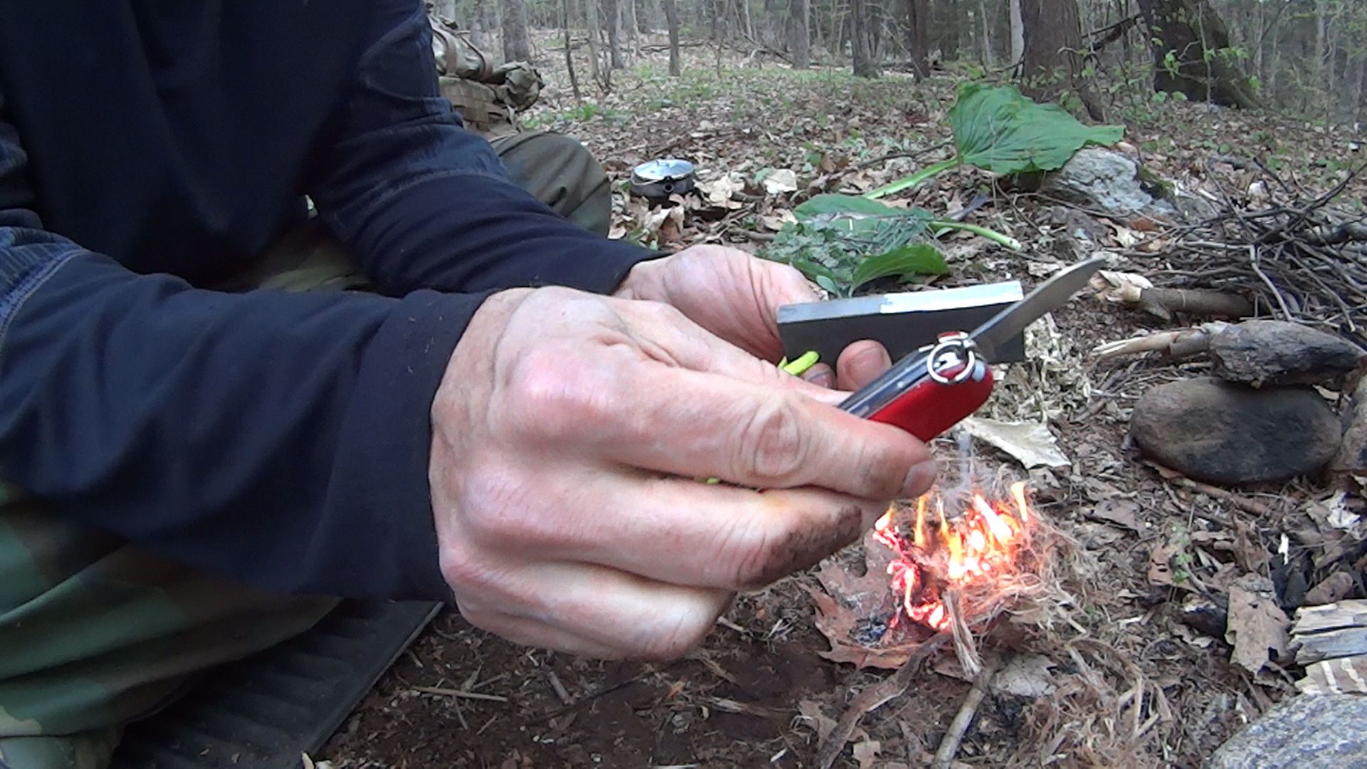

Some SAK firecraft practice.

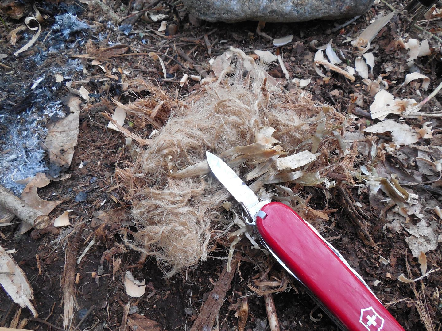

Up first was the Hiker. The Awl in the Hiker IMHO isn't a good striker so will use the smaller blade. The knife has two blades so this won't overly reduce it's field effectiveness. Also the small blade was still workable after the firecraft and easy to resharpen later. Made a fancy jute, tulip poplar and birch bark tinder bundle for later use.
The magnesium bar test. The short blade was able to properly work the bar resulting in ignition of magnesium and then in turn the Tulip poplar bark. Action shots taken from the video at moment of flare up of the magnesium shavings.
The short blade did ok.

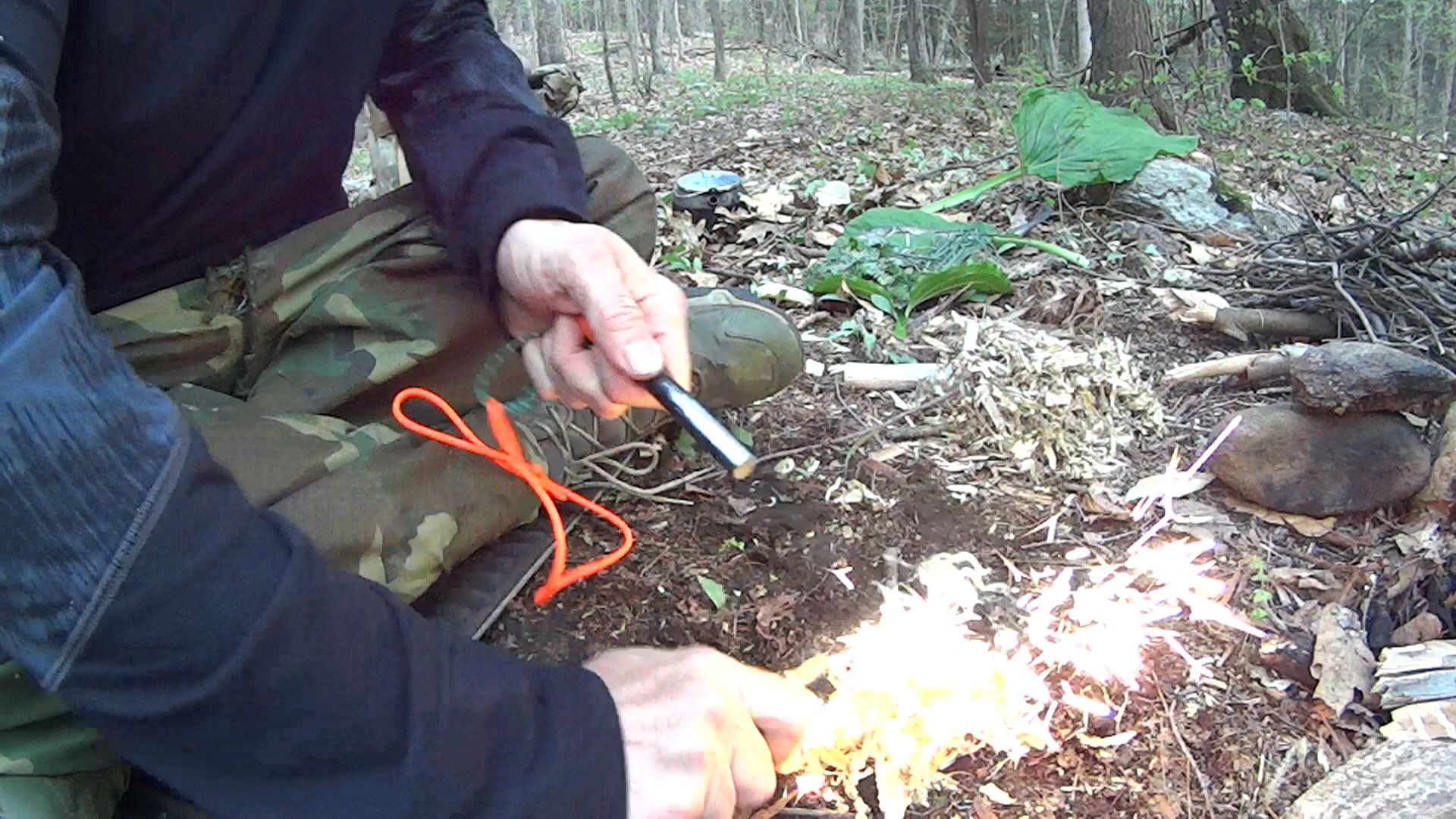

Now for the Birch bark and large ferro rod using the Hiker. Again action shots from the video.
The short blade again did the job but in all honesty it dug into the ferro rod in an annoying way. Maybe I am out of practice using an actual blade to strike a spark as most often use a dedicated striker or knife spine.

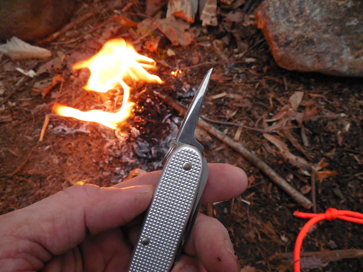

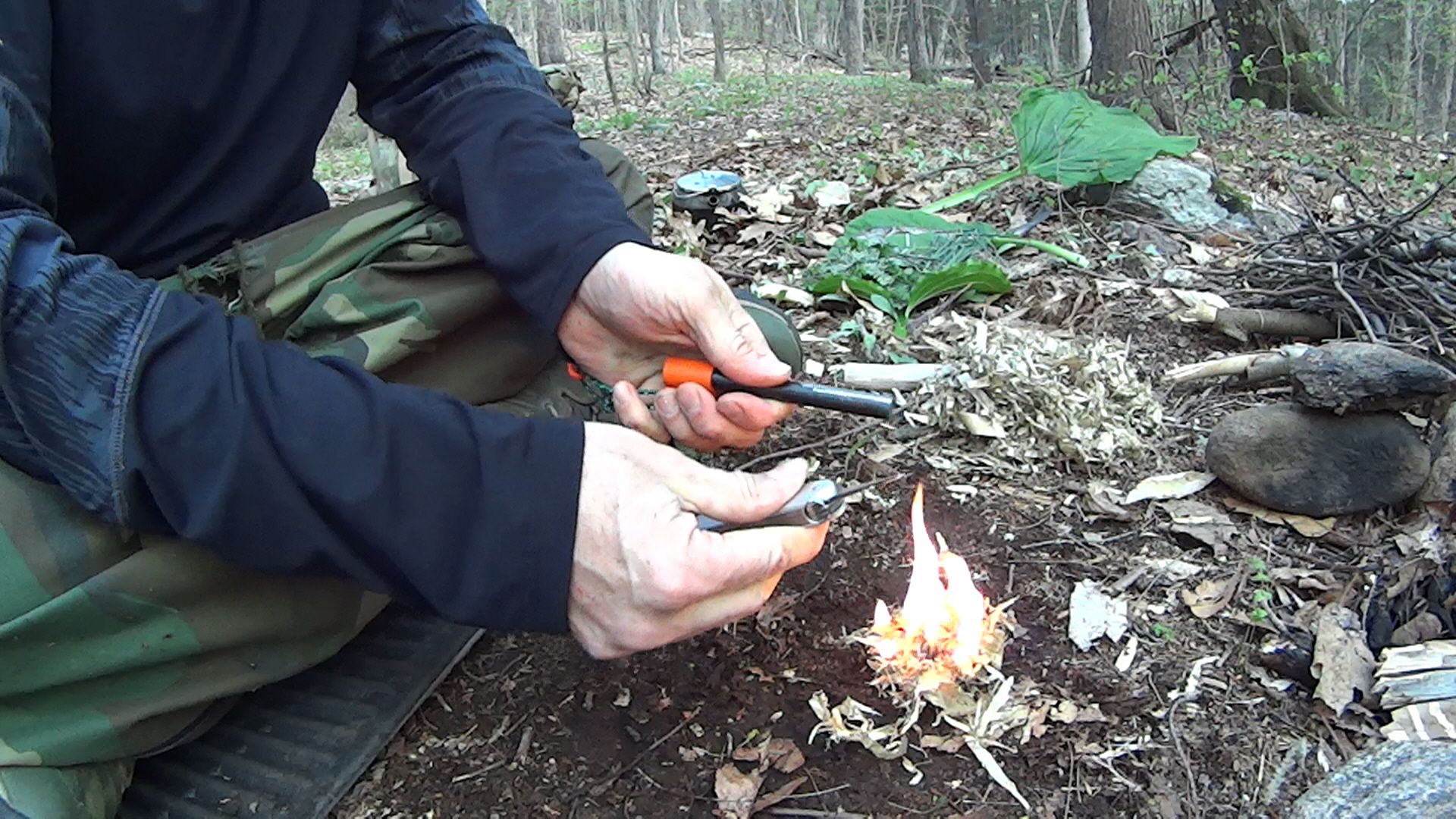

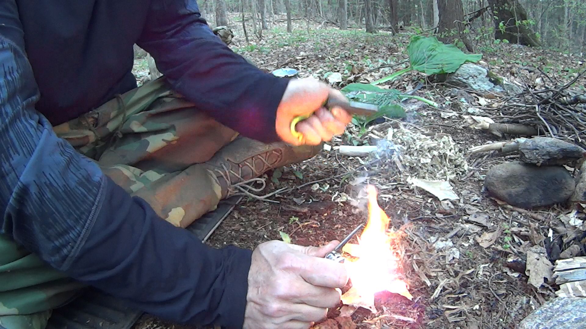

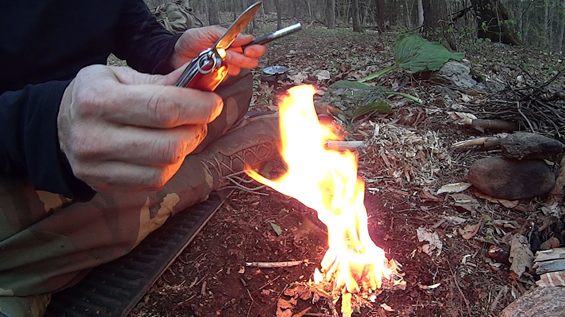

Now for the Farmer. The awl (really reamer) of the Farmer is different than the Hiker's awl.
The magnesium bar/ferro rod combo worked just fine using the Framer's reamer. Better IMHO than the Hiker's small blade.
Large ferro rod and birch bark test using the Farmer.
The birch bark easily ignited. The Framer's reamer is a really good striker.
The firecraft edge (pun intended) goes to the Farmer.

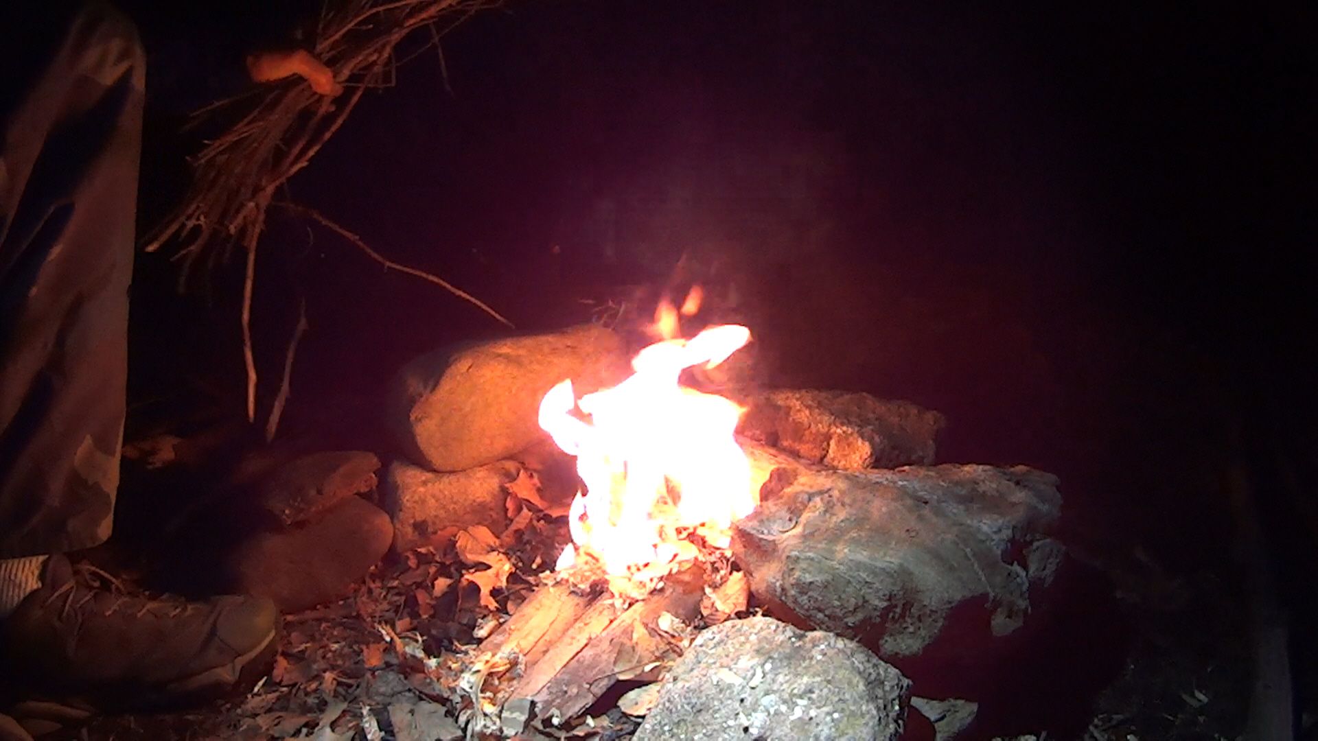

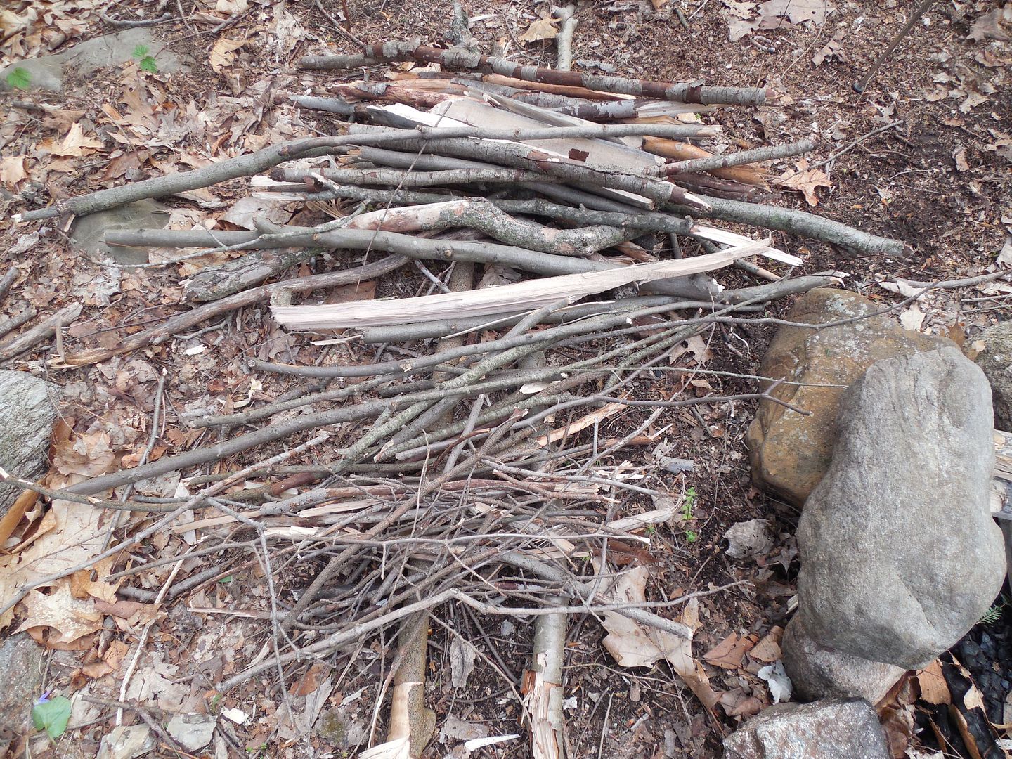

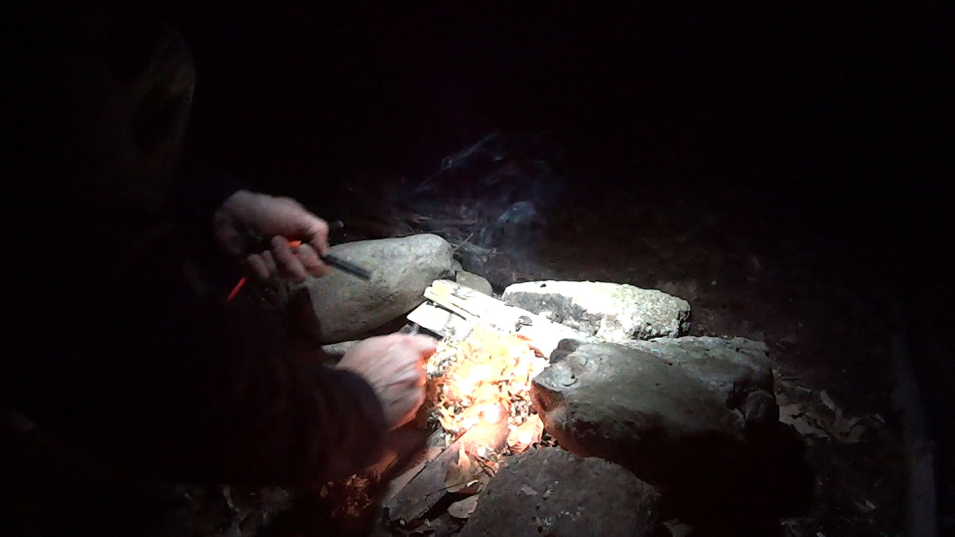

Waited till dinner time to start the real fire to cook our bush meal using the twig fire methodology. This job will given to the firecraft winner the farmer and large ferro rod.
The hydrocarbons within the birch bark are no joke. To take full advantage of their energy I tossed a large handful of sticks upon ignition. Hydrocarbons are a BIG power and like all power it comes with an equally big responsibility. Or so says Stan Lee. LOL!
Me being a goober with the Farmer and ferro rod. That reamer is a nice striker.

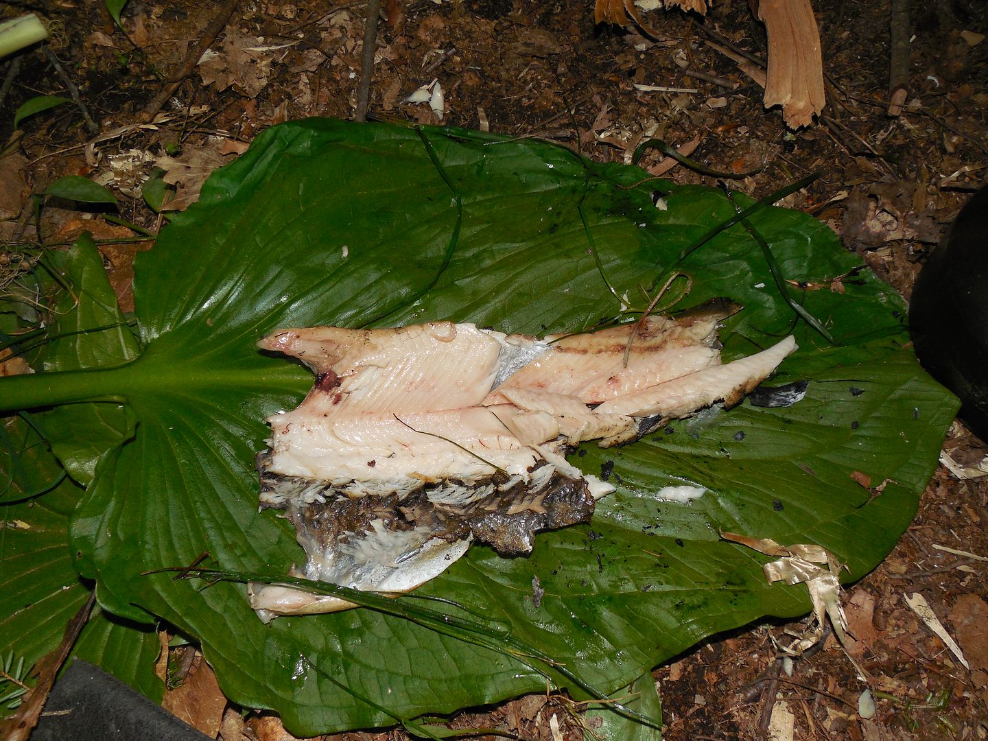

The meal is cooking! The trout hanging over the fire, water warming off to the side and onion appetizers baking on a rock.
The tea is ready!
The trout was fantastic. Remember DO NOT EAT THE SKUNK CABBAGE. It's just being used to keep the dirt off my food. Kinda risky mixing not edible things (this will make you sick) with great eats like the trout. Yea gotta watch what goes into your mouth. Later during the year will replace the skunk cabbage with larger green leaves for this purpose.
