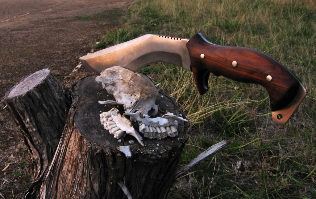

Finally, I did have the time to take a photo of a skull being split in two just before sunset.
Note that it is merely a lowly sheep skull, leaving me outdone by the badarse coyote (?) skull Stormcrow used in his most recent Zombie Cleaver.

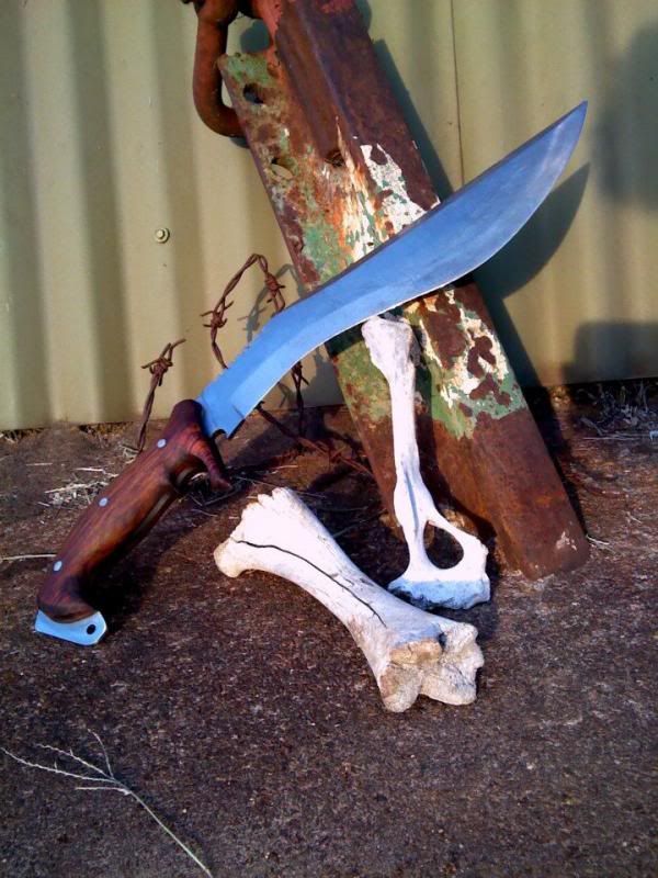

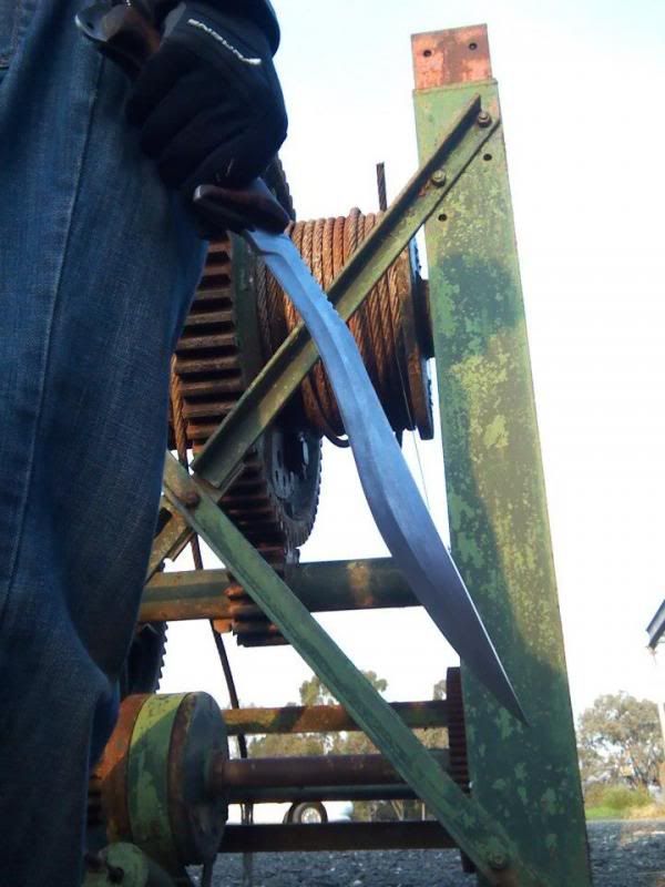

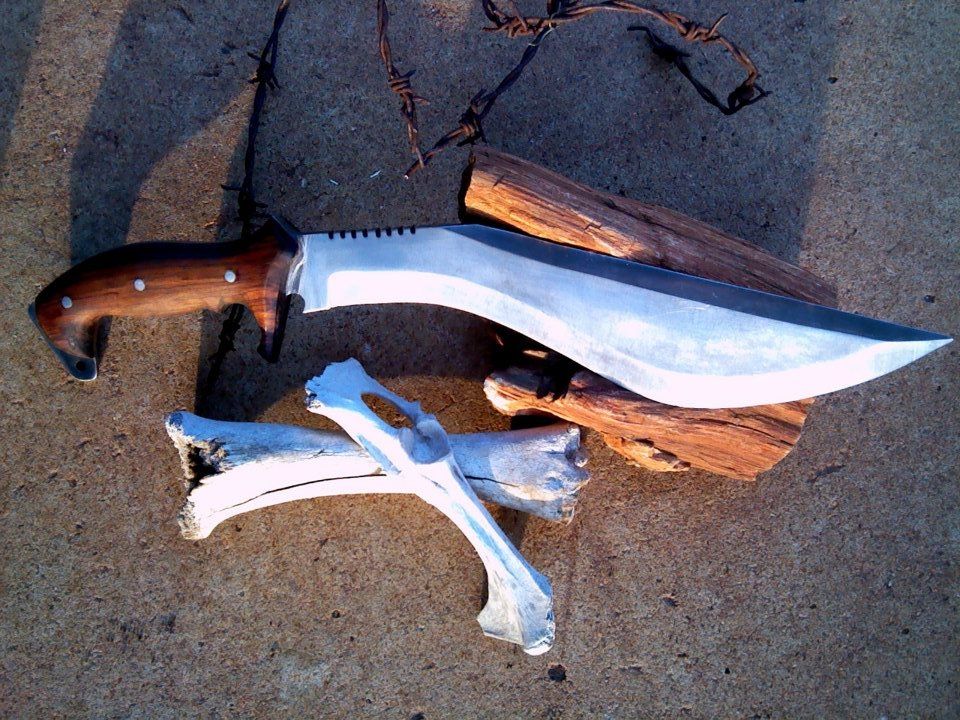

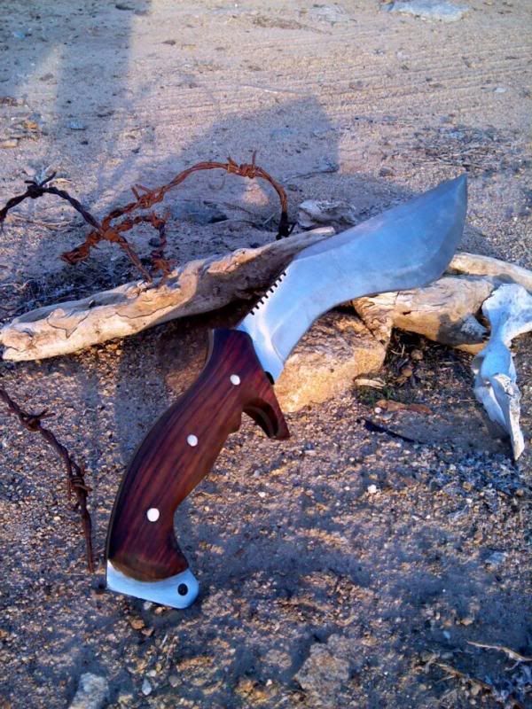

In the first picture I posted you can see the streaky blood looking patina. All these photos were taken after all the abuse mentioned, it should be kept in mind. The knife does not come with sick scratches on the blade by default. You have to put those on yourself.
