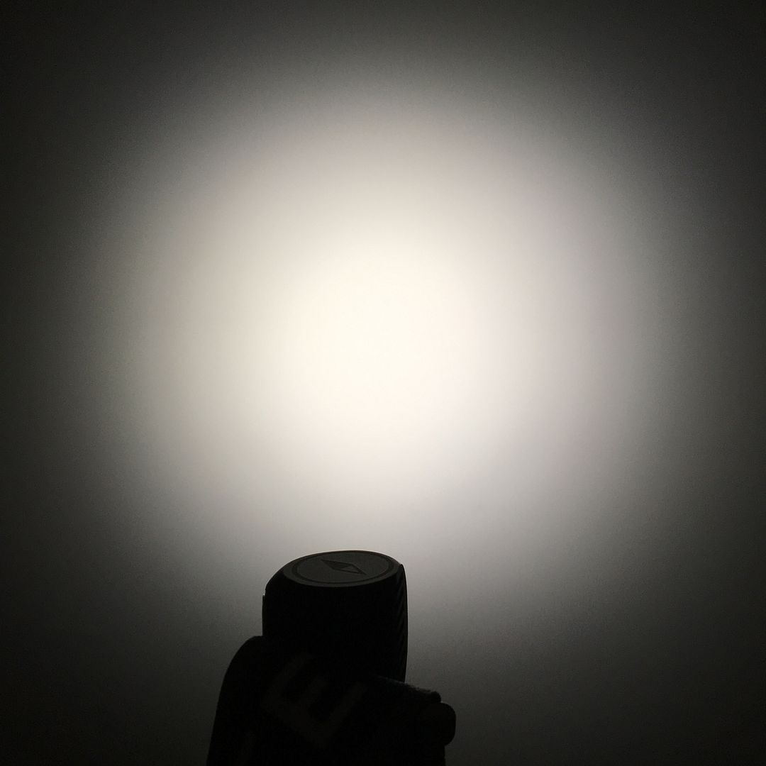

So how do these claims hold up to actual field testing? The headlamp was designed for running but also used it for camping. First lets take a look at the headlamp. These are in CRI. It is so small and UL.

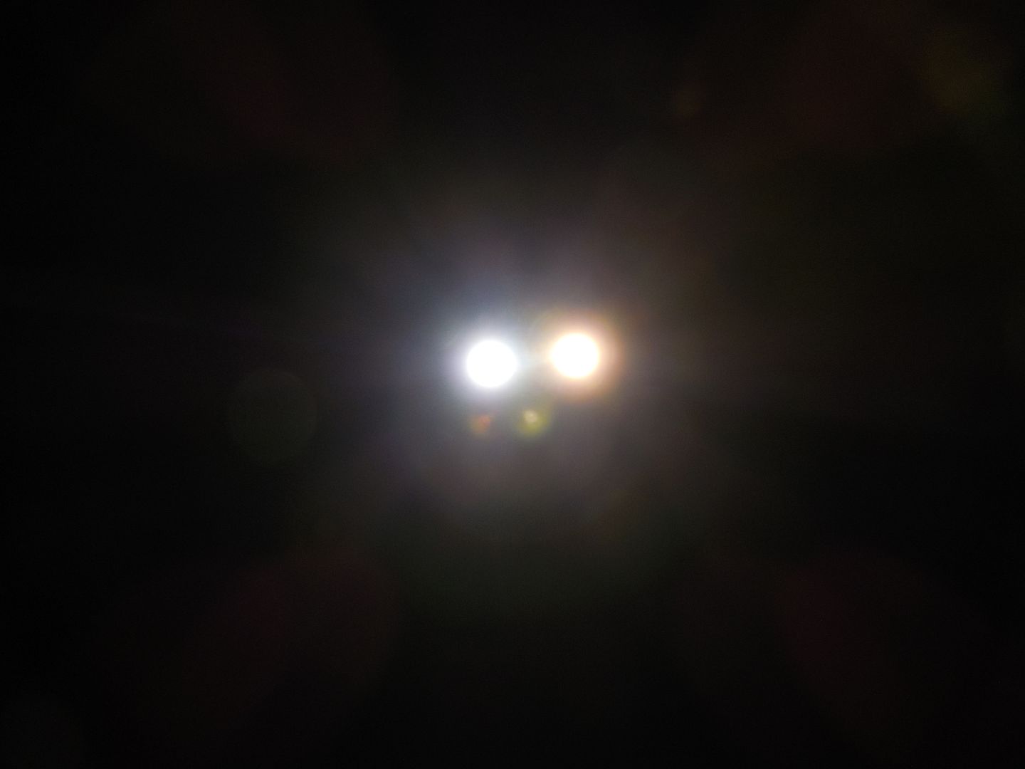

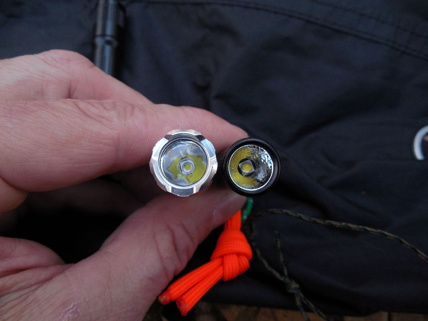

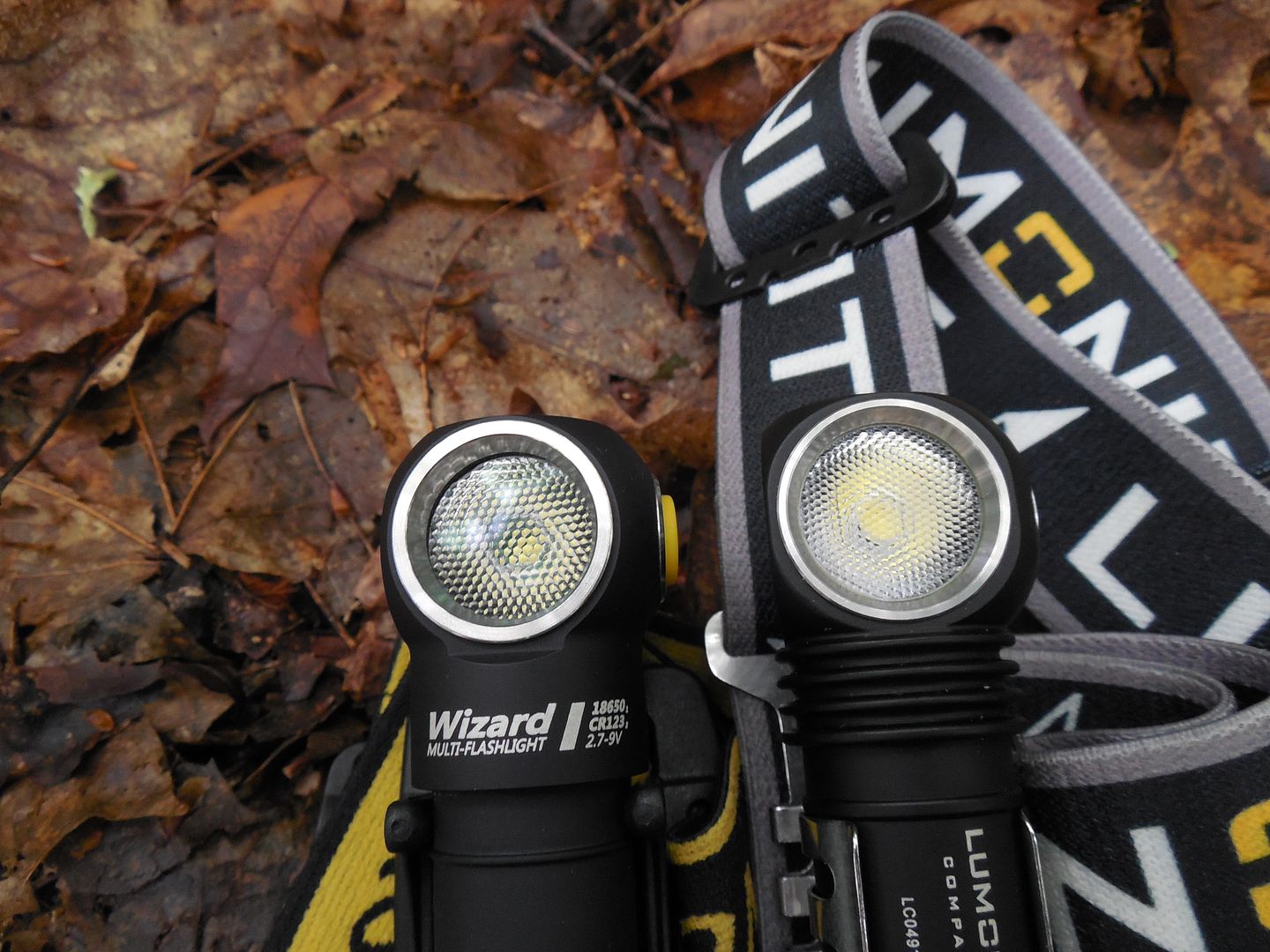

The reflector offered a good mix of throw and flood for running the trails and streets in my area.

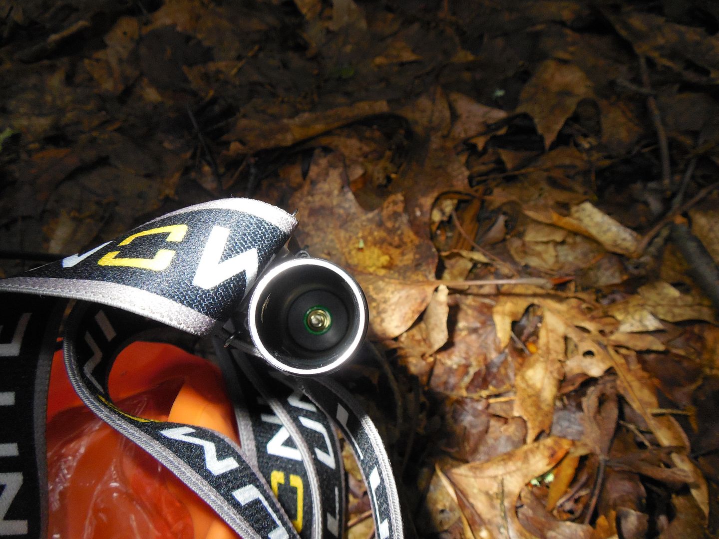

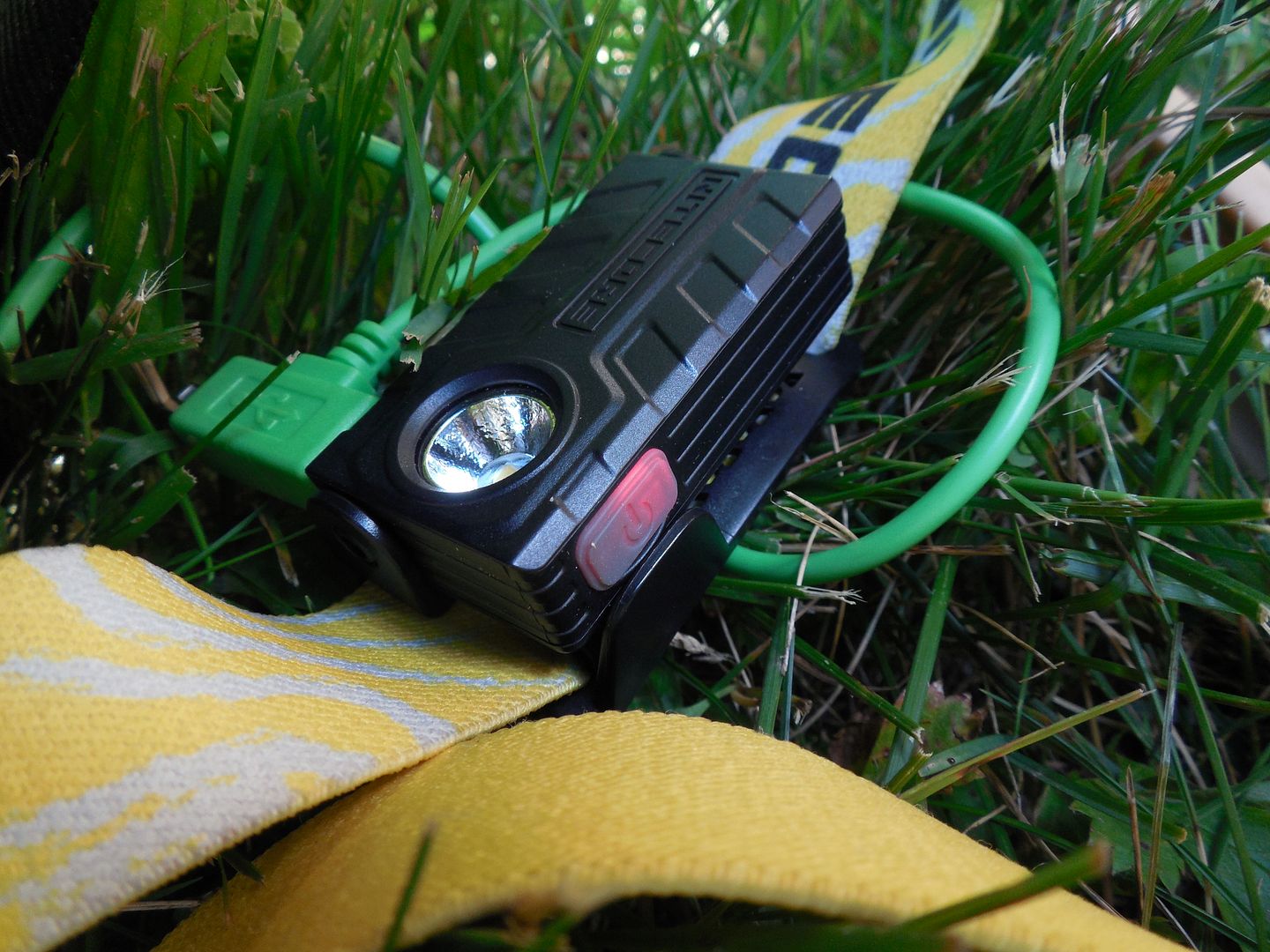

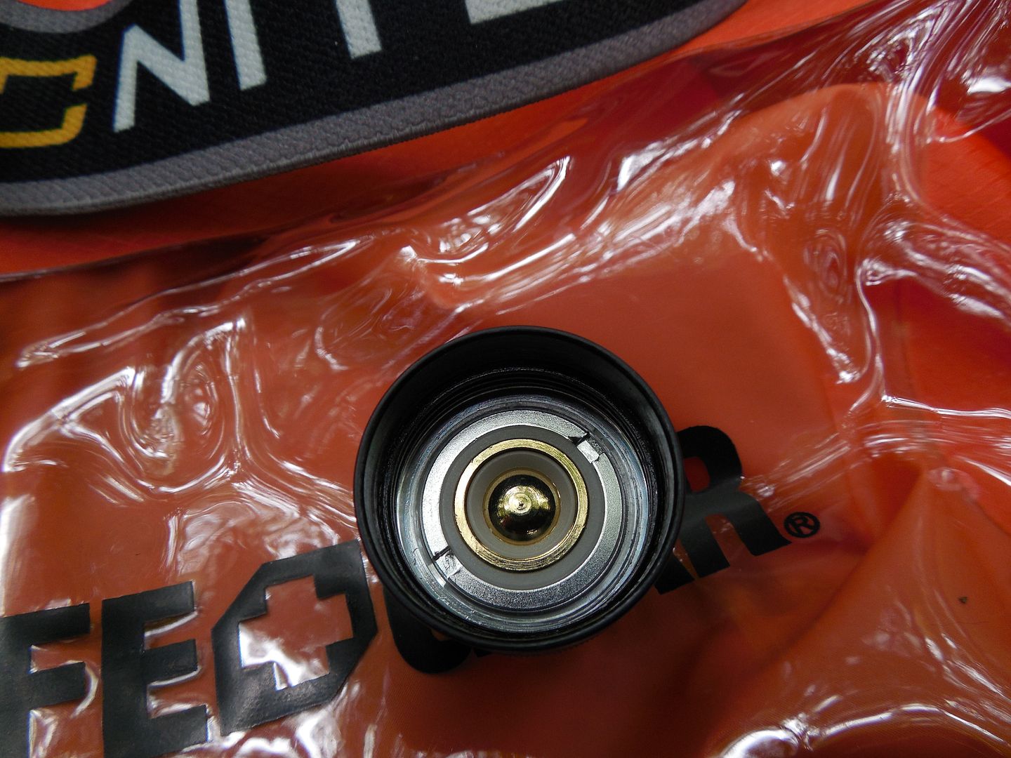

The Nichia 219B LED looks centered with no obvious defects in the reflector or blemishes behind the window. For those who like the Nichia 219B the tint does not disappoint or at least I wasn't disappointed in the way it showed the true colors of bacon but that's coming up.

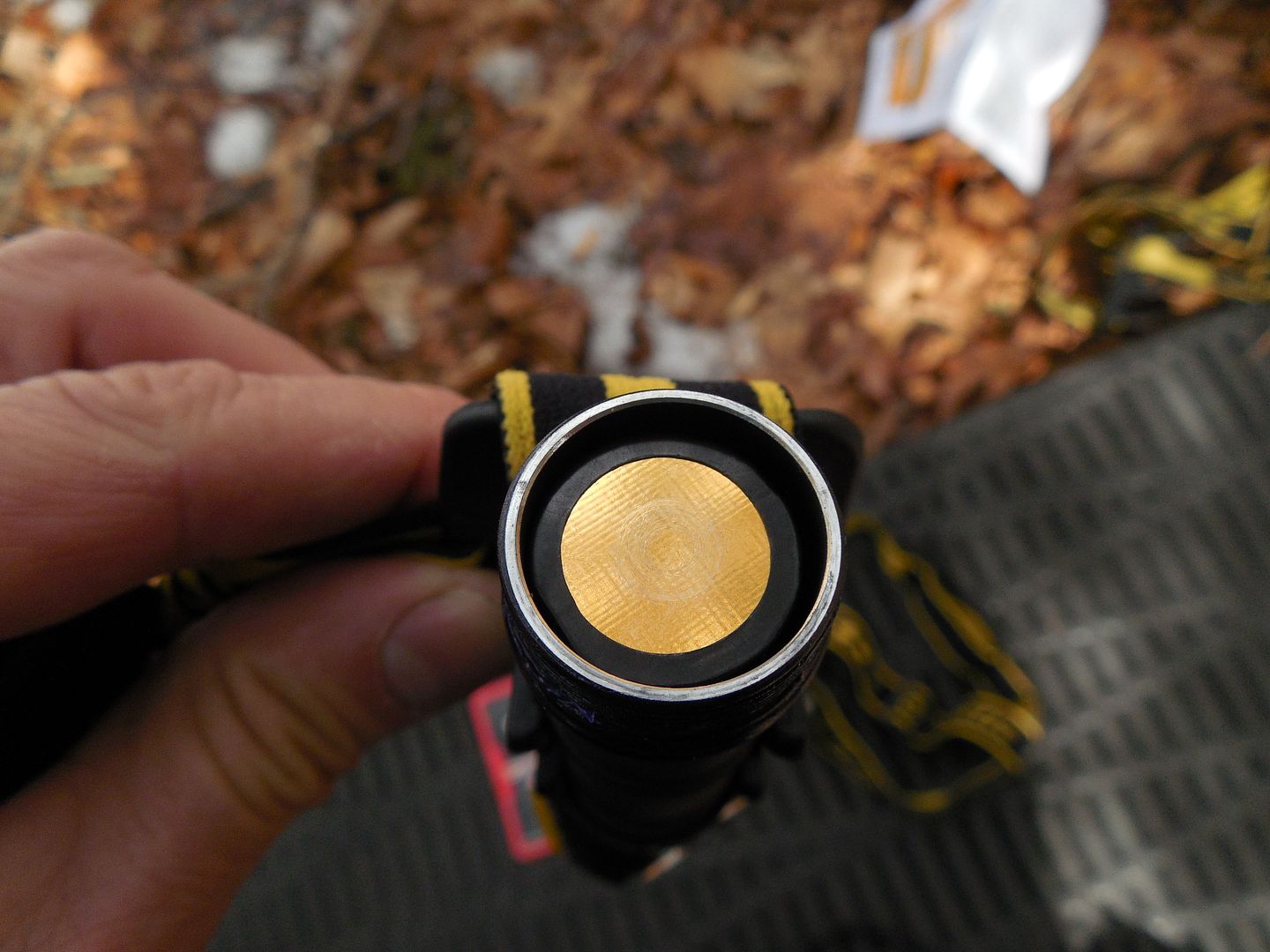

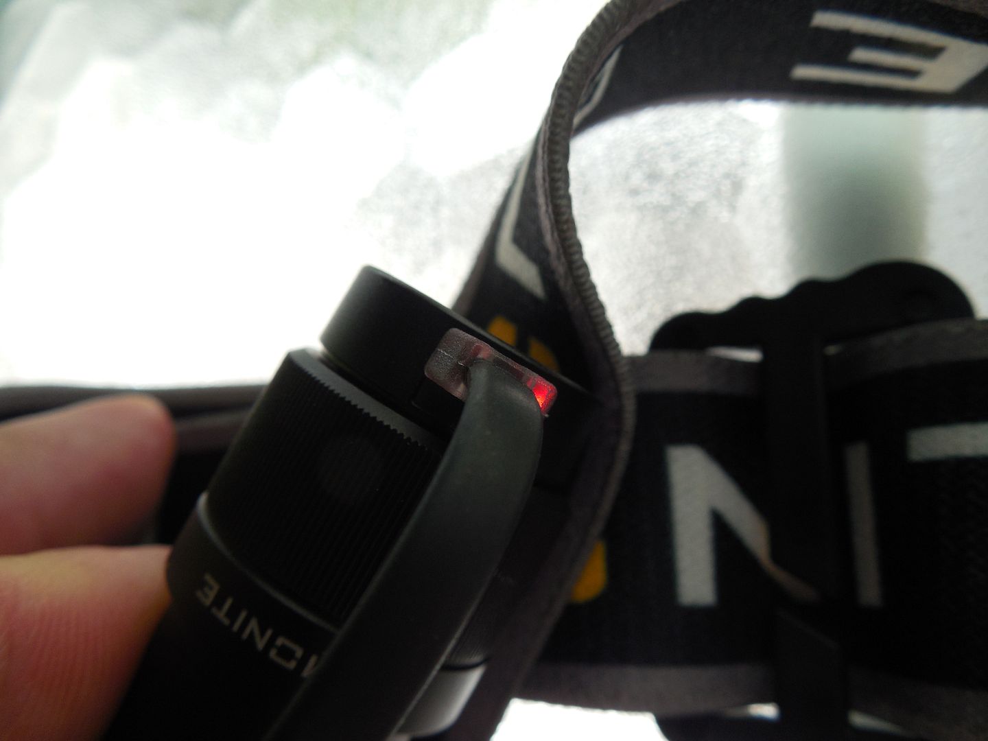

The back when attached to the headband. Hope I did it right.

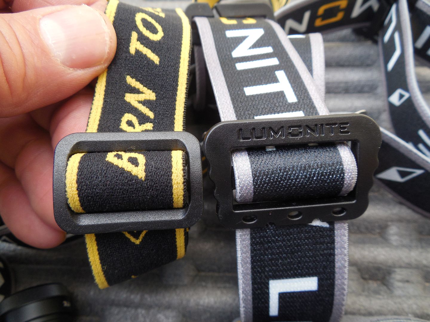

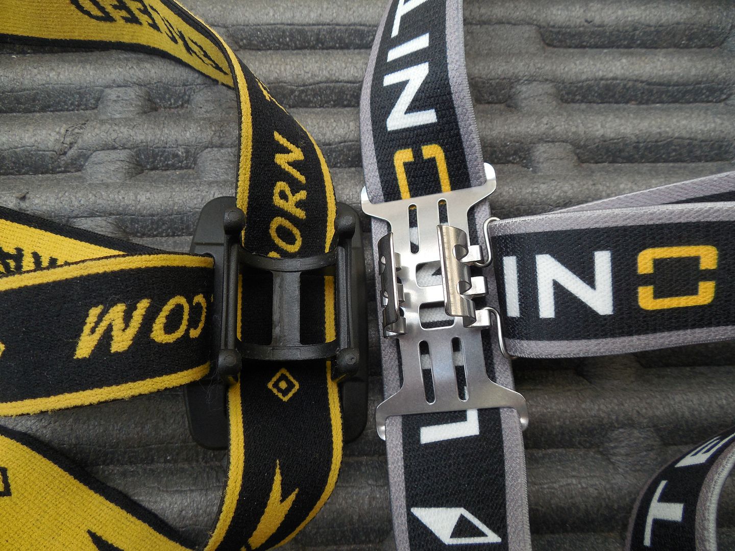

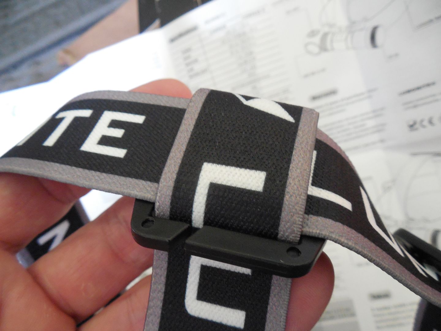

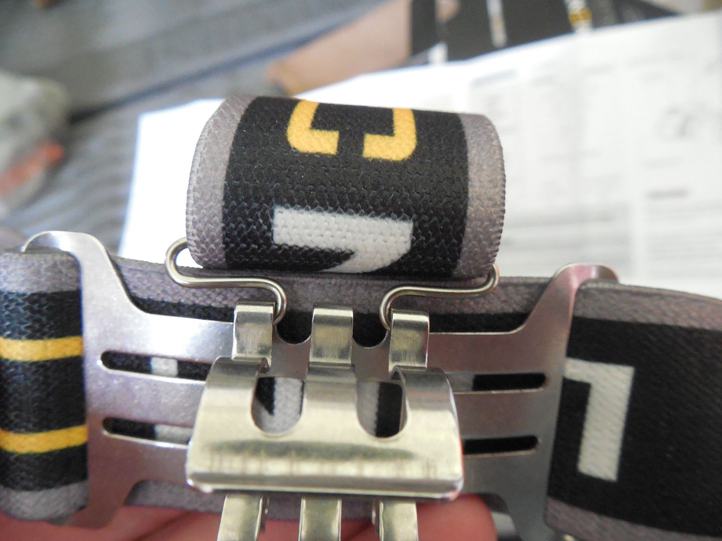

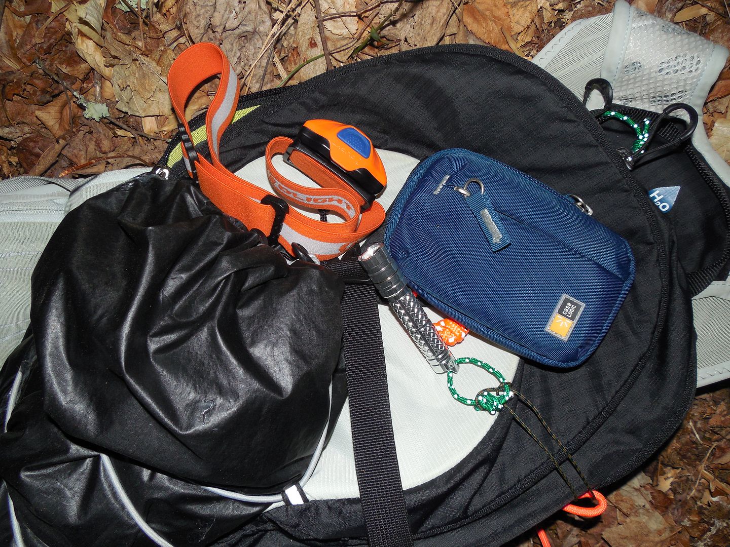

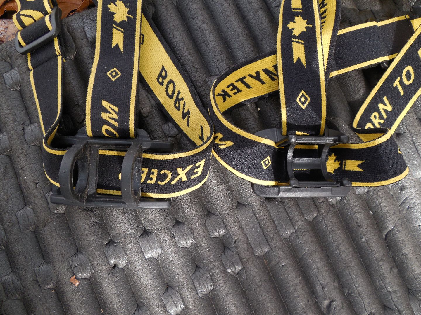

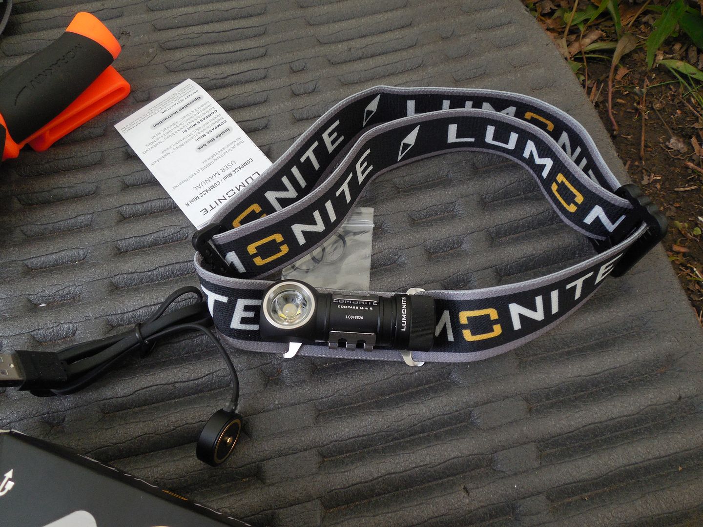

Speaking of headbands this one is wide and comfortable. It's also big enough to fit my block head with more than enough extra room for adjustment. This is one of my biggest concerns for a headlamp. A good headband can make or brake it in terms of field effectiveness. However comfort can be subjective. For me this is a home run. So comfortable I feel asleep wearing it during one outing.

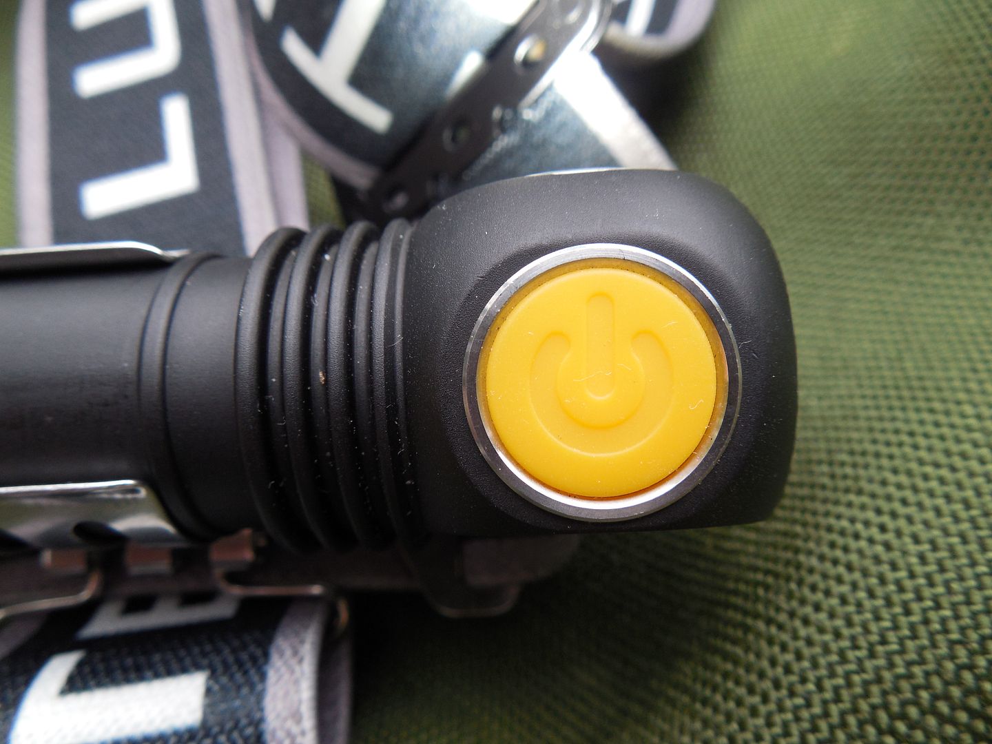

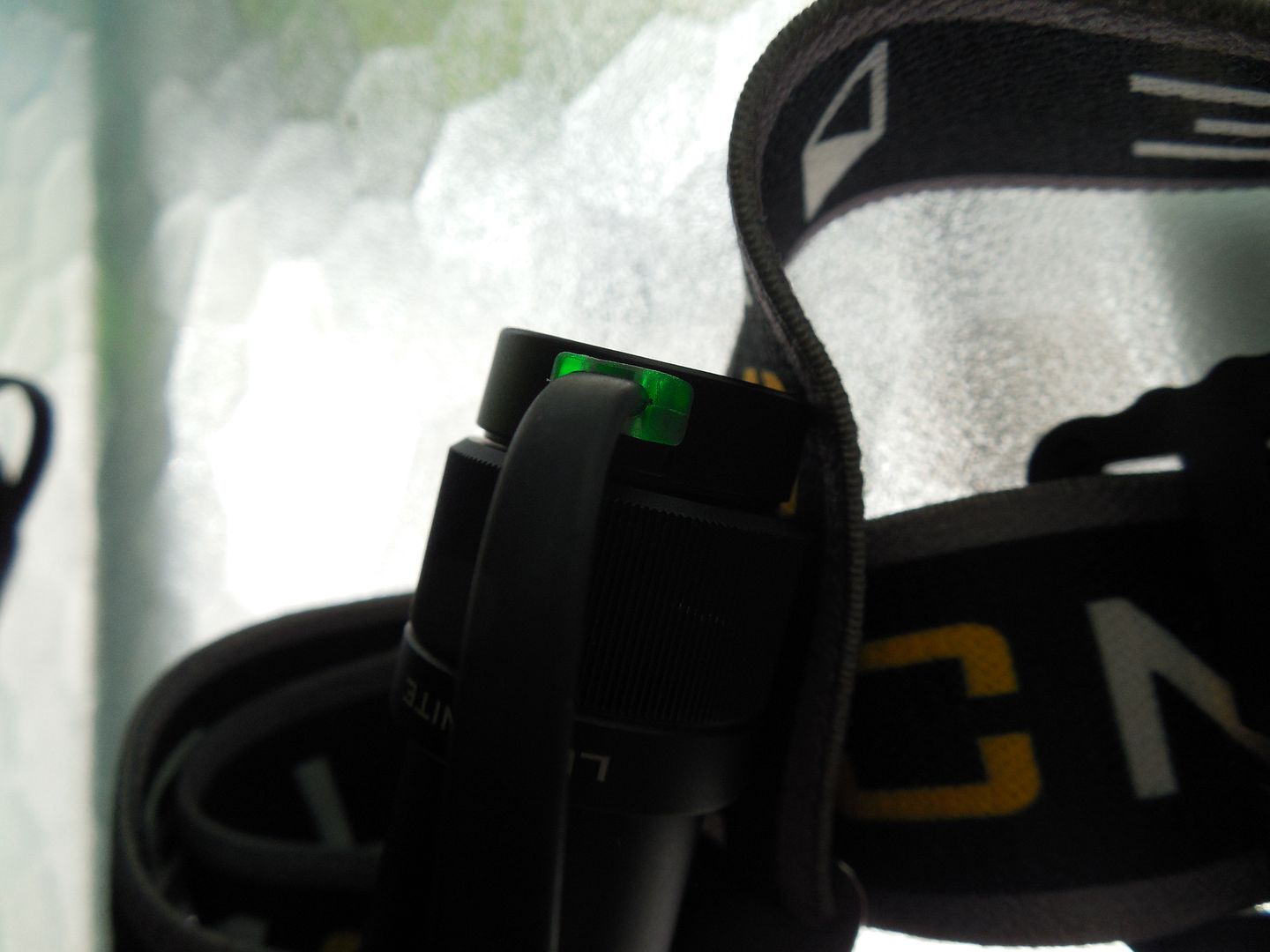

The harness has a physical lockout feature which proved 100% effective in my testing. Lock out is an important feature for me as often toss lights into a pack when on the fly.
The beam angle adjustment is done via two hinges and two friction points if I am using the right words to describe them. It took me two hands to adjust the beam angle when on the move as there isn't much headlamp mass to counteract the force needed for the adjustment. It doesn't slip during running.

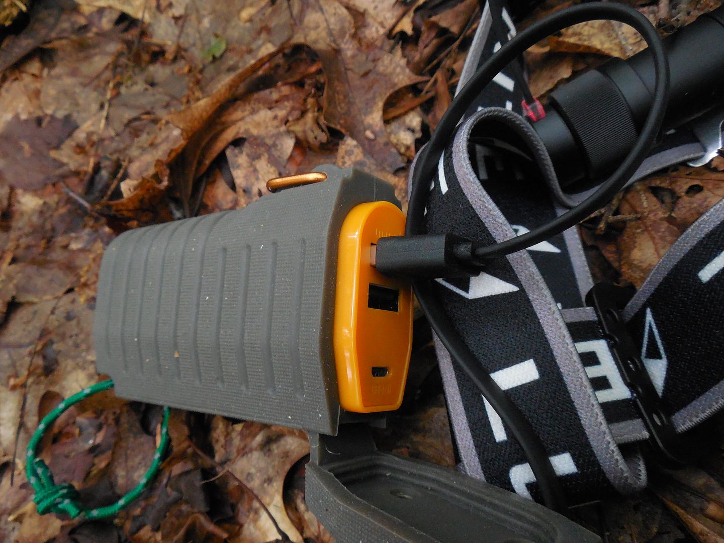

The headlamp's Micro USB port cover.
and port.

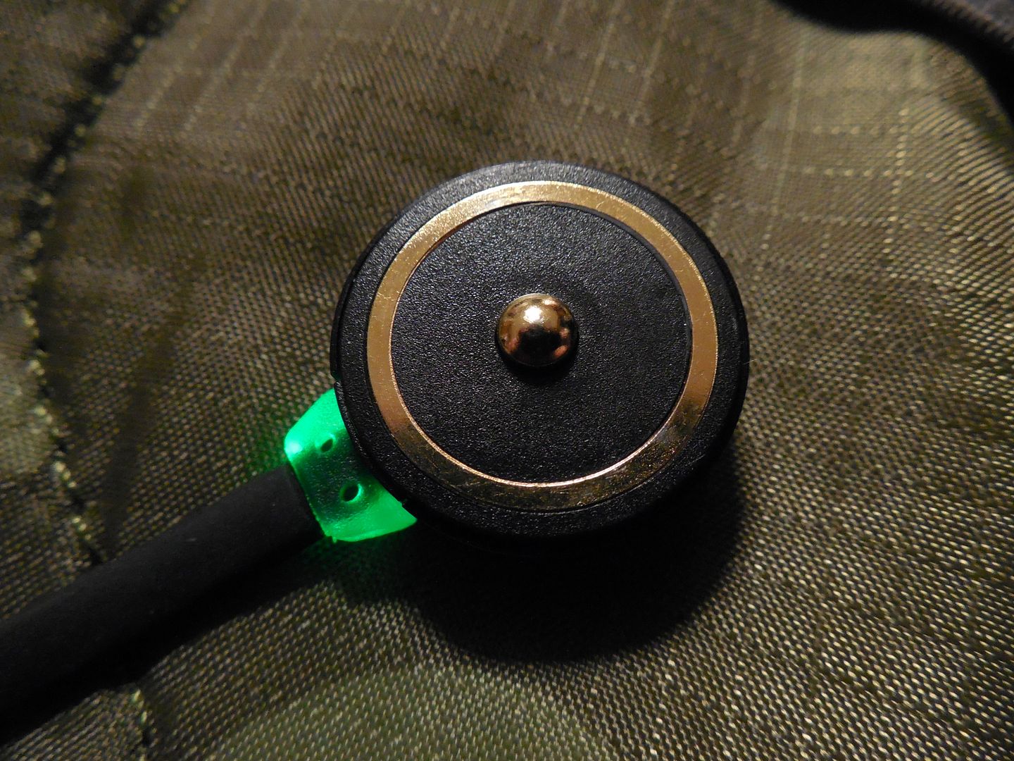

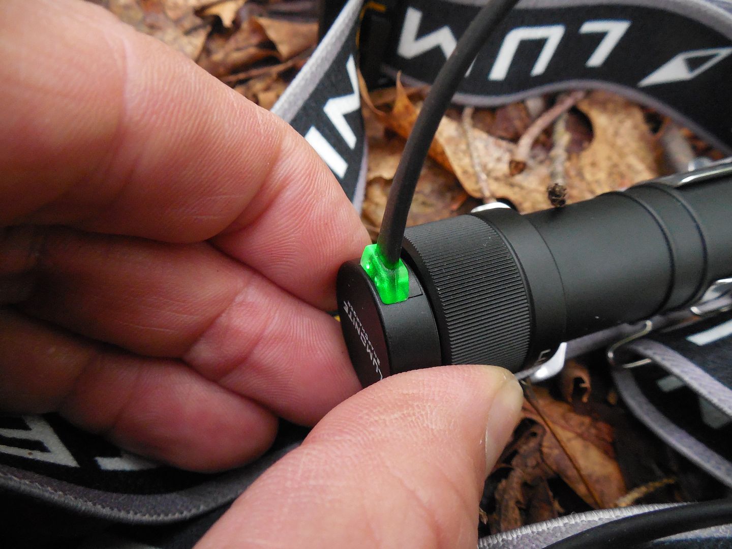

The switch turns red when charging.
Yes it will charge from a powerbank. In these cases the Nitecore F1.
Charging and running.
Just charging.
The light will operate when plugged in. Seems to operate at a max of medium if out of power running off a powerbank however does it charge and run at the same time? The answer is yes but appears to do it if running on low. I think it might be charging on medium as well but if so it would be at such a slow rate as to be not practical. On low it seemed to charge just fine.
Running on low and simultaneously charging test. Might seem like a strange test for a running headlamp but if pressed into other service it's a good feature. On a side note the USB cord hangs down the user's face if employed as headlamp when running off a powerbank but makes for a good handheld light or hands free if you don't mind the cable. This is more of an exceptional extra use type thing IMHO.
When plugged into a power bank running on low the UI button illuminates red however it's actually charging at a reasonable rate unlike my testing showed for medium.
Once charged it turns green just like having it plugged into a standard wall USB power source with the headlamp off.
After done the green light will turn off then fade. Many powerbanks terminate the charge once the device's battery is full so the light will stay on.
Bottom line. You can use it on low and it will run and charge at the same time. On medium not really.

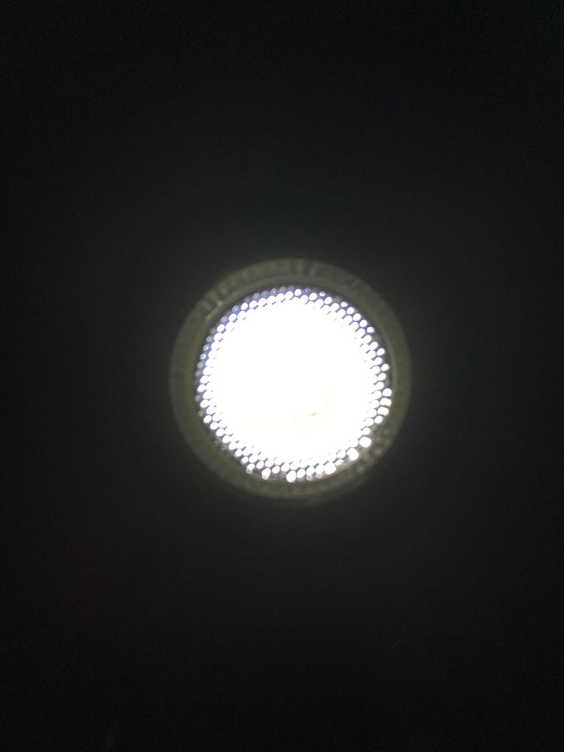

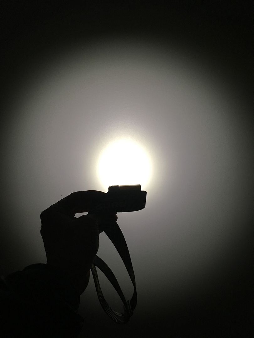

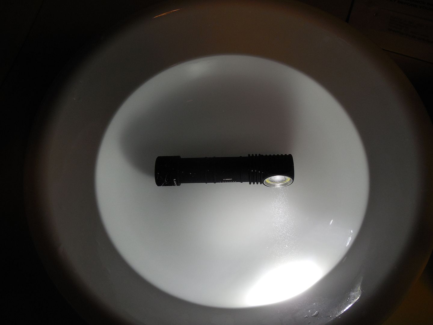

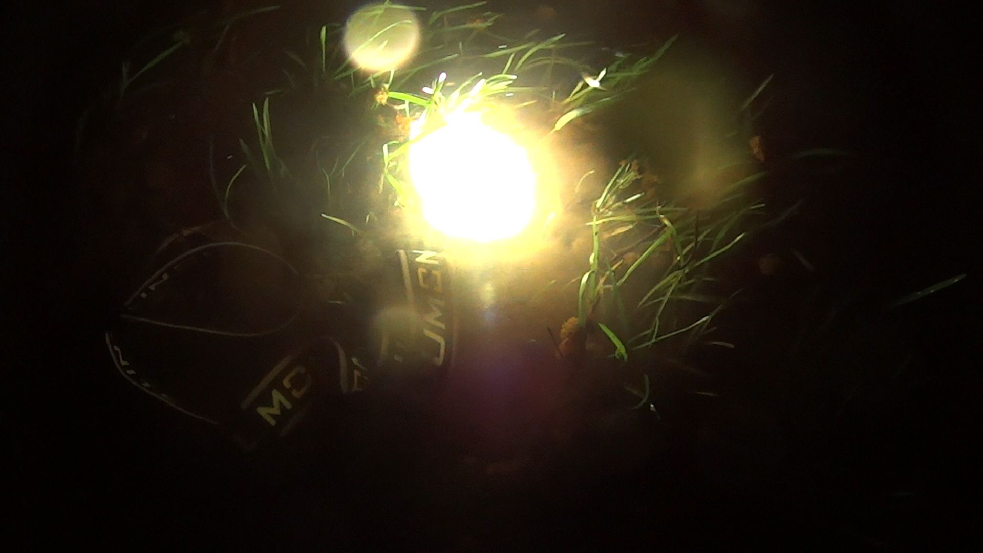

So is there PMW? I did the shake and cellphone camera test using two devises. Also am sensitive to PWM so often see it when others can't.
On low there is no sign of PWM.
On medium there is something but not sure if it is actually PWM. Looks very similar to something I seen on my SC5w and didn't think it was actually PWM. Also could not detect it with the shake test. So can't say for sure but the cameras are picking up something. Just not convinced in my experience it is actually PWM. Maybe those more familiar with this technical aspect could key in.

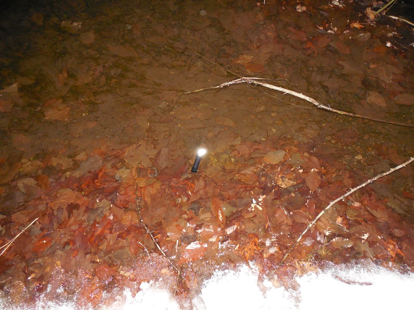

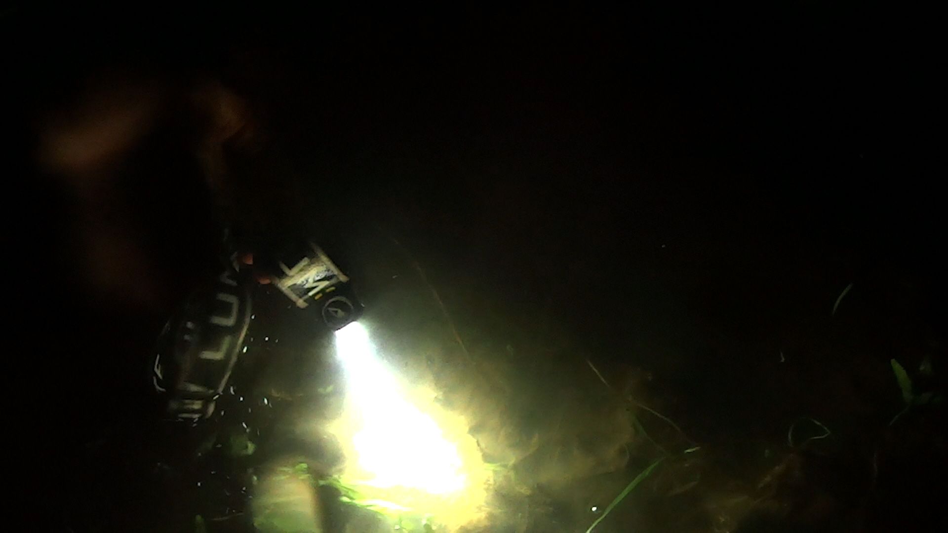

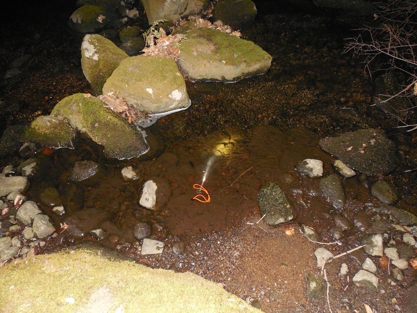

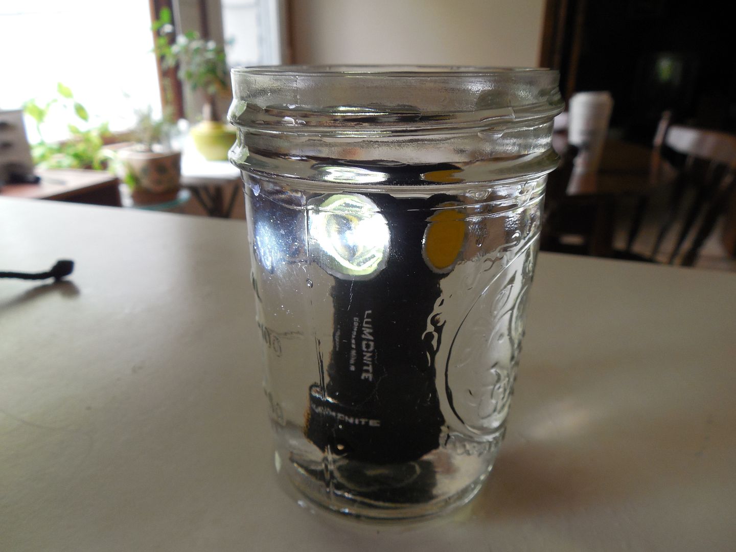

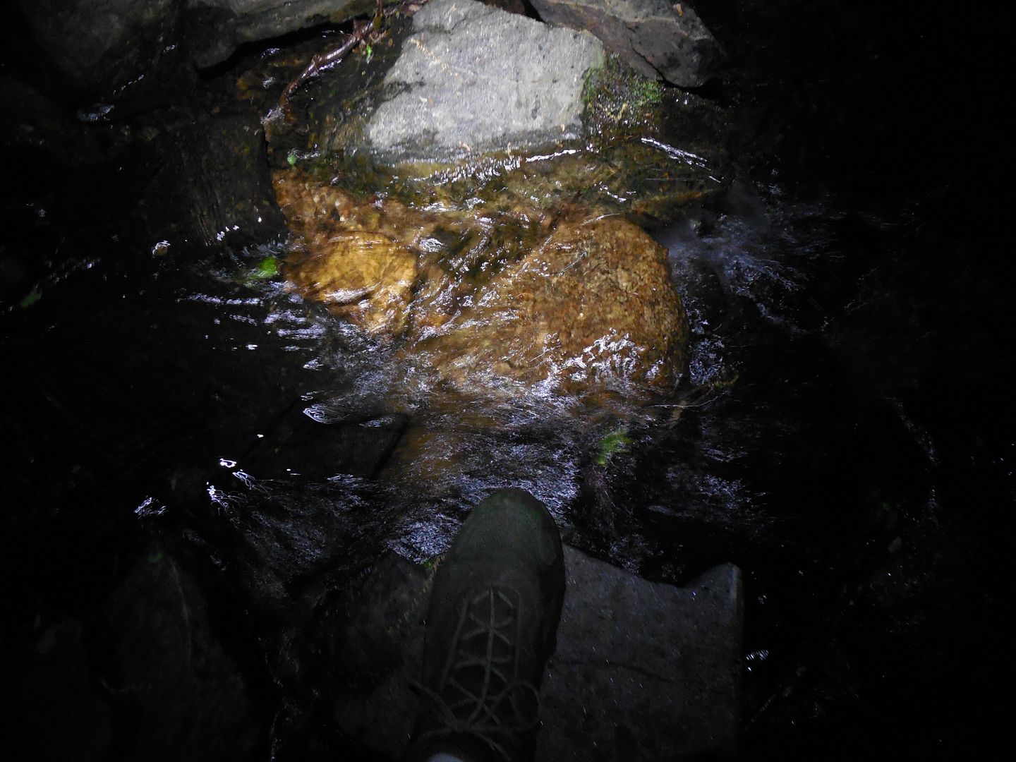

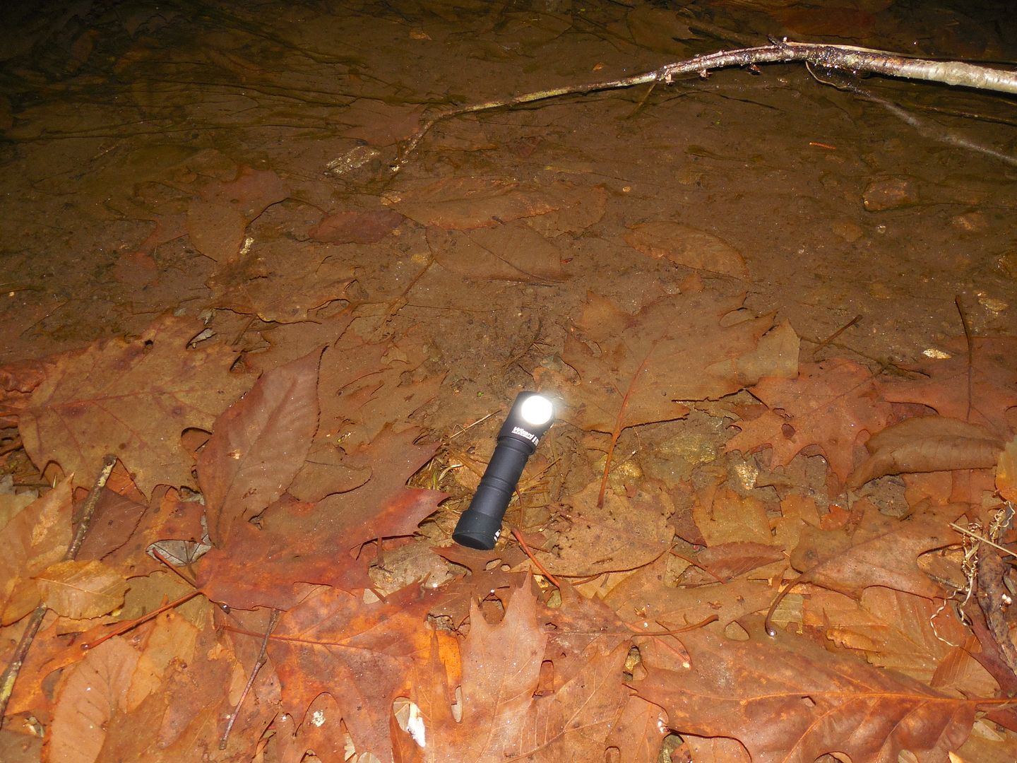

Water resistance testing.
The NU20 is IPX7 and 1.5m drop ratied so decided to test both in actual field use conditions. First I would run 8 miles in the cold rain then drop the headlamp lamp multiple times in the roadside puddles. Jogged on both black top and dirt roads. Due to conditions only took the cellphone as it has a protective case.
One of 3 or so puddles tested for both drop and water intrusion.
Then left it out over night on the porch in the cold rain.

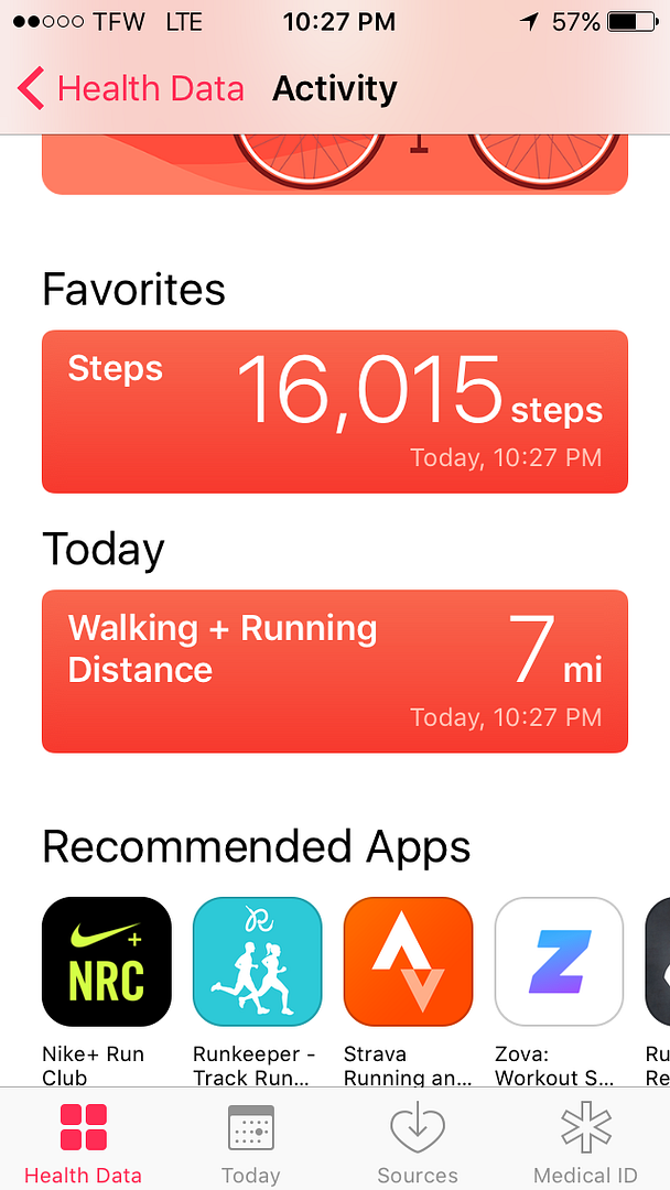

So what does running 8 miles in ice rain and slush feel like? It profoundly sucked. I liked nothing about it beyond the fact the NU20 survived the drops and water. I wasn't surprised the drops didn't harm it given the very low mass but was surprised no water got in. Sure it is IXP7 rated but still I am happy.

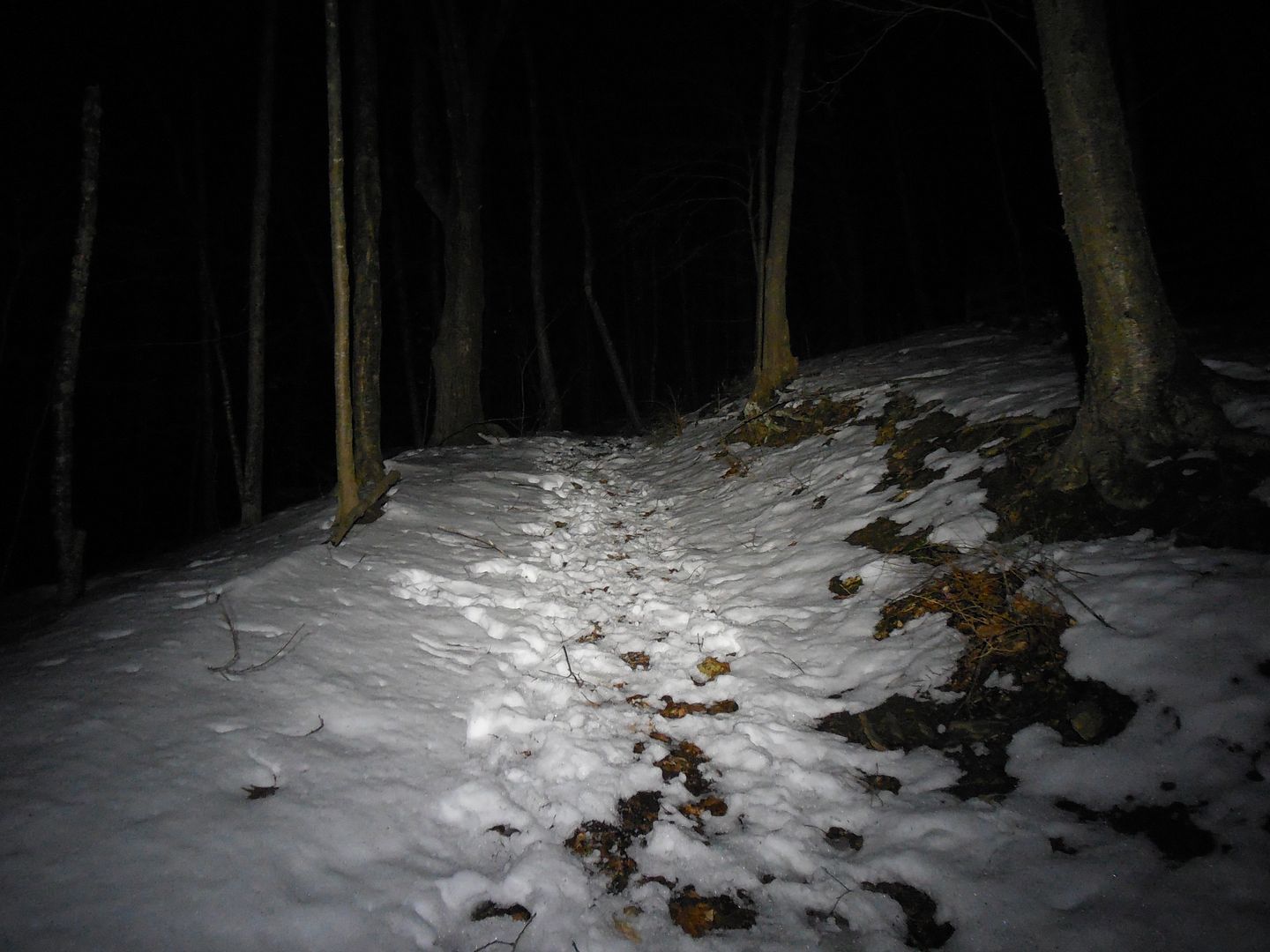

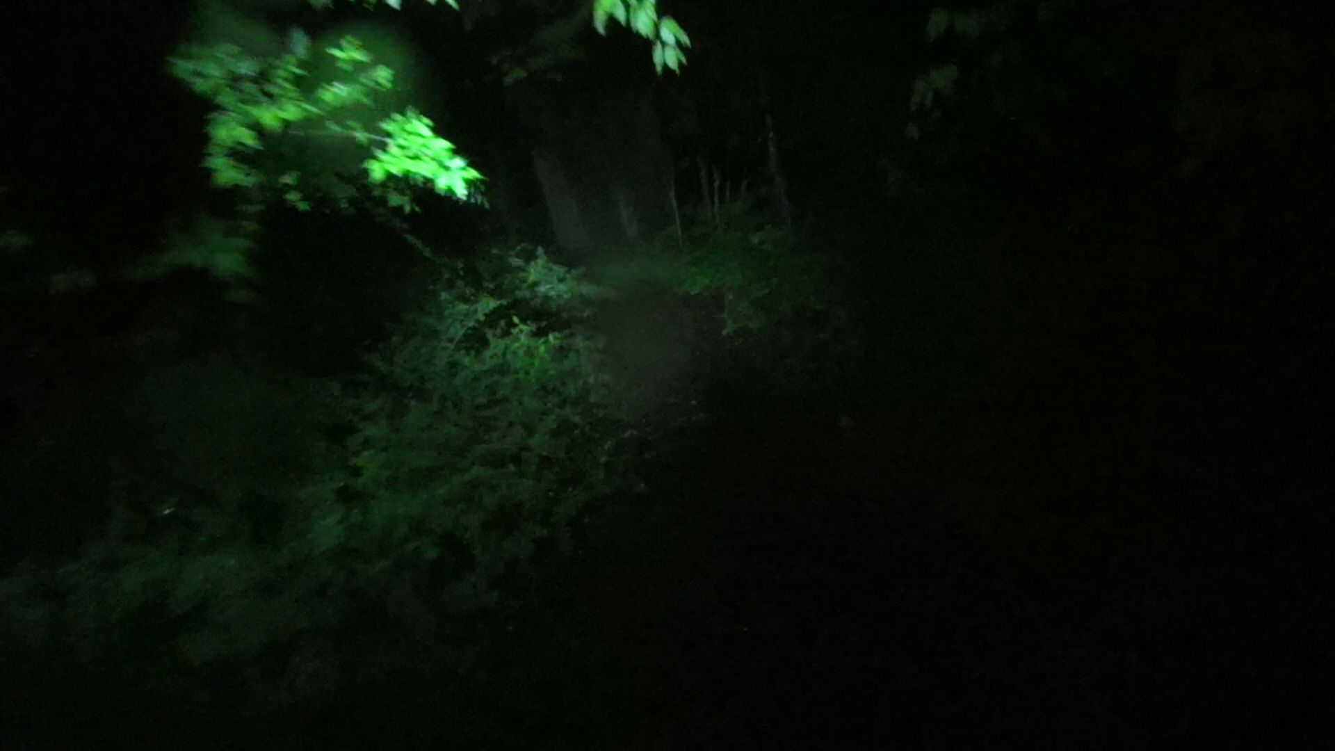

Up next was 5 miles through the hills trail running with mircospikes. Temps in the teens. Way better than 8 miles through the ice rain just above freezing but the terrain was harder. As this is a running headlamp most of the field testing was done on the fly but also took it camping Still it is a running headlamp so kinda had to run.

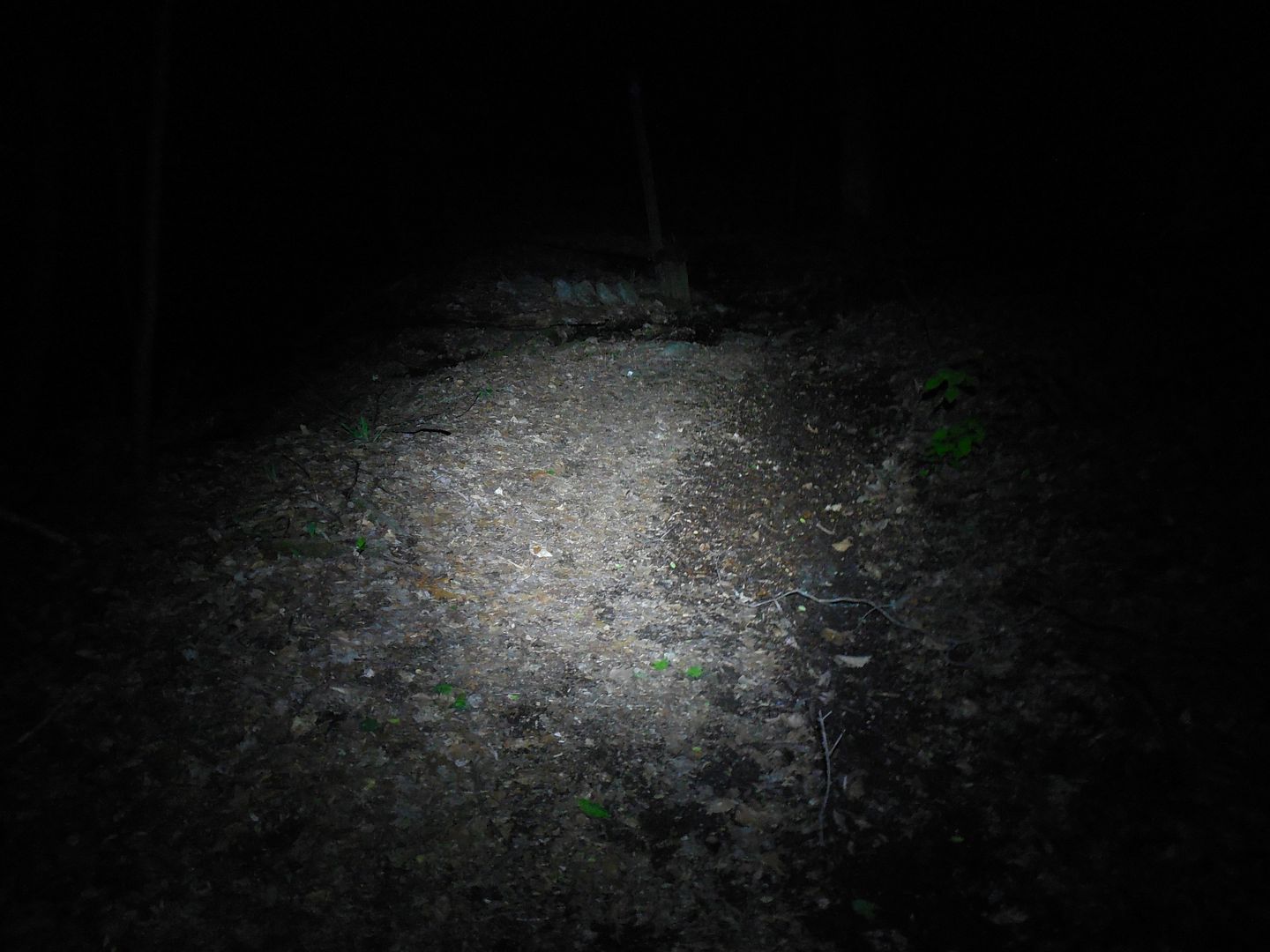

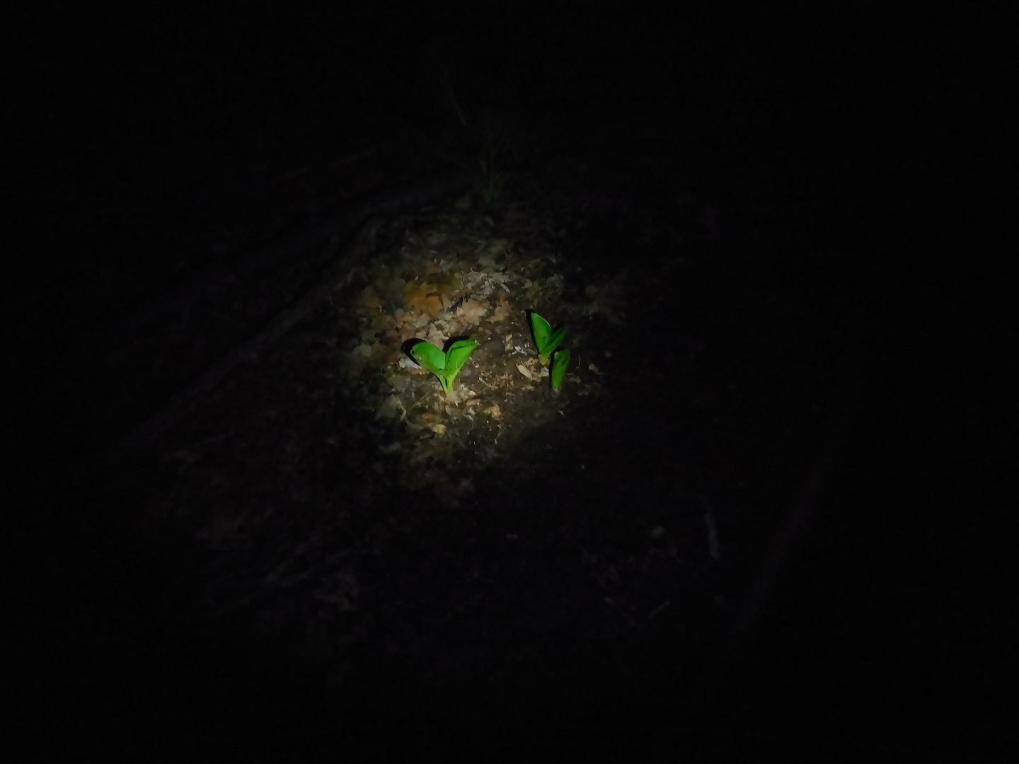

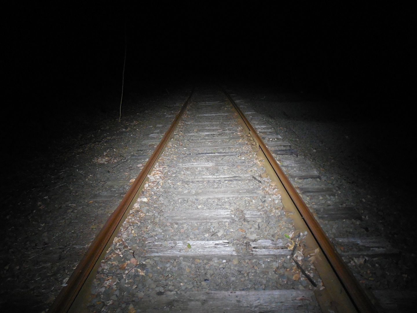

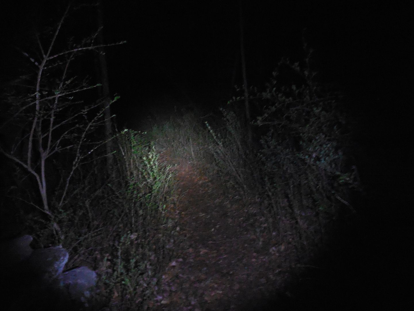

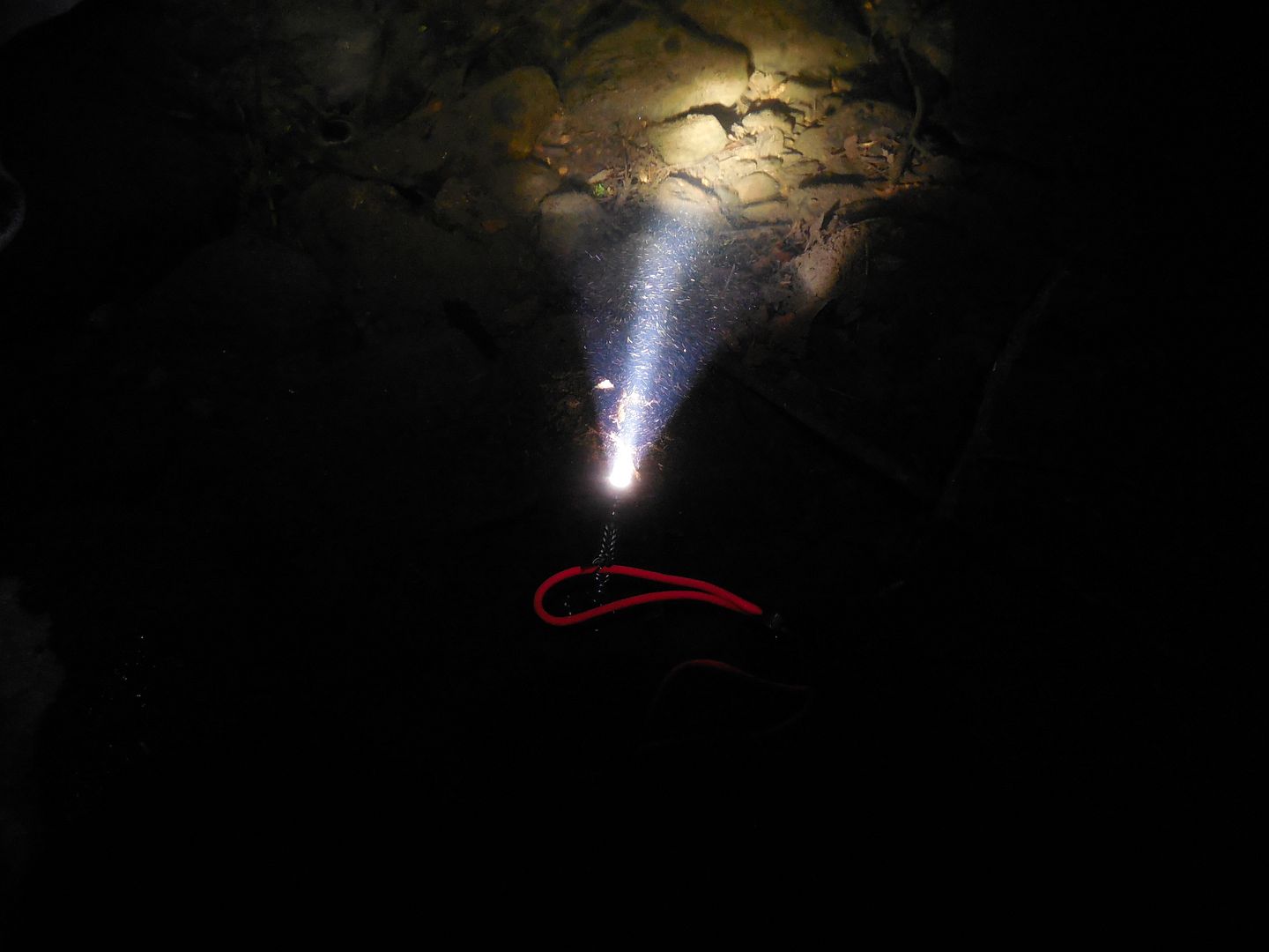

The low 1 lumen mode.

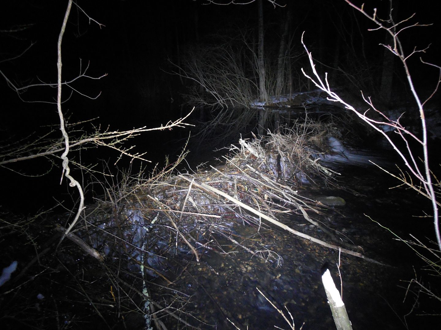

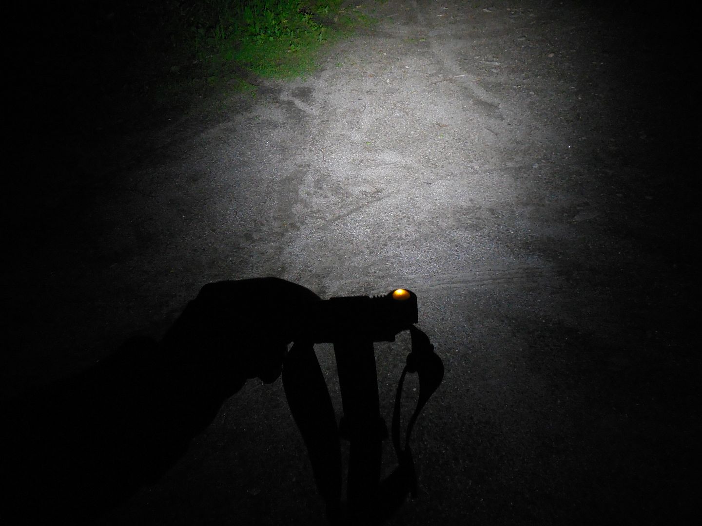

Plenty to walk around in and root through the pack back but wouldn't run on slippery ground with 1 lumen.

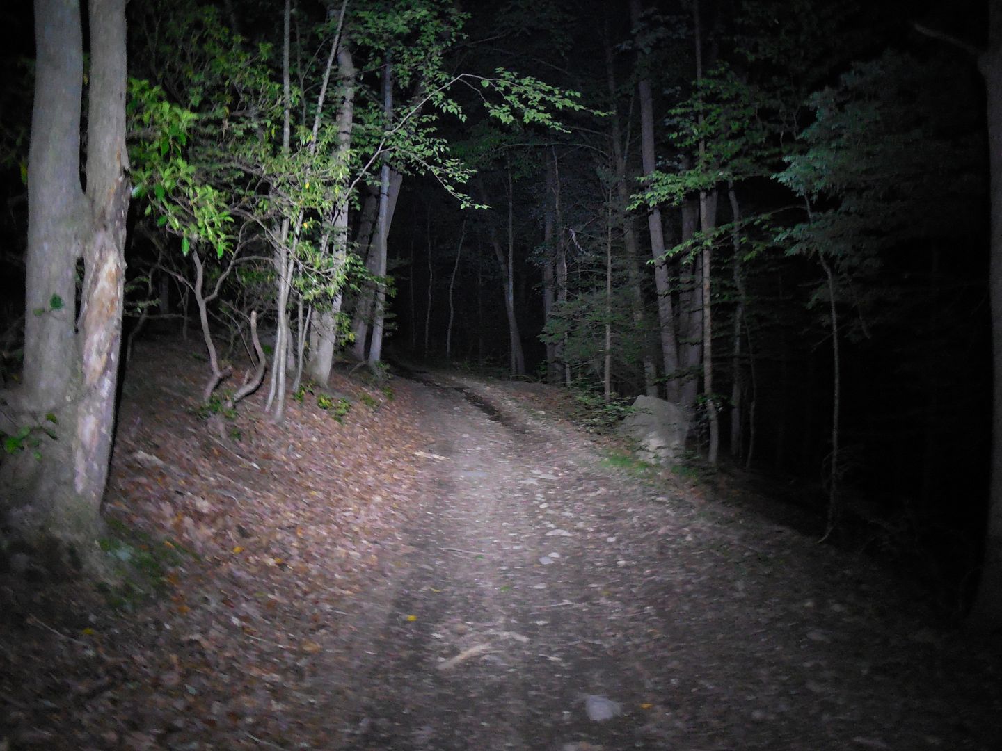

Medium.
High.
High projected a bit further.
Turbo.

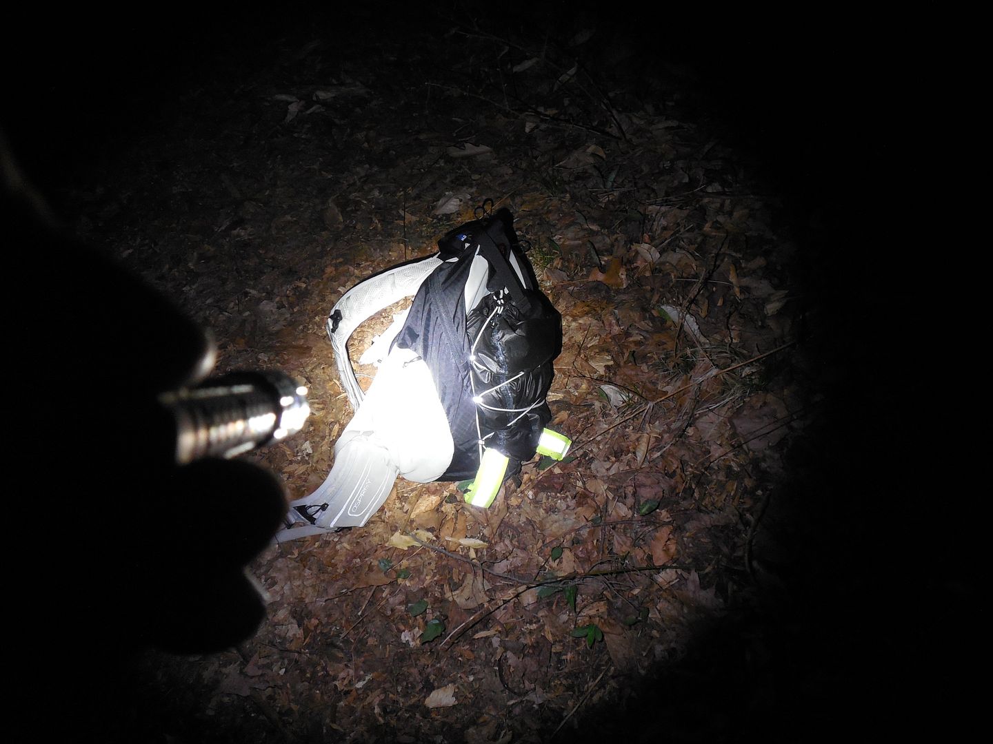

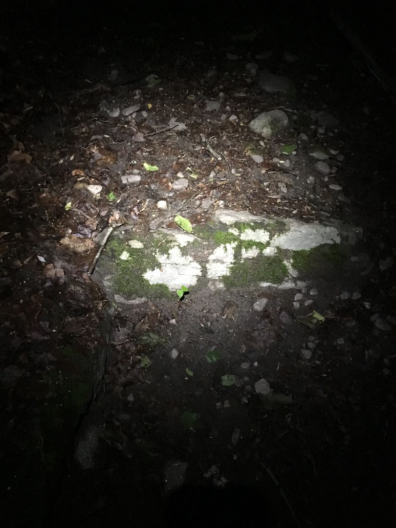

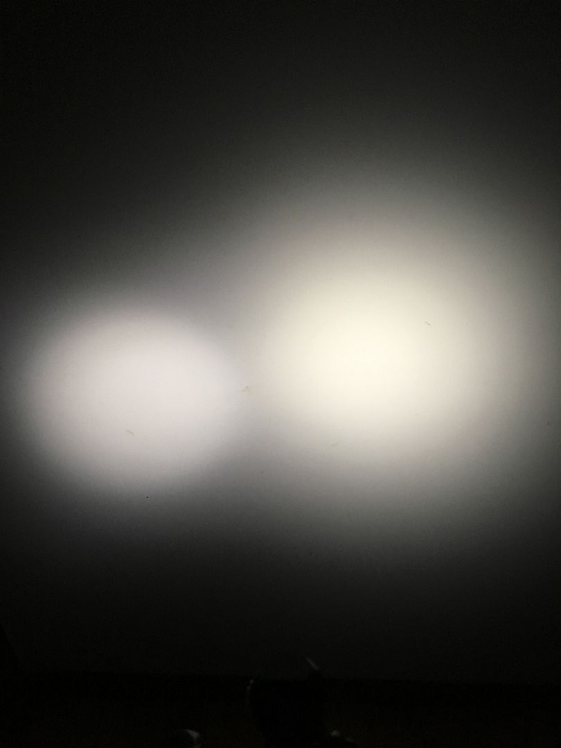

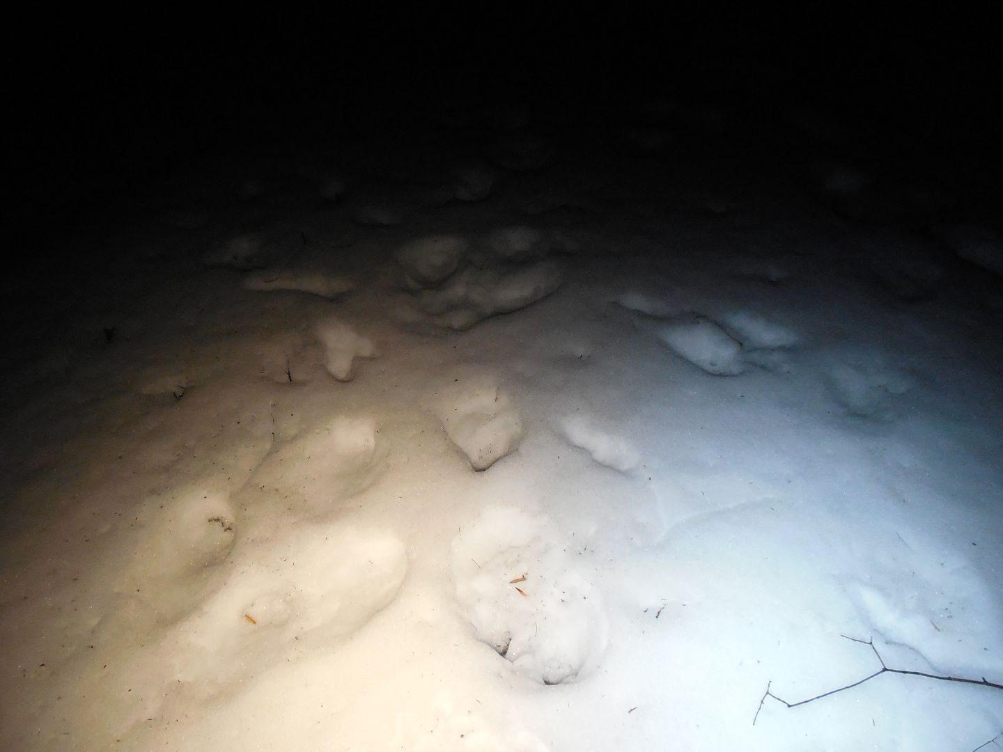

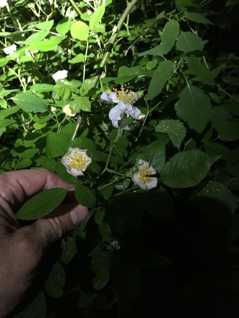

Nichia 219B field application. Is it worth the reduced output?
Medium. Trail marker colors look true.
Medium. PSK high visibility paracord looked good.
The following is compelling proof of CRI's value. Look at how the bacon appears natural in the medium mode.
Fearing this might be just the camera I used another camera and verified what my eyes and the other camera were saying.
But how does cooked bacon appear under the illumination of a Nichia 219B?
Looks good with second camera as well.
and port.
Pros and cons.
Pros.
1. Two LED options.
2. Fast charge times.
3. Long regulated medium mode.

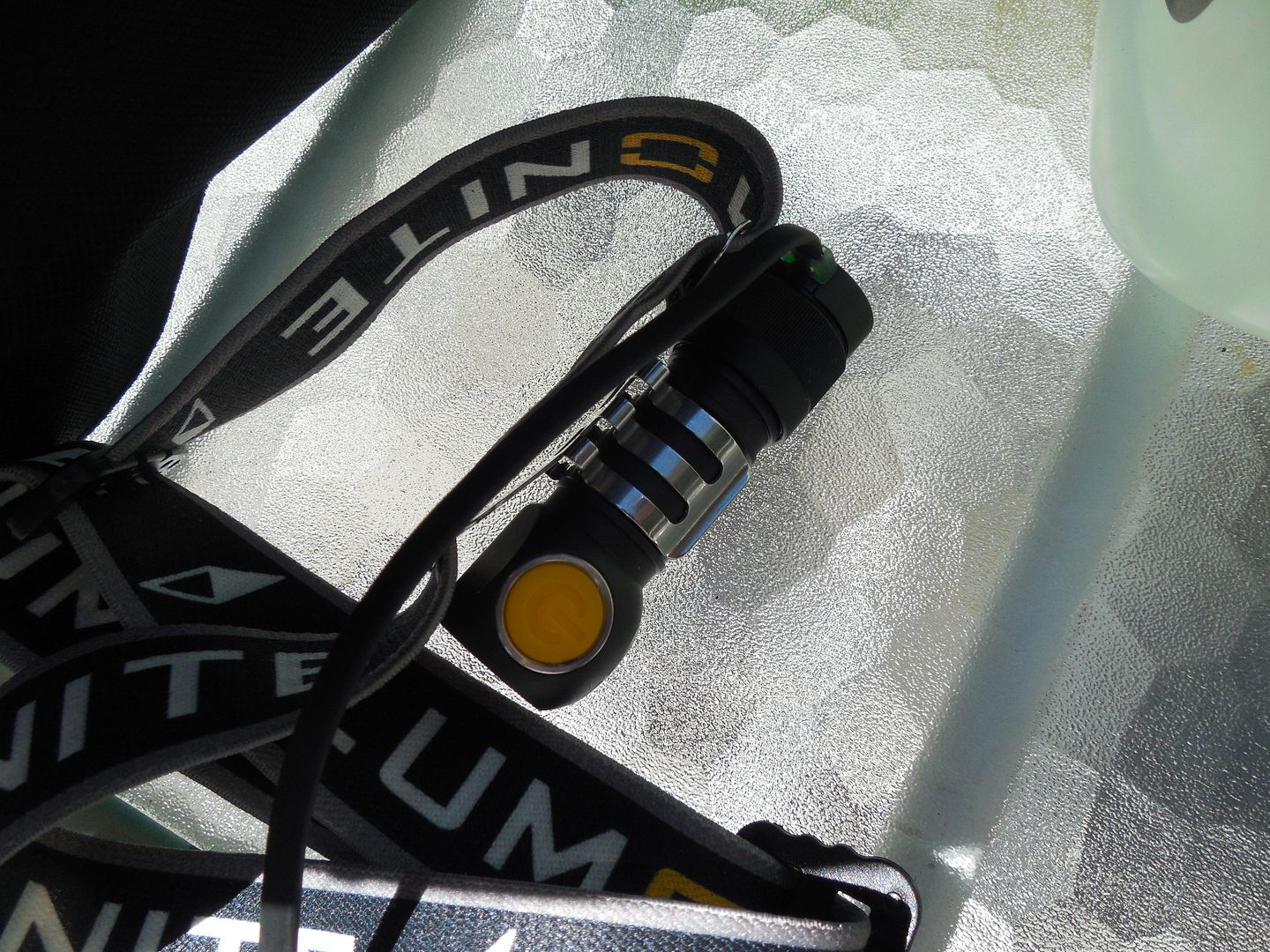

4. Very small and UL.
5. Comfortable.
6. Built in battery.
7. Nice beam for running and even camp work.
8. Very bright and nice low.
9. Will run when plugged into a powerbank. Will charge and run on low mode.
10 Headlamp angle doesn't slip when running. It stays put.
Cons.
1. Built in power source might be problematic as can't immediately change the battery.
2. The UL design means it is made out of plastic. Is what it is.
3. Is there PWM on that medium mode? Not sure. Don't think it is true PWM but something is going on.
4. The red flashing lights do work to indicate power to some degree but given their limitations can't be exact.
5. USB port position makes it difficult to wear and run off a powerbank at the same time.
6. Often takes two hands to adjust headlamp.
7. Yes it is a running headlamp but would love if they made a UL camping version with a 10 lumen mode. This isn't really a con rather a wish.
Conclusion.
I like it.
Here is a video.

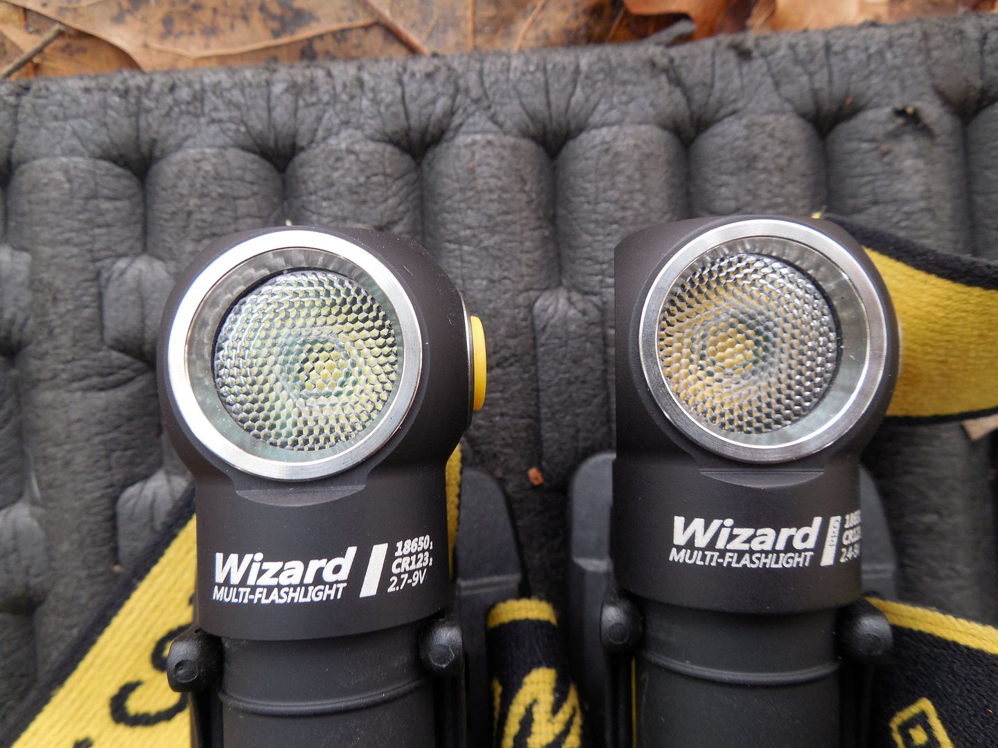

Armytek Wizard V3 Headlamp with New Plastic Holder. Warm vs. White Light.
First thing. For full disclosure I am doing this review as a pretext for running miles over slushy ground to shine two different tinted lights on a beaver dam. That's about it. So if you like beavers and headlamps maybe check it out. I already own a XHP-50 Wizard in "warm" which is really neutral white. I noticed the price dropped on their standard model with XP-L. Liking variety and simplicity purchased the headlamp in "white" which is really cool white. I was happy to see it came with the new plastic harness which replaces the older silicone. I purchased an additional plastic harness for my XHP-50 and have been pleased with it.

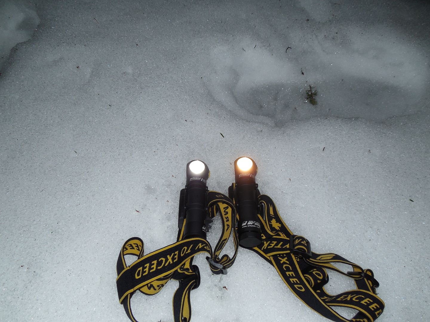

So with the illuminated beaver dam (yes you will be seeing a beaver dam lighted up with CW and NW) disclaimer and background out of the way time for the review.
The standard white/CW V3 on the left and Pro/warm V3 on right.
from the manufacture.

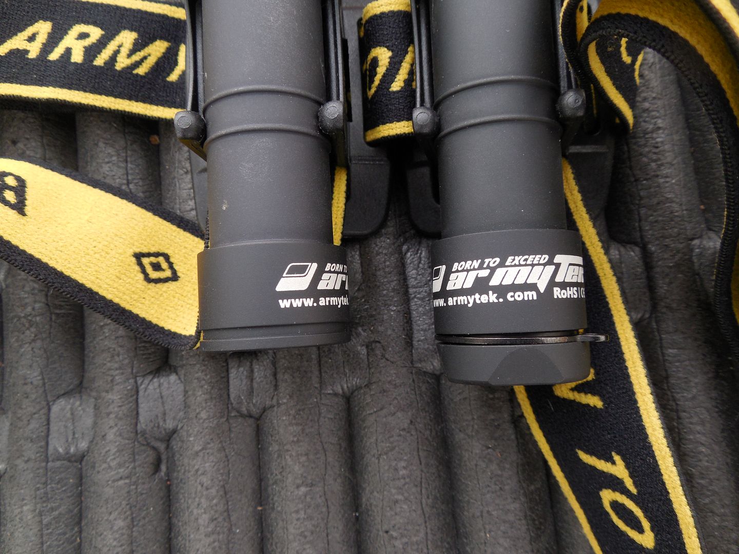

Old silicone harness on left new plastic on right. Both now come with plastic.

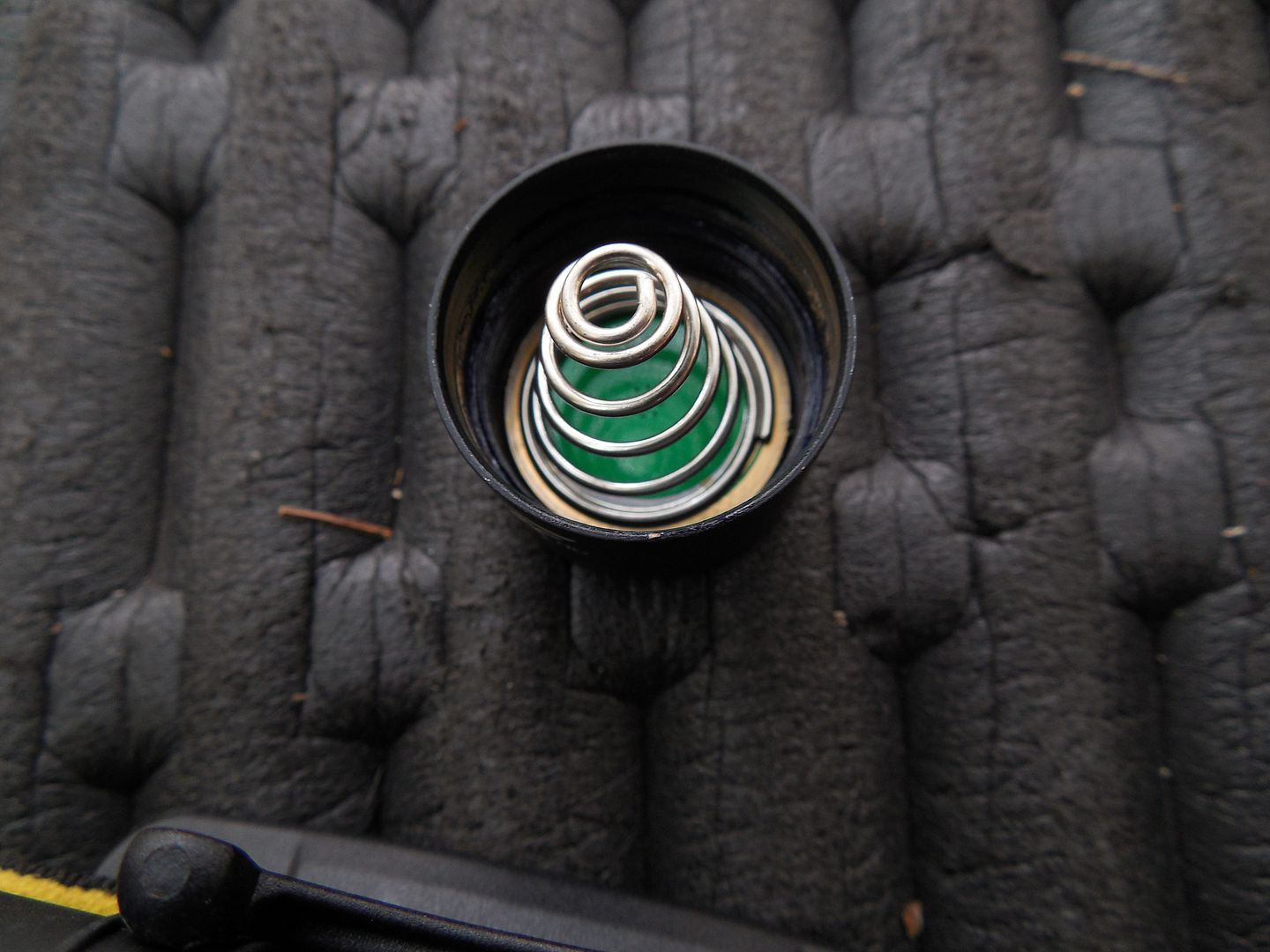

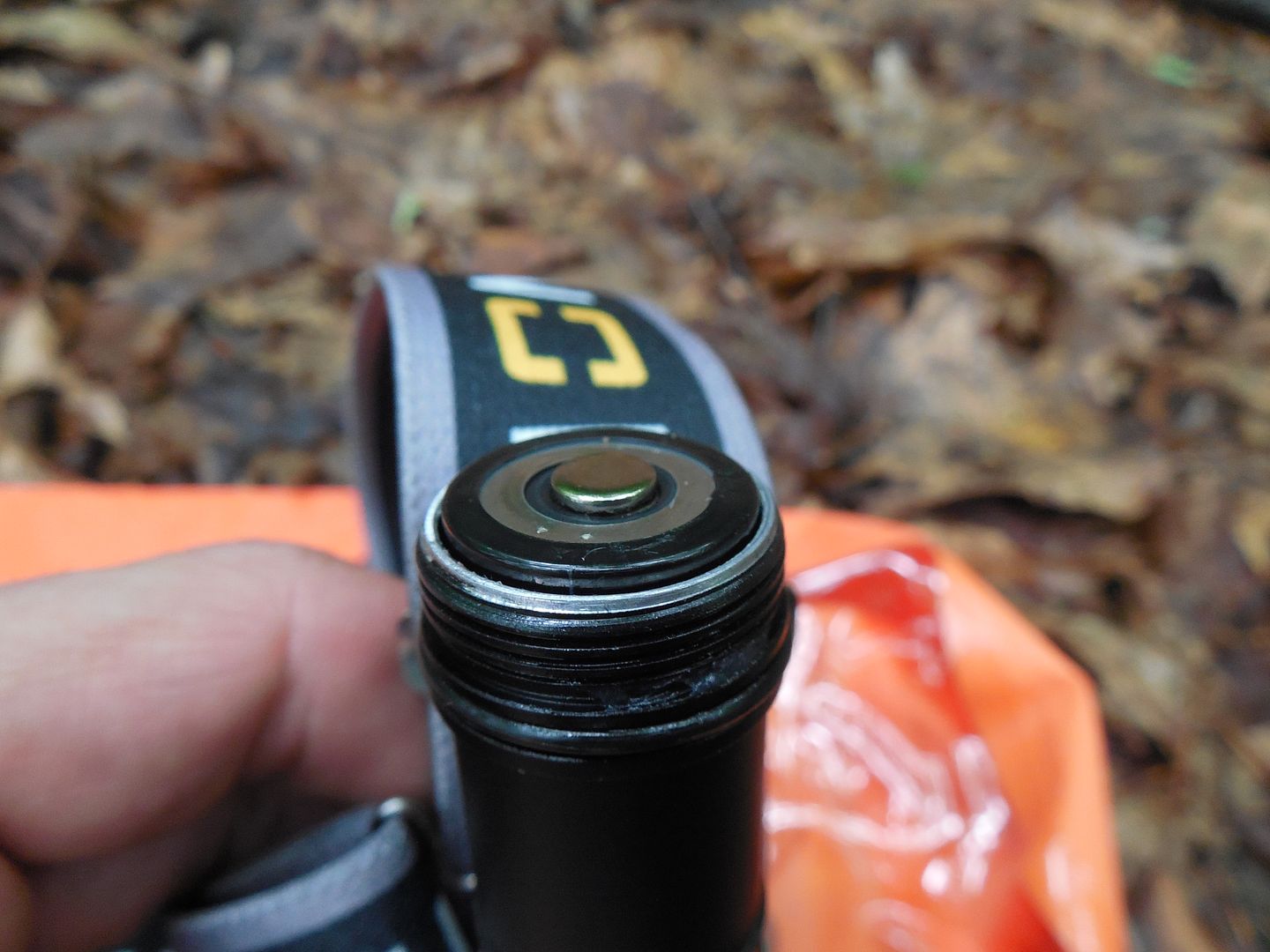

Both tail caps have the same overbuilt spring and are interchangeable.

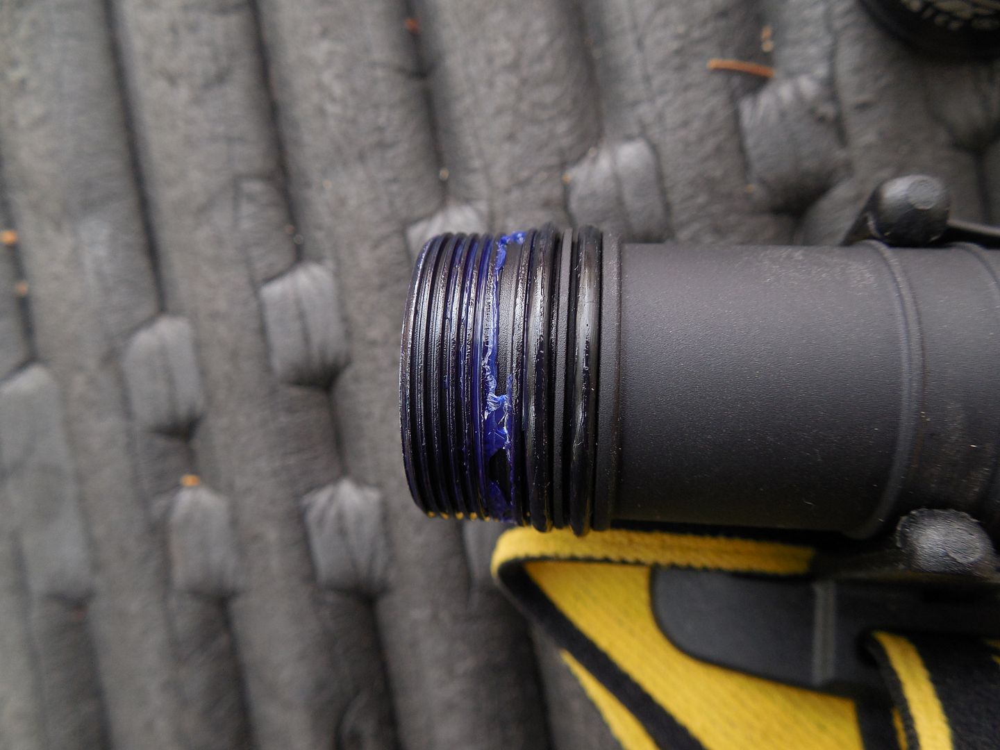

Both have the same smooth lubed thread and double O-rings.

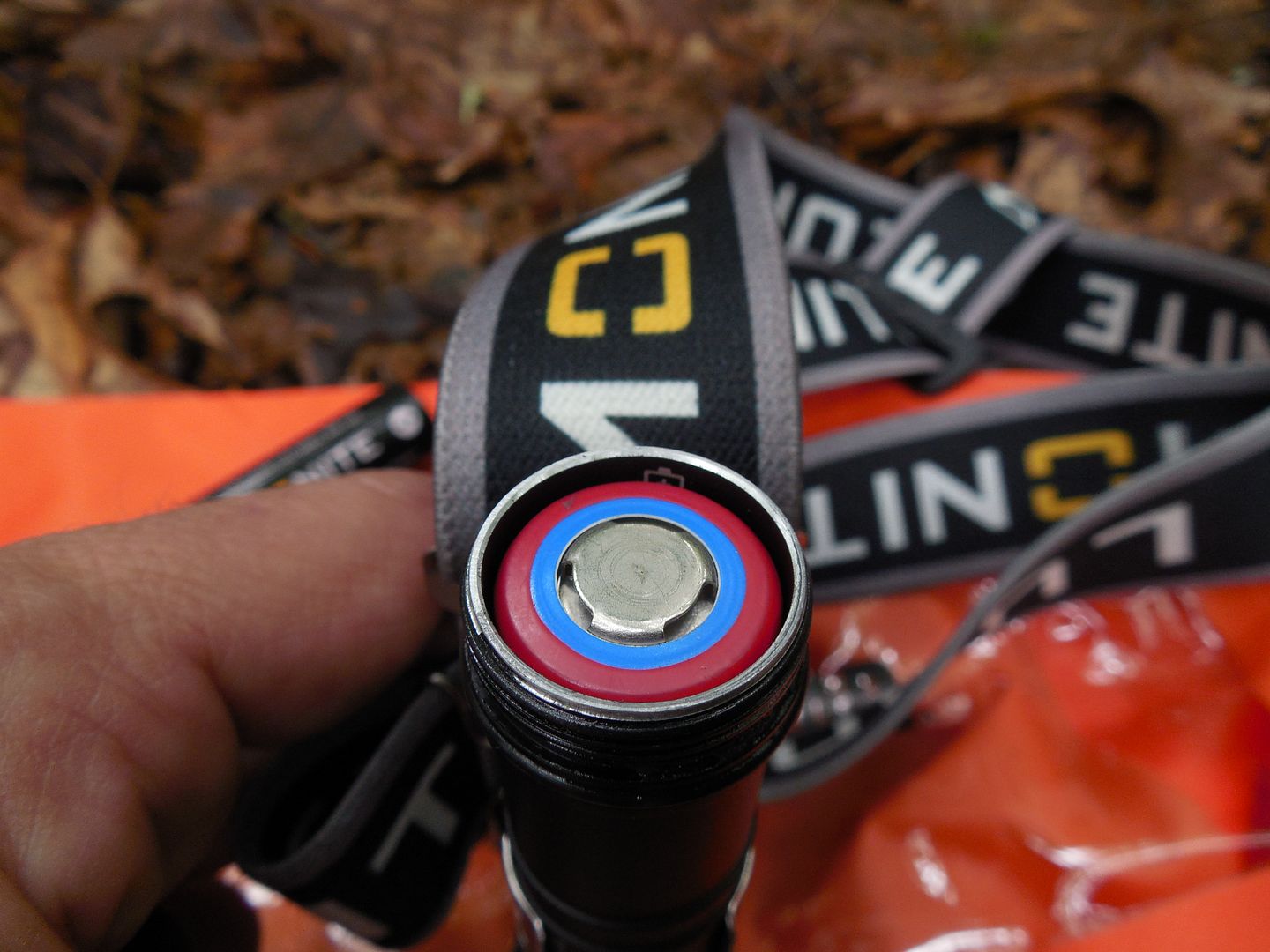

I have yet to find a battery a 18650 which doesn't fit either however the upper turbo mode on the XHP-50 requires a high drain lithium ion battery of 7A or higher.

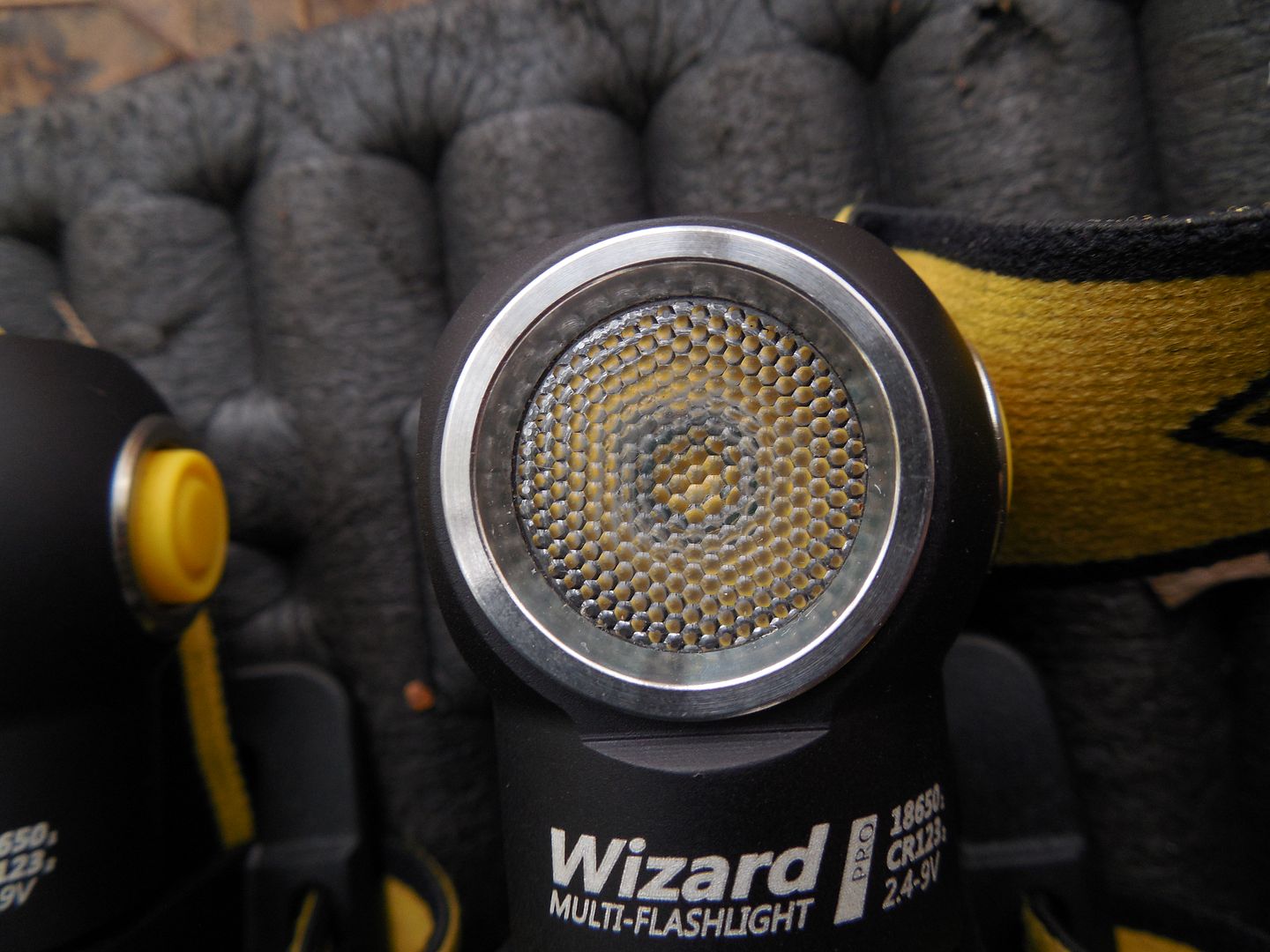

Both have the same bezel and optic which IMHO is the best general use headlamp optic going. Or at least for me.
Window with XHP-50 "warm" which is really neutral white.
Window with XP-L "white" which is really cool white.

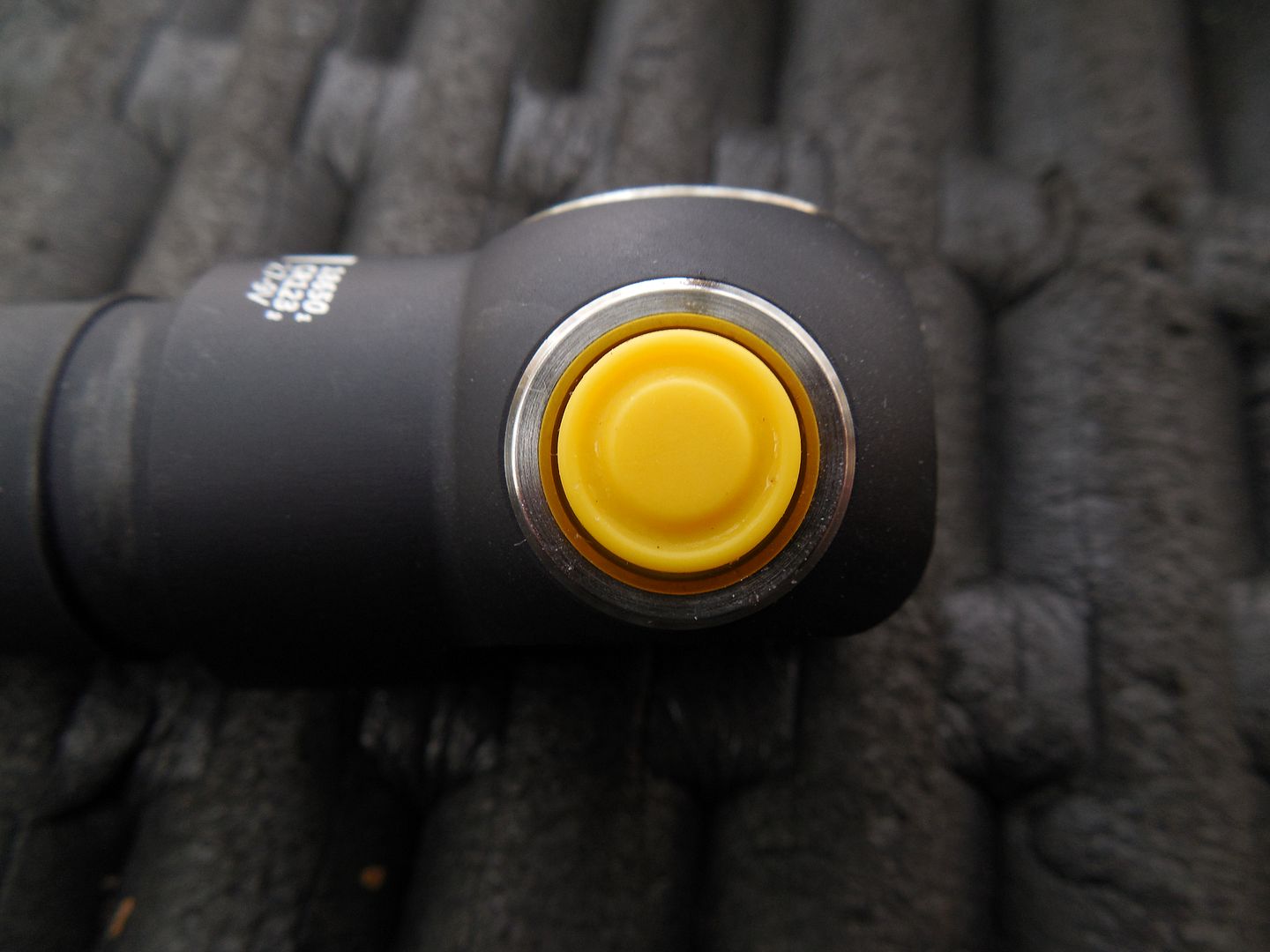

Both have yellow power/UI buttons but the standard XP-L V3 doesn't flash. Some would say this is a good thing.
Both have past my field use water tests. I already reviewed the XHP-50 pro so here is the XP-L V3.
XP-L V3 white. No water intrusion.
Now to compare the tint in field use. Yes we will get to the beaver dam....eventually.... White on left Warm on right.
Now lets reverse them.
XP-L V3 white beam shots.
Turbo. There is only one turbo mode but that's enough for about everything I need.
Main mode 3.
Main mode 2.
Main mode 1.
It has two firefly modes. This is firefly 2.
It's time for the show down at the beaver dam!
XHP-50 Warm highest Turbo.
XP-L White V3 turbo.
The output looks about the same on the camera but in person the XHP-50 has a brighter max turbo. Still the standard is really really bright and the remaining modes are comparable.
Conclusion.
The standard XP-L V3 Wizard seemed just as field effective of a tool as the XHP-50 Pro V3. The tint is personal preference though both are excellent examples of their respective classes.
Here is a video. Thanks for looking.
Main mode 3.
Main mode 2.
Main mode 1.

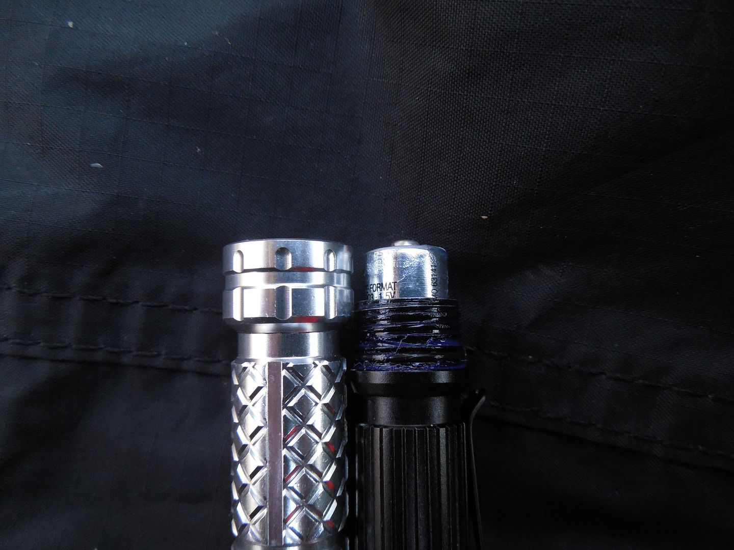

The glass window. For some reason this has the most throw out of my 1XAAA flashlights. Maybe the smooth reflector? Didn't measure to see if it was larger etc etc.
On many of the 1XAAA lights the body screws into the bezel but like the older Fenix E01 the bezel of the PK-PL2 screws in to the body.
Nice O-ring. That's going to come into play later.
It's easy to change the battery in the dark which is going to come into play later.

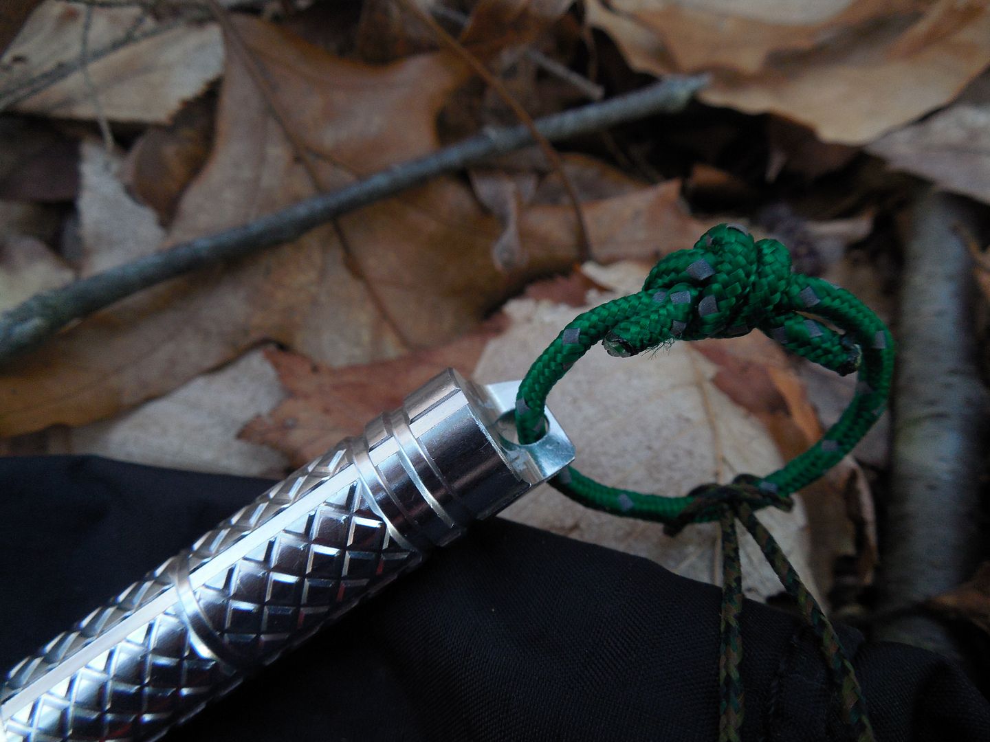

The reason being it has a more robust attachment hole. I loop tied some reflective cordage.

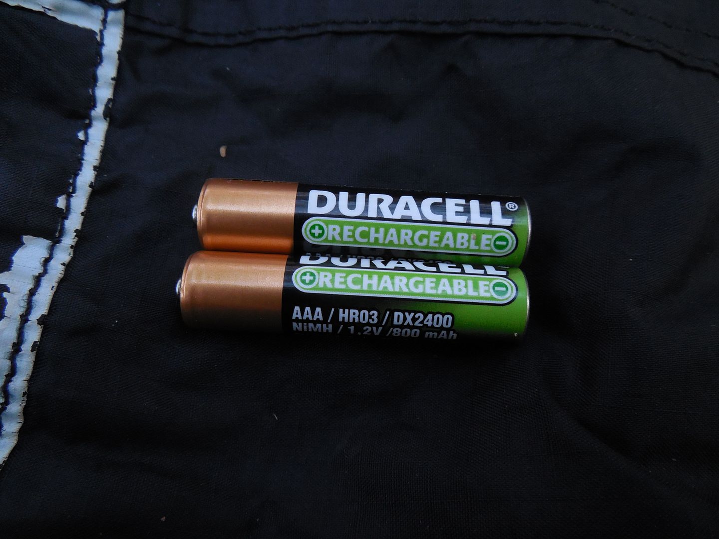

I will be using these two Duraloop 800 mAh LSD batteries for the field testing.
The setup for the field testing will be a hiker or maybe someone during a Get Me Home situation covering ground at night. The kit was made for times when I don't expect a night hike but just want to toss something in the daypack or ER bag. Kinda like tossing a Mora in a bag on a whim. I will go out 6 miles then wait for dark, then with 4 or 5 miles to go I will shut the headlamp down simulating a failure in mid step. Will take out the PK-PL2 from the pack in the pitch black then finish the hike/trail jog to my van.
It's getting on to dusk.
Headlamp is down! Time to crack out the backup.

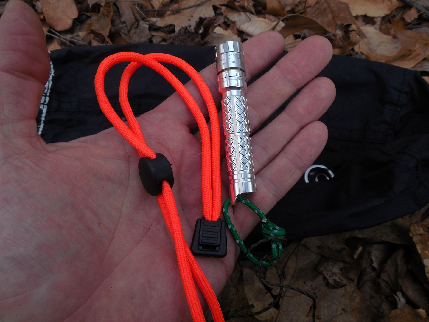

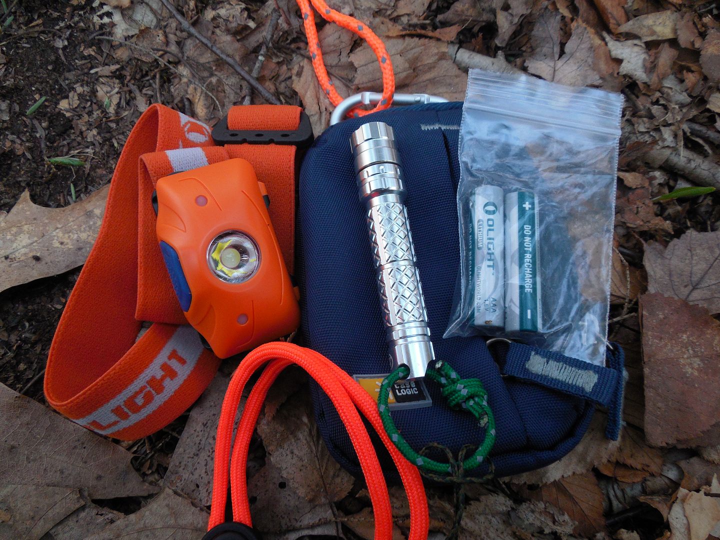

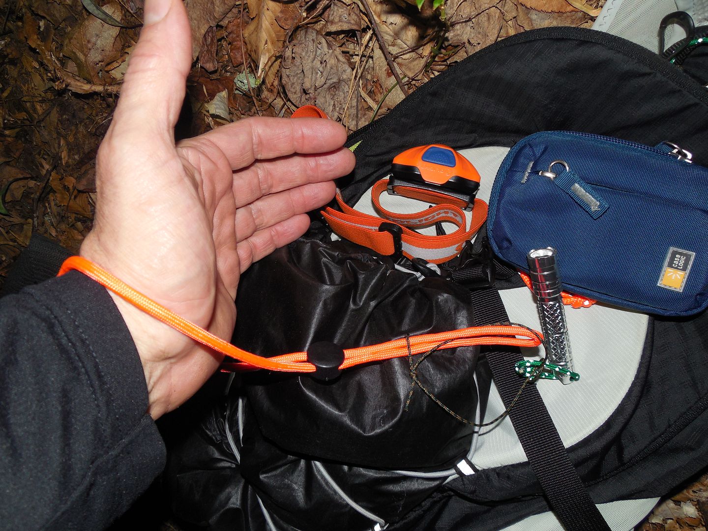

Also have a brightly colored lanyard. The lanyard/light has combined reflective and high visibility cordage which per my tests proved very effective for seeing something in low light conditions.
But that's not all I have.
1. Tops/Turley rebuild PSK.
2. Original BHK Small Tiger Knapp knife with DIY Kydex firesteel holder and ferro rod.
3. Extra fleece pullover which I will be using as the temps dropped into the low 40s.
We need to go!
High mode. The throw was great for seeing trail markers.
I could see stuff higher up as well. Good for sniffing out widow makers if I needed to spend a night out.

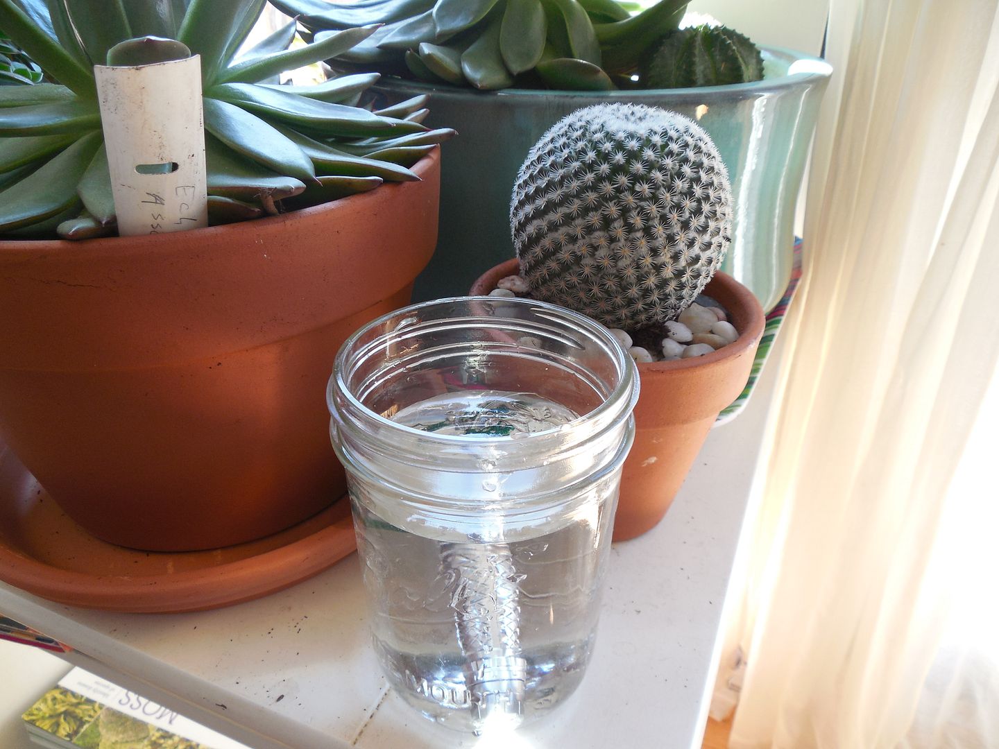

The dunk test. It's rated to handle this and field conditions are different than a jelly jar full of water near a cactus.
A bunch of little brook trout were so pissed off at this. They can be seen in the video.
No water intrusion detected. Not sure how long it was under. I messed around with a few cameras and took a wiz. Thought about the bears etc etc. Not sure how long that all takes. Back on the move using low. The UI is simple. Starts on high and then low. I wouldn't want to run on low but the output looked about right and is more than enough for lots of things.

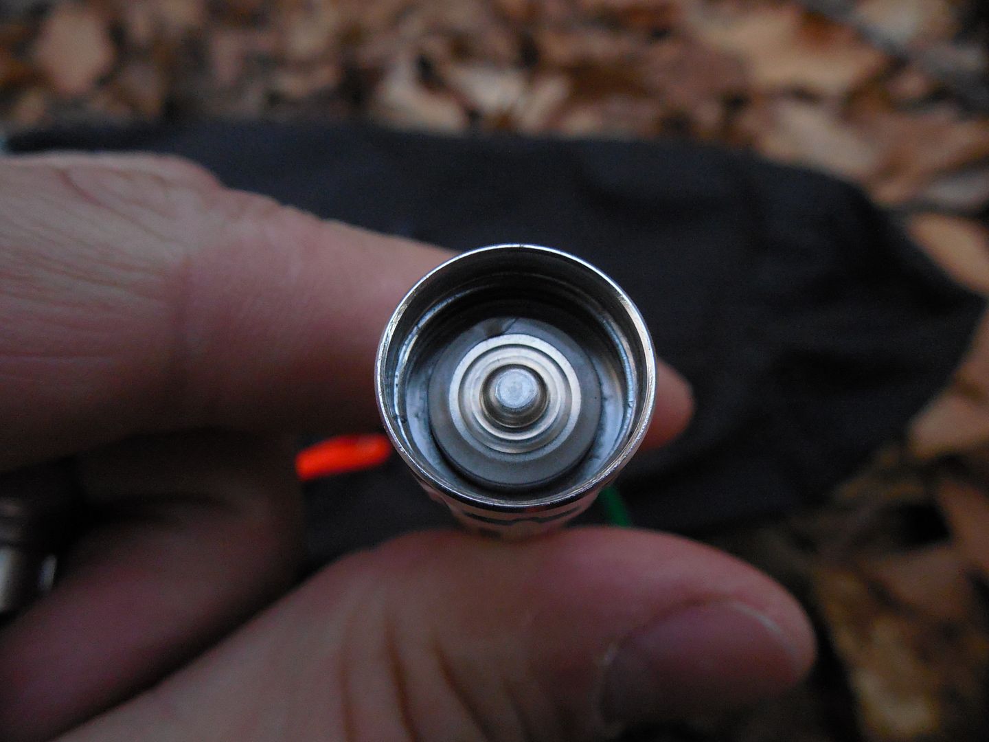

I needed to change the battery as it got low and the light became unresponsive if shut off. I could tell the regulation gave up before having issues. Flashlight don't work once the battery is exhausted. Go Figure however had plenty of warning. It was easy to change in the dark but it's really thirty on high. Then again it's really bright as well. I made it out of the woods with plenty of power left in the second battery.

I rather like the silver. It's easy to see in the environment.
A bit larger than these Olight 1XAAA otptions but not too big for EDC.

You get a larger split ring than some other 1XAAA lights.

Back on high trying to avoid the thorns.

I liked it enough to replace an Olight i3S within my little lighting kit for this application. I consider the i3S EOS to be one of the best 1XAAA flashlights so that's says something.

Single click to turn the light on which will be the last one used as there is a memory. Single click again to turn off the light. Press and hold the switch with light on and it will cycle through the modes, low, medium and high. Double click from any mode to enter turbo. Double click to return back.
Moonlight mode:
When the light is off, press and hold the switch for 2 seconds.
Keylock:
When the light is off, press and hold the switch for more than 2 seconds. To unlock, press and hold long.
During field use I found the UI easy to use though the keylock was entered accidentally a few times at first when going into moonlight. It was easy to enter turbo mode then return to the last mode used. I like using the headlamps as a single click on and off light with memory of the last mode used. Nice and simple to use. I like that.
The headlamps. Mini on the left and Mini R on the right.

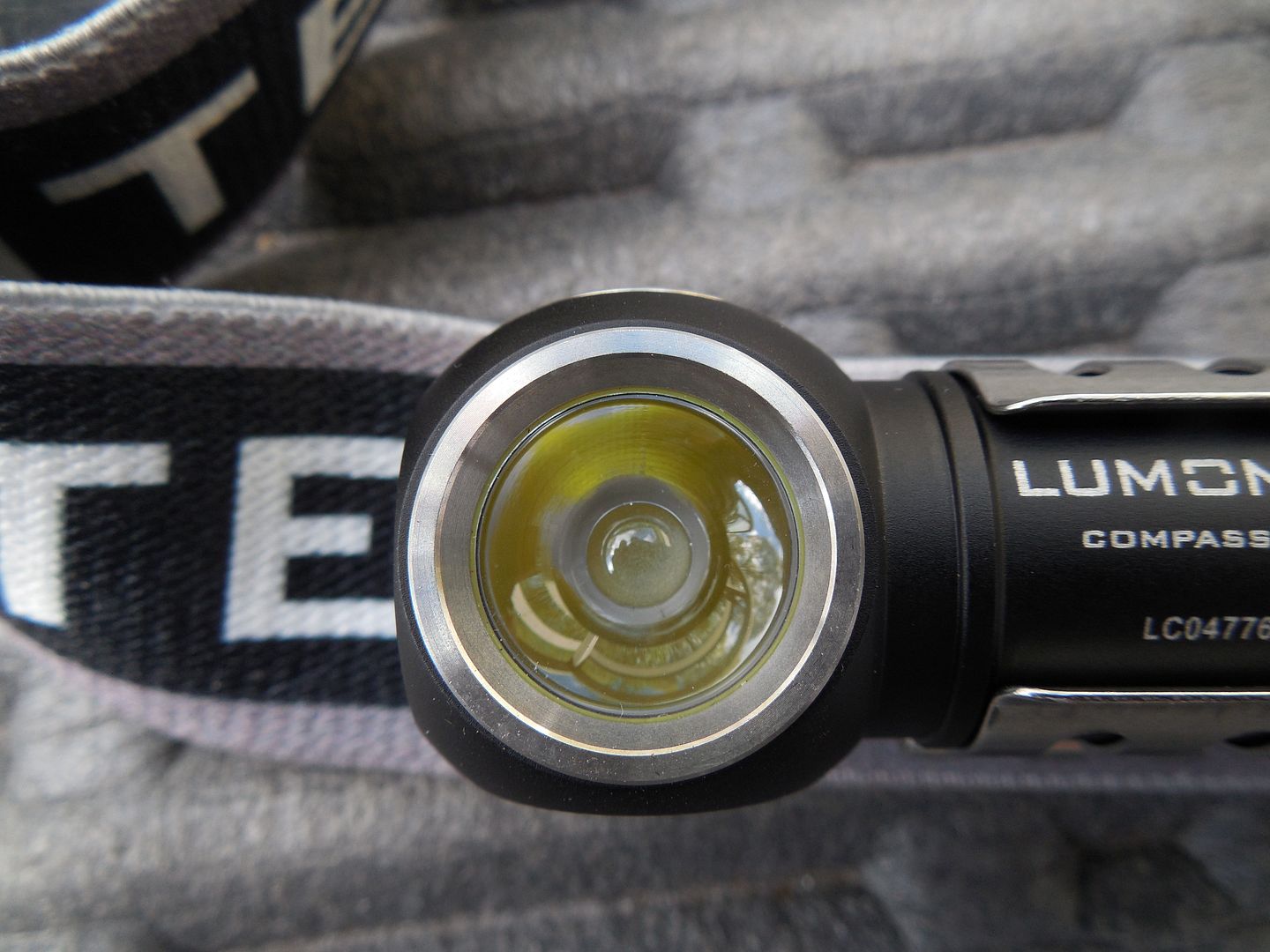

The size is comparable to other 1XCR123 headlamps such as this Fenix HL50 in CR123 configuration.
The optic reminds me of the Olight H05 Active. No PWM detected on cellphone or shake test.
Cellphone camera looks clean in terms of PWM or other distortions within the output.
This produces a beam with a more concentrated hot spot however there is a cast of light beyond the hot spot which is hard to see in video and photos but visible during use. That said the beam pattern is more concentrated than headlamps with greater flood. Lumonite Mini on left, Armytek Wizard on right.

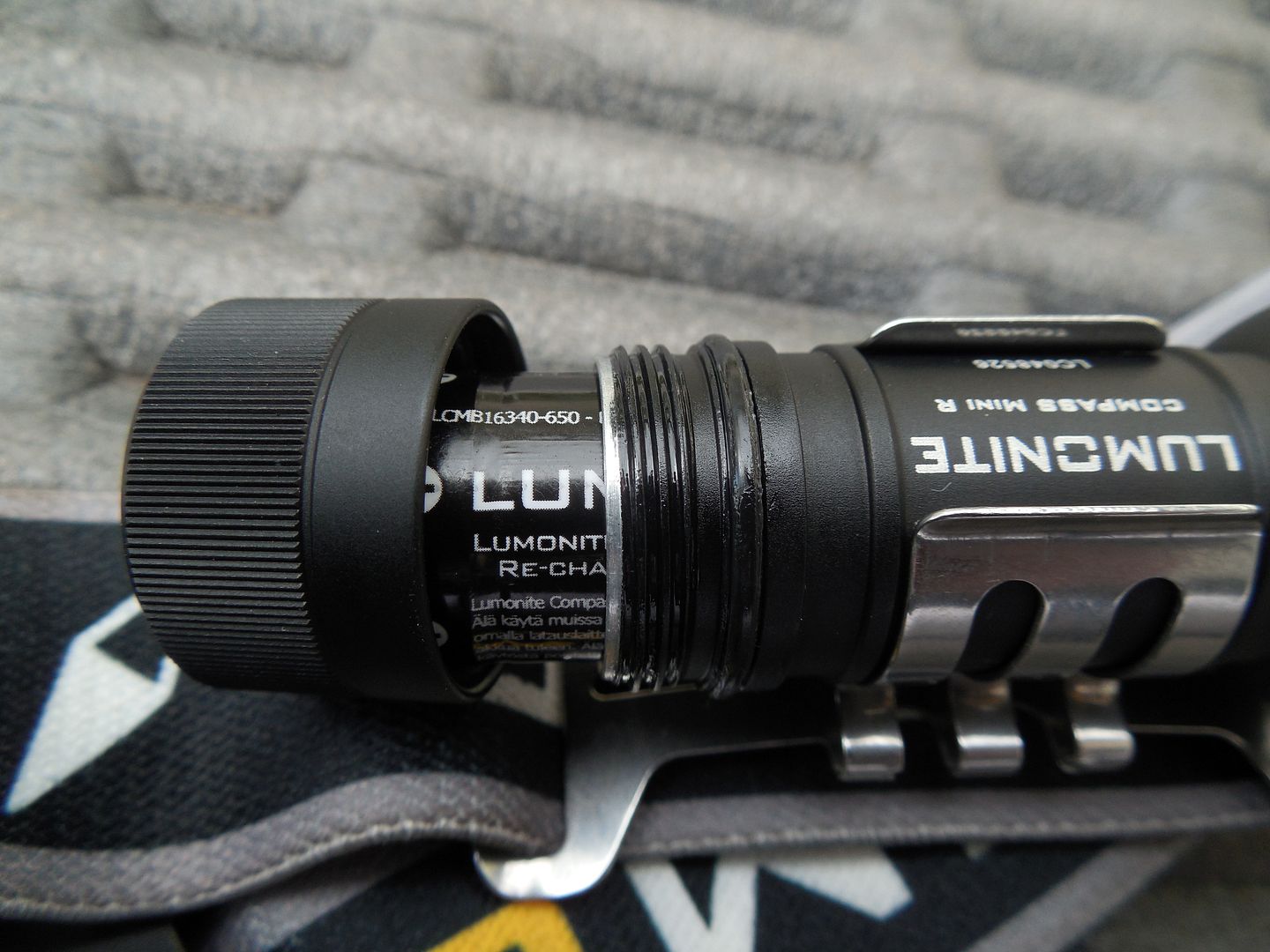

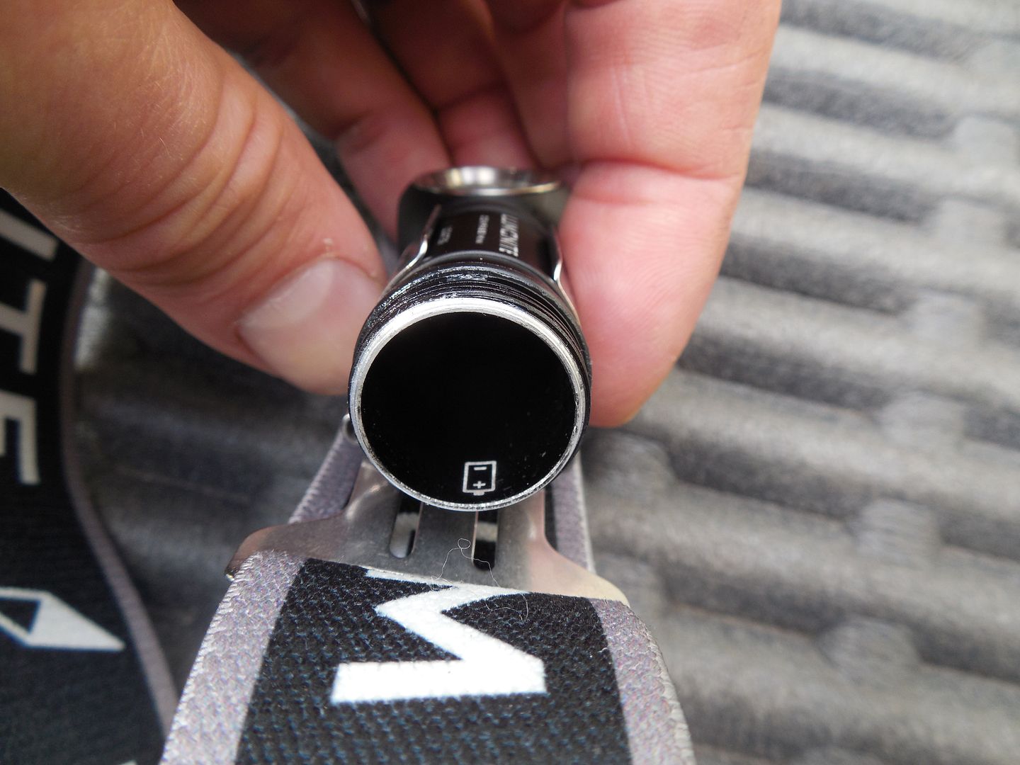

The threads came lubricated and felt smooth. The headlamp can be physically locked out with a twist of the tail cap. There is an O-ring for water resistance.
Inside the tube there is a spring on the end near the bezel with some kinda stopper. This differs from other headlamps I own which have the spring on the tail. One result being the polarity is reversed with positive end at the tail cap. The headlamps are polarity protected as mistakenly inserted the batteries upside down a few times. No issues beyond a need to flip the battery around.
There is a guide to proper polarity within the tube.

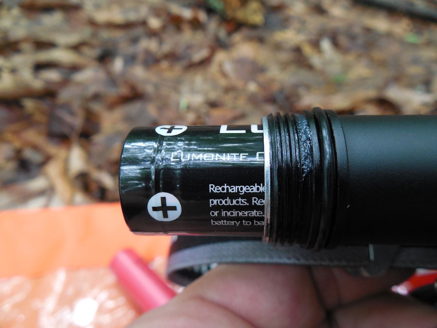

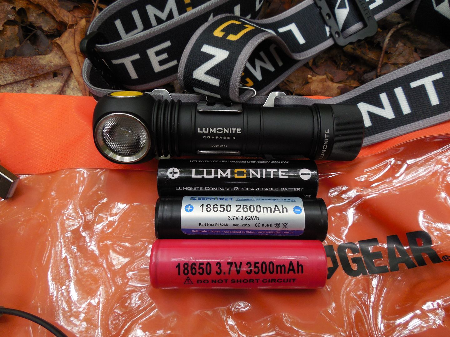

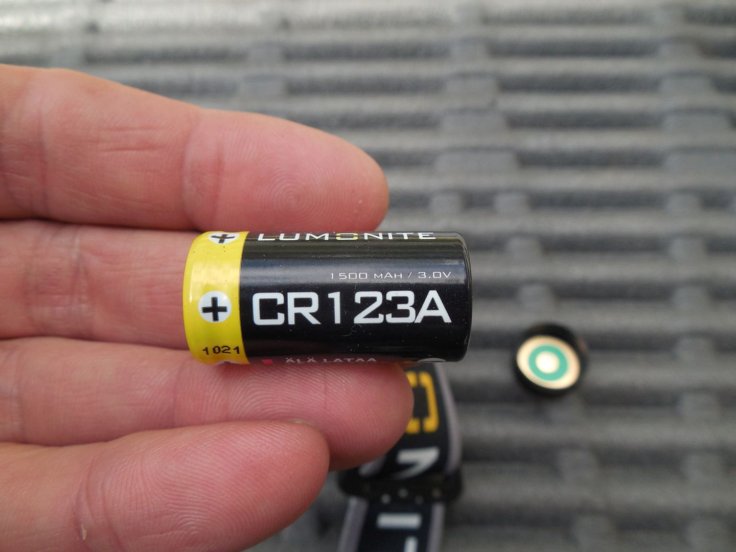

The Mini comes with a 1500 mAh lithium primary. 3 nominal volts times 1.5 ah is 4.5 watt hours.
The Mini R comes with a 650 mAh 3.7 volt lithium ion which is propitiatory. 3.7 nominal volts times .65 ah is 2.405 watt hours. Assuming my hack math is worth anything a 16340 lithium ion has less energy than a CR123 lithium primary however there are pros and cons to each. Both Mini and Mini R can use standard lithium CR123 primaries or regular 16340 however only the Mini R can USB charge the supplied propitiatory lithium ion battery though never actually tested if a standard lithium-ion would also charge. I don't like to monkey around with Lithium-ion batteries so sticking to the manufacture's recommendations. Also clearly charging a primary CR123 would be a big mistake.The voltage range is 2 to 4.2 volts so use a protected 16340 lithium ion.
The stainless steel holder has good retention but allows for the light to be removed from the harness. I removed the light multiple times from the harness and so far have not noticed any scrapes on the anodizing.

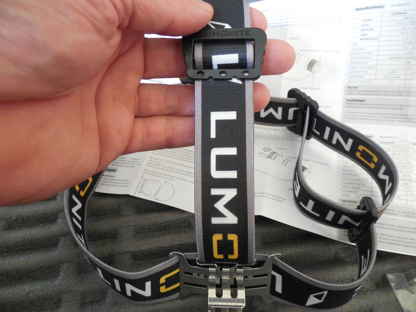

The strap is wider than any other headlamp I own with plenty of room for adjustment. The buckles are also bigger and have grooves. This make for easier adjustments on the fly. The combination of Stainless harness, wider strap and buckle makes for a very comfortable headlamp which is easy to work with during higher activity. Armytek band and adjustment buckle on left Lumonite or right.

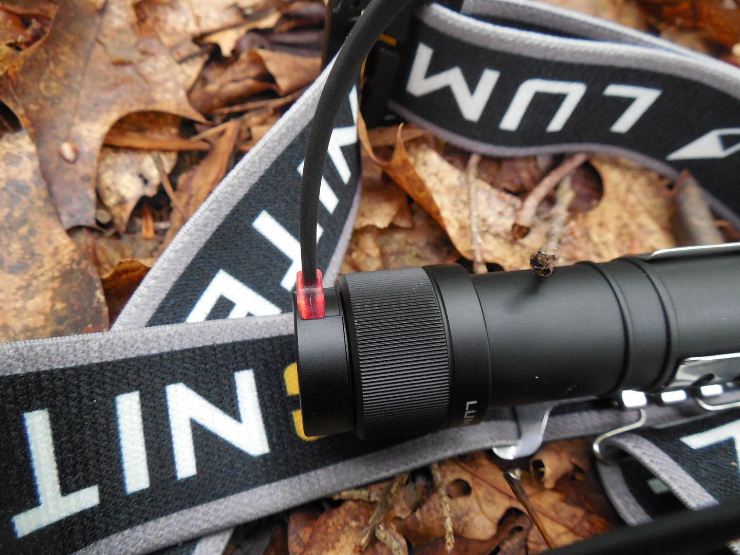

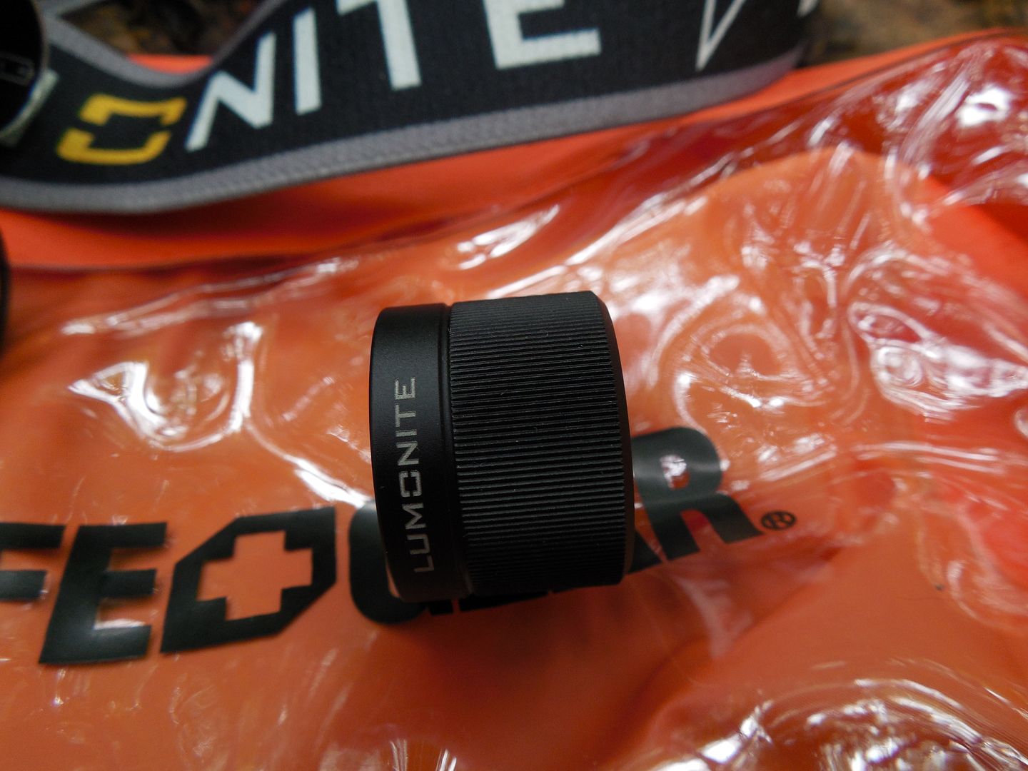

Both tail caps have groves for improved griping to turn but differ because of the USB charging function of the R model.
Mini on the left and Mini R tail cap on the right.

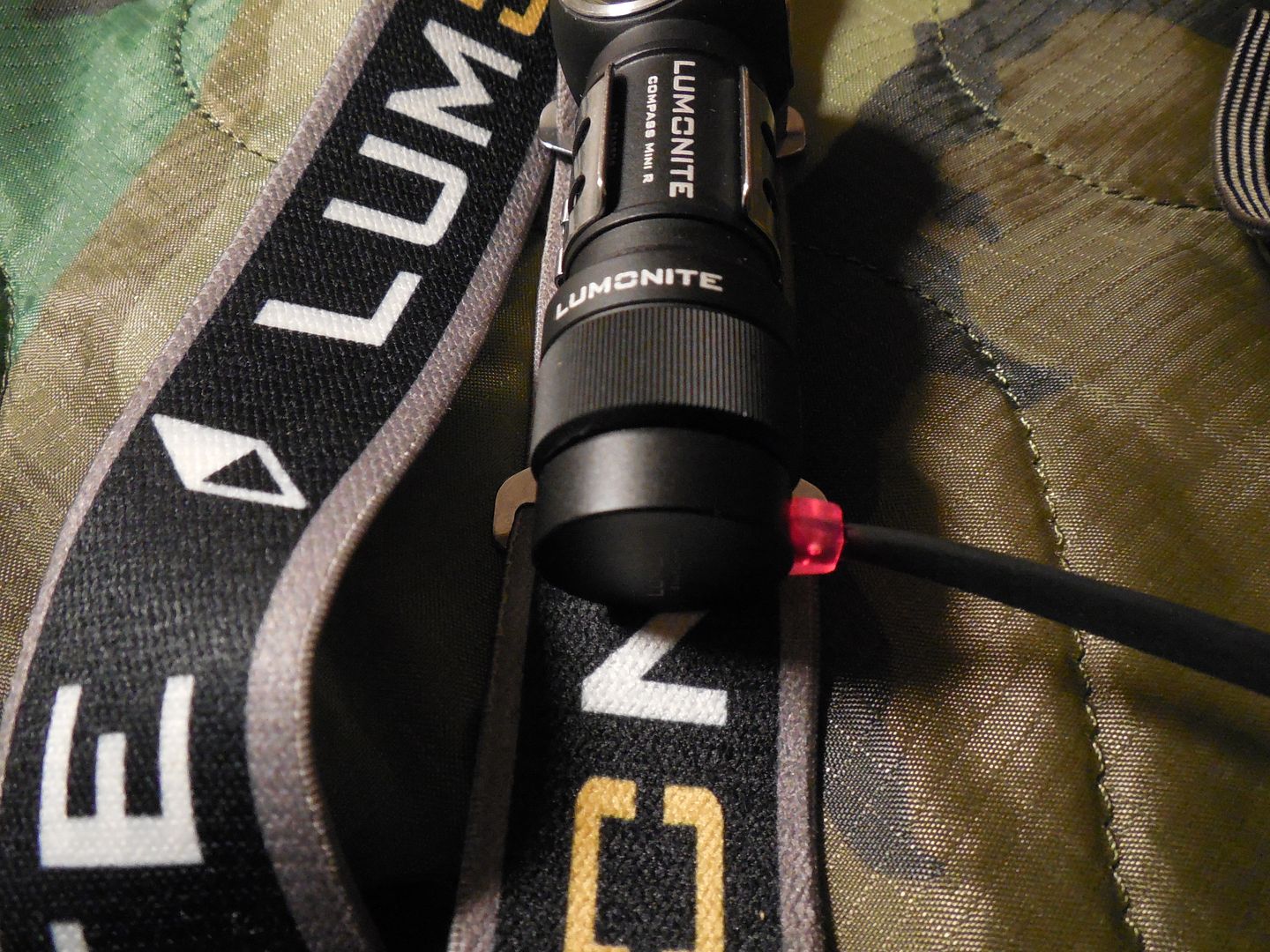

A close up of the USB magnetic charging system. Both come with extra set of O-rings however the R has magnetic USB charging cable along with a proprietary 16340 lithium ion battery.

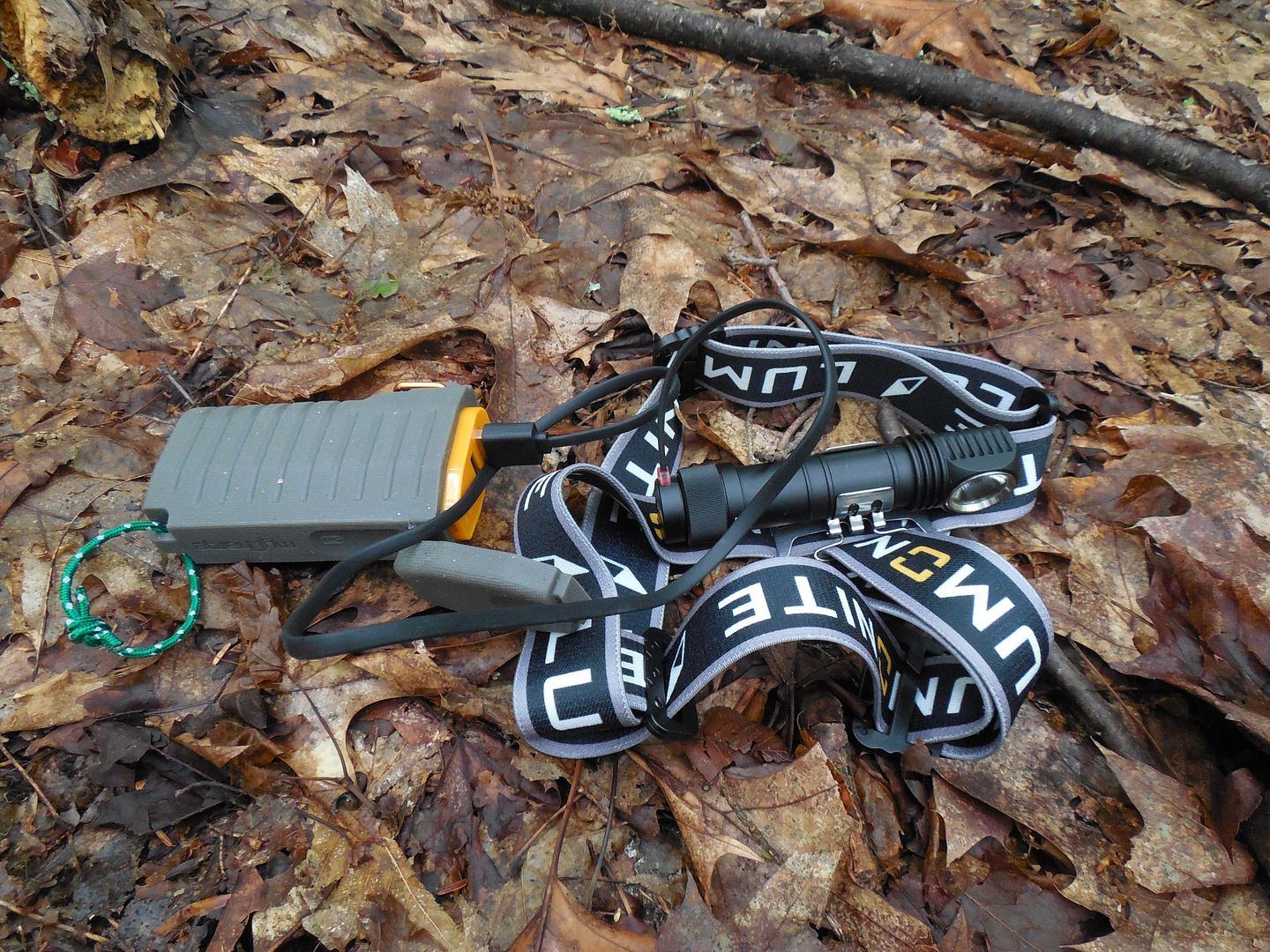

It can be charged from any 5 volt USB power supply. This works great for in field power bank charging.
The cable magnetically attaches to the tail cap and charges turning red when charging then green when finished.
The weather/water proof rating is listed as IPX8. They both handled repeated dunk and submersion tests just fine.

I have put about 100 trail miles on these headlamps plus an overnight outing. Often the best way to evaluate something is within actual field use. This is one pro to spending a good amount of time on the trails. Yea get a bunch of experience using a gear item in multiple conditions rapidly. Beyond just bringing the headlamps along for use in place of other options I separated the field testing into two official outings. One was 8 miles during a wild night in which I tested the Mini R for 4 miles then a 18650 Compass R during the return hike. The other was a 6.8 mile woodland adventure.
The wild night. Part 1 Mini R. For Part two you will have to see the 18650 Compass R review.
Nothing says fun like 44F with heavy rain going all night as you push through. I know heavy rain in the lower 40's doesn't sound all that hard but it literately sucks the life out of a person. In the video we are running through these conditions. This is something I do not recommend unless you do trail running as part of your training. The risk of mechanical injury is great and hypothermia is a surprising danger even if the pure numbers might look otherwise.
No inside testing can IMHO properly reproduce actual weather and submersion testing in the field. Rain hitting the headlamp when jogging through the wind is hard to reproduce inside. Submersion in a brook or stream isn't the same as a glass of water either. Due to field conditions the photos for the weather testing were taken directly from the video. That camera was totally waterproof.
Water was pouring down the sides of the hills.
I would need to find a safe area for the dunk test. Odds are I might not be seen again never mind the Headlamp. LOL!
Areas away from the raging river and run-offs would be nice though still moving and muddy. The type of water a person could drop their headlamp into by accident and yet still have a chance to retrieve it.
The switch lights up. I somehow think it uses the light from the main LED to do it.
The water was murky but headlamp survived the submersion. Needless to say the driving rain wasn't an issue either.
The more concentrate beam worked well moving in the rain and mist.
Both past the weather/water resistance testing. Moving on to night hike/trail running.
Turbo is bright and appears more than the 440 listed lumens might imply though it wasn't too long ago when so much light out of such a little headlamp was unimaginable.
High is really bright. High mode.
High mode action shot taken from the video. That little speck on top of the lower center rock was actually a sunfish out of water flipping around. It's in the video and makes a get-a-way though not sure from what?
Medium mode. The beam was good for seeing trail markers at distance.
The medium is what I mostly use when moving though the woods faster.
One of my rules to traveling fast at night on two feet. Never.... Never trust any rock subject to moving water. Always assume it's unstable and slow down. Still on medium mode.
The medium is a bit too bright for close up but not overly so. Still for the most part the 10 lumen low mode is plenty for around camp.
One of the pros to the more concentrated beam is I could use the low mode for more things. This is nice given the smaller battery however if I had multiple extra batteries or a larger power source such as a 18650 often I prefer a beam with more flood. Still it made me rethink my belief a flooder headlamp is better. Sometimes yes but not all the time.
Low mode. I could actually use this for hiking if required.
Low mode. Sometimes the moving water rule isn't so easy to distinguish. It might look like just wet ground but this is going down hill. You can bet during heavy rain the water is moving and undercutting the rocks. So I treat this ground much like crossing a stream. I do not trust this rock to be stable.
Low mode again looking at a wild edible.
Moonlight mode. Picking a trail nibble. I have always liked the 2-3 lumen moonlight mode from the first time I used it going back to the Nitecore EX10 and 4/7 Quarks. That said some people have come to expect one lumen or less to imply a true moonlight mode or is that a firefly mode. Well in any case these lights don't have a sub lumen mode but I really like this level of light. Enough light to be useful around camp or inside but not so little to be problematic for my use.

2. The beam is more concentrated. Bottom line if you want maximum flood this isn't the headlamp for you.

Got in from another night run. The Compass Mini R just so happened to be inside the running pack.
Medium mode.
Trout management area however the sign got washed out in the light.
Sniffing around to spot light trout for future fly fishing during the day.
Rocks.
Moth.
Night flowers. Well really they're just some roses and weeds.
Low mode.
High mode.
Turbo.
Medium mode.
Rocks.
Moth.
Low mode.
High mode.
Turbo.

Re: Bug Out Gear Reviews.
Lumonite Compass R Headlamp field use review.

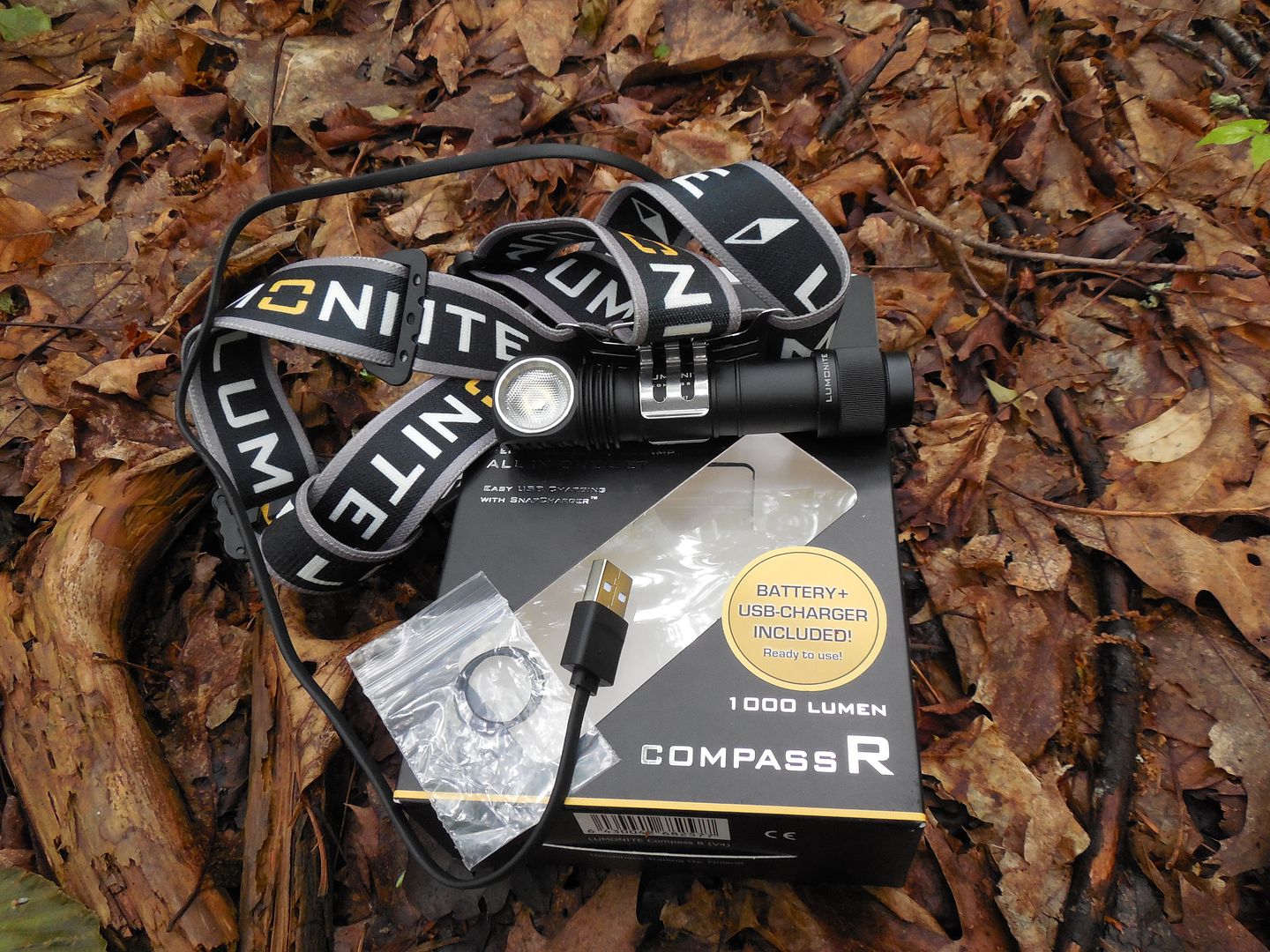

Disclaimer. This headlamp was sent all the way from Finland for review from the manufacture. Yes that's correct. Finland! I do like scandi knives such as Marttiini but these are my first lights from that nation.
This is field use review of the Lumonite Compass R headlamp. Here is information from the manufacture.
http://www.lumonite.com/en/lumonite_compass_r/
The headlamp.
The optic reminds me of the Armytek Wizard. No PWM detected on cellphone or shake test.
This produces a beam with a good deal of flood but can project a beam a useful distance. If you like beams on the floody side this headlamp is a good option.
Notice the switch is illuminated during operation. I somehow feel the switch gets the light from the main LED. Nice floody beam profile.
Nice big yellow switch which is easy to find and use.
On one side of the bezel are ribs to better transfer heat away from the LED. The same for the area below the bezel.

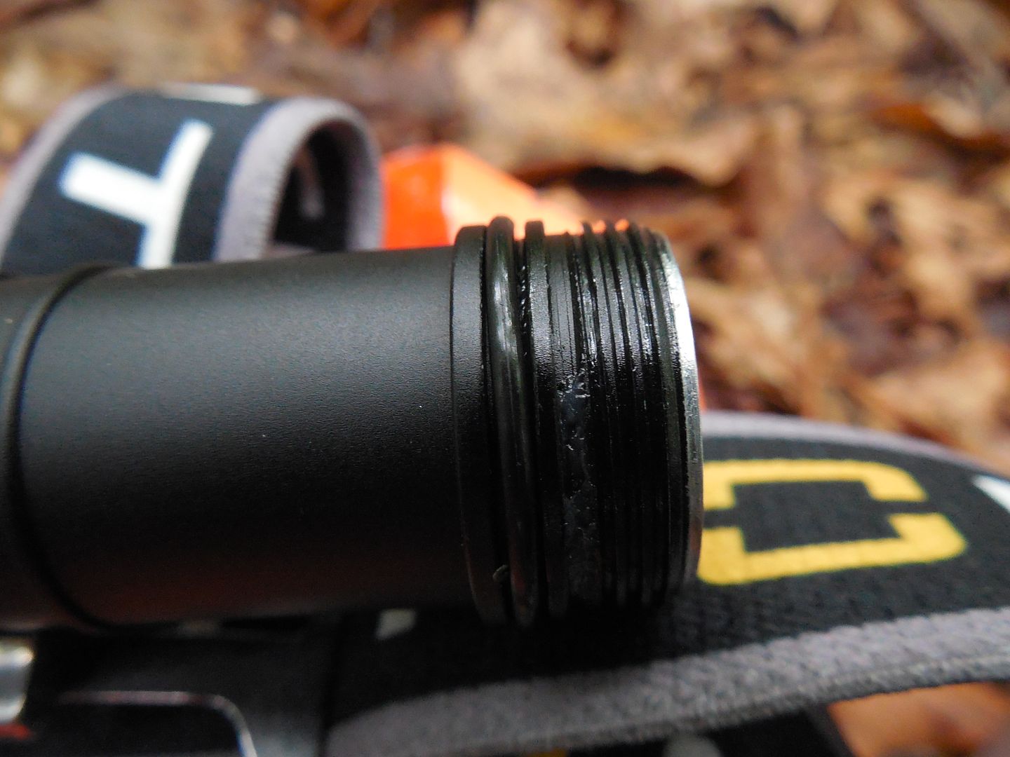

The Compass R comes with a proprietary 3600 mAh lithium primary.
The 3600 mAh 3.7 volt lithium ion is propitiatory. 3.7 nominal volts times 3.6 ah is 13.32 watt hours. Assuming my hack math is worth anything that is a a bunch of power. The Compass R can use regular 18650 but the supplied propitiatory lithium ion battery should only be charged in the headlamp. I have never actually tested if a standard lithium-ion would also charge. I don't like to monkey around with Lithium-ion batteries so sticking to the manufacture's recommendations. The voltage range is 2 to 4.2 volts so use a protected 18650 lithium ion.
However there is an exception. The headlamp failed to work with a 18650 Sanyo NCR18650GA 3500mAh High Discharge Flat Top. The reason near as I can tell is battery length.
Sanyo red.
Keeppower 2600 Protected. A Keeppower 3500 mAh high draw protected also functioned.
The stainless steel holder has good retention but allows for the light to be removed from the harness. I removed the light multiple times from the harness and so far have not noticed any scrapes on the anodizing. There is a top strap which hooks on. It is possible to accidentally displace the hook setup when handling as it is hooked on. That said it doesn't come off during use or most of the times when handling the headlamp.
Top strap loops on the back of the headlamp.
I have a high degree of confidence this headband is durable and great for use under hard conditions. Easy to adjust on the fly.
The tail cap has groves for improved griping. Nice wide tailcap.
USB charging tail features.
A close up of the USB magnetic charging system. It can be charged from any 5 volt USB power supply. This works great for in field power bank charging.
The weather/water proof rating is listed as IPX8. Took submersion just fine.
Field testing:
I have put about 60 trail miles on the 18650 Compass R. Often the best way to evaluate something is within actual field use. This is one pro to spending a good amount of time on the trails. Yea get a bunch of experience using a gear item in multiple conditions rapidly. Beyond just bringing the headlamp along for use in place of other options I separated the field testing into two official outings. One was 8 miles during a wild night in which I tested the Mini R for 4 miles then a 18650 Compass R during the return hike. The other was a trail run over a mountain. Well it's not Everest but a fun hill for conditioning hikes/runs.
The wild night. Part 2 Compass R. For Part 1 you will have to see the Compass Mini review.
Wild night. The greater flood of the Compass R did result in a bit of glare in the rain and mist but that's the nature of the beast. I find the best illumination during bad weather is actually a flashlight when on the move. That said this did get the job done as typing about it right now.
Looking for a safe spot to do the dunk test. Kinda risky to get near flooded water.
Submersion test in nasty murky water.
Past the weather/water resistance testing. Moving on to night hike/trail running. For this adventure we did over 8 miles including some rock scrambling and trail running. Also had it out with a skunk! Well not really. I looked, the skunk lifted it's tail so he won the debate with me backing off. The High mode is listed at 630 lumens and looks all of it. The medium is 230 and like the high it means it. These levels are highter than other headlamps I own in this class. For example the AT Wizard standard is 390 and 180, Nitecore HC30 high 400 and med 210, Fenix HP12 high 400 med 150. So the high mode of the Lumonite Compass is clearly brighter than my other options though they have similar Turbo modes.
Comparison of modes in field use. Hiking up to the top.
Low.
Medium.
High is an understatement.
Turbo. Yup it's bright!
The world famous Tulip Poplar test. Well actually there is no such thing but Tulip Poplar trees do grow very tall.
Low.
Turbo.
Medium. The flood beam worked nice when scampering down these rocks. Medium was more than enough.
Turbo.
Random beam shots from the adventure.
Turbo of ledge and boulders. Remember to always apply 3 points of contact when when on rough ground.
Turbo skunk encounter action shot from the video. Somehow I came out on top. Proof of providence shinning down or random chance working out in my favor? We may never know but I survived.
High mode. Taking the abandoned tracks back the trail head. Well actually the dirt road then tracks. Longer but faster than going back over the mountain.
Medium mode. A little pool surrounded by mountain laurels higher up which I occasionally use for dunk tests.
Low mode. Large millipedes were all over the tracks. I didn't want to step on one as it might be bad luck. Or is that lady bugs?
A bit on the creepy side. Close up shows the floody beam on low which at 85 lumens is rather bright.
Low mode is more than enough to see most trail markers.

The headlamp.
Sanyo red.

8. The Turbo mode is a joy to use. Easy to activate then return to the last mode used yet not so easy as to accidentally activate. Also the headlamp ramps up and down to/from Turbo mode. It's hard to explain and can be seen in the video but overall makes using Turbo more practice during actual field use.
9. The UI is relatively simple and no flashy disco modes.
10. I am liking this USB magnetic charging thing. If that feature is important maybe consider the R model.
11. I like getting batteries included and more if it is a lithium ion.
12. I really really and I mean really like the beam pattern.
Cons.
1. The electronic lock out occasionally gets in my way when employing moonlight mode. Given how easily the light physically locks out not sure why this is needed. Not the end of the world as it's easy to avoid with practice. Still it was about the only con to the UI which I like.
2. It is possible to accidentally partially unhook the top strap during handling. Never happened during use and takes less than a second to reattach.
3. I wish there was a 10 or 30 lumen mode. Beyond that I am happy with the mode spacing when wanting a bright headlamp.
4. Moonlight/firefly/whatever mode connoisseurs might want an even lower mode.
5. Lower end of the voltage range is 2 volts so you should use protected lithium ion batteries though the light gives plenty of warning of low power.
6. The narrow voltage range means it can't use 2XCR123.
7. Can't use unprotected 18650. Not really a big deal for me but might be a con for others.
Conclusion.
I really like it!
Here is a video of all the fun. Thanks for looking.

Did some solar testing of the Compass R and Mini R for Solar charging compatibility. I was unable to induce a charging error by interrupting sunlight using a 14 watt panel. This isn't to say a charging error is not possible but I tried.
Solar charging. I tested the two models at the same time as they have the same charging system.
Compass Mini R.
Compass.
Solar charging. They both charged in the same way. I didn't time anything rather looking for compatibility.
Charging.
Done.
I tested using an outlet powered USB plug after to make sure they were really fully charged which they were. So based on this and a few other solar testing sessions I believe them to be solar compatible though your mileage might vary.
Compass Mini R.
Compass.
Charging.
Done.

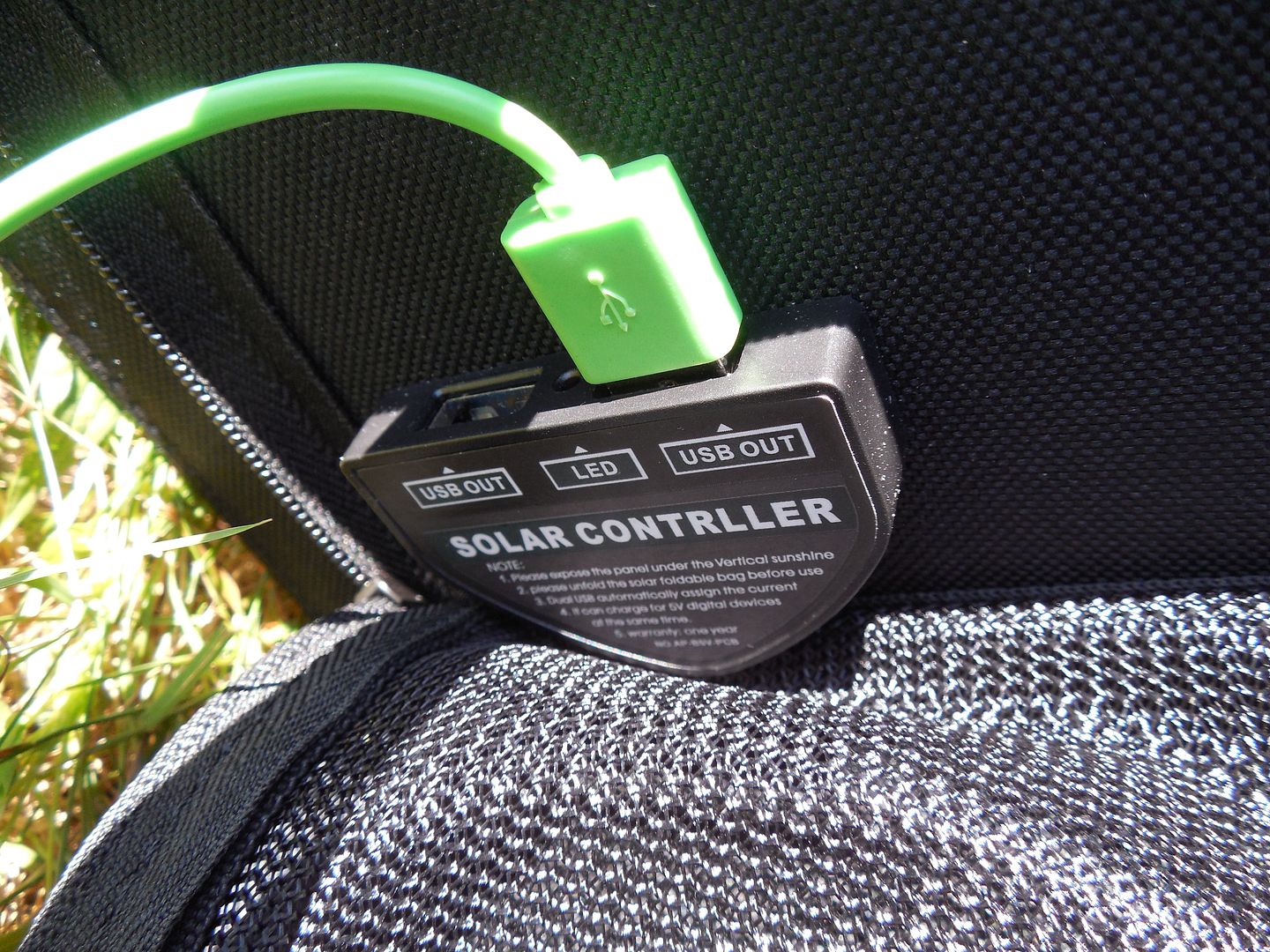

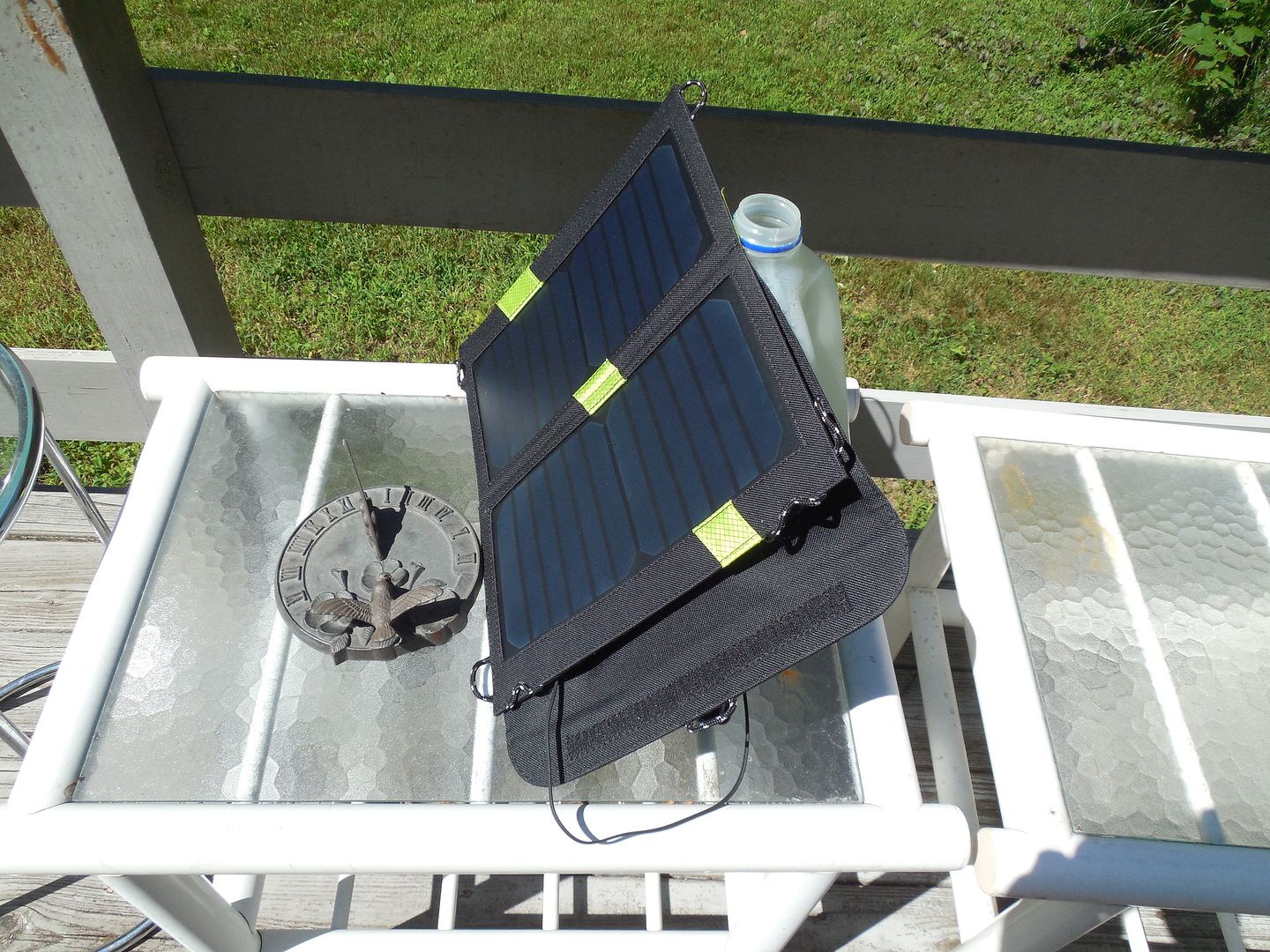

Did some solar testing of the Nitecore NU20. Seemed solar compatible using a 14 watt panel. I was unable to induce a charging error though your mileage might vary. This is one pro to USB powered devices. Charging from powerbanks and solar.
Solar Controller is missing an (o). I never noticed that before.
I didn't time it but charged good.

Surefire 6PX Pro.
If anyone wants to know if these are waterproof there is a world under the ice test done which is a first for me.
Test done at 14:45 also video of the beam etc etc shown before that.
Here are some pics of the 6PX Pro gotten during Black Friday.High 320 .0 Lumens / 2.75 hours*

NEXTORCH Eco Star field use review.
Disclaimer.
This gear item was sent to me from the manufacture to be reviewed.
The Eco Star 2XAAA headlamp.
2XAAA is a bit unusual for a form factor. I do have an Olight H05 but that's the only other headlamp I have which takes 2XAAA. Access to the battery compartment is via this notch. There is a key on the headband though its not all that difficult to open with finger nails.
The key can be seen on the bottom of the right adjustment buckle. On a side note the headband is thin yet comfortable and fits my big thick head.
Glow in the dark writing.
Battery installation polarity is clearly shown. I intentionally tried to put them in wrong to see what would happen. The headlamp didn't turn on however it was also just fine. It ran well using Energizer alkaline, LSD NiMH and lithium primaries.
The UI is controlled by a single large easy to find button. There is no lock out feature that I could find.
1.Click once to turn on. It starts on high.
2. Clicking again within a few seconds will then go to low. Next click lastly red. Next click off.
3. Clicking after 3 or more seconds of operation will turn the light off in any mode. You can also turn the light off by cycling through the modes as explained in 2.
4. There is no memory mode. It will come back on high if left running for more than 3 seconds when originally turned off.
The headlamp moves on this hing. It seems really durable.
The body is removable and can go into an included clip which can go onto webbing or even a ball cap. The light can adjust up or down just like in the headband. This makes for a nice hands free plus headband free use for a pack. That feature was tested in the video.
Side grooves to help grasp the light when adjusting the beam angle.
The Eco Star has two white and one red 5mm LEDS.
White wall white LED bream. Despite having two LEDs the beam combines to make for a nice floody output. It would be hard to tell wearing the headlamp they're actually two LEDs.
Low.
High.
Side beam profile.
The red LED was much better than expected. It has enough power and throw to be useful. Beats out the red LED on my Fenix HL30. Left Eco and right HL30. Totally humiliates the sad red LEDs on the Olight H05.
PWM. I never checked a 5mm LED for PWM before this headlamp but didn't see anything either with the camera or by shaking.
There does seem to be PWM during the fade in effect. When changing modes the light just doesn't flash to the next mode rather fades into it. The effect looks pleasing. I think it's probably done with PWM. It's only for less than a second during mode changes. So fast it was hard to take a picture of. If it is PWM for the fade in the frequency and short duration of the effect makes it impossible to see the pulse.
Field testing.
I tested the water resistance rating of IPX-4 to the max. 3 miles of street jogging in extremely heavy not to mention cold winter rain. The type of rain which could kills someone of exposure overnight for sure. These pics were taken from the video. My picture camera would have been killed for sure in this weather.
Headlamp slow street jogging.
Maybe 2 inches of water covering the streets. My feet were soaked. The beam shinning on the water covered street.
Inspection shows no water intrusion. I am satisfied with the rain shower rating. Keep in mind IPX-4 is not dunk rated. In fact it's not really all that high on my water resistance radar so was rather surprised it held up.
I used the headlamp to hike then setup camp which can be seen in the video. Here is the floody beam illuminating my small hot tent aka wood stove heated shelter.
Low.
High.
Red.
Versatile clip.
I tested the pack/ball cap clip by crawling through the brush and general pack attachment/use. Based on the results it seemed very secure though with entropy anything is possible.
Pros.
1. Inexpensive. Under 20 bucks. Very often under 15 if you shop around.
2. It comes in multiple color options.
3. Nice beam profile for near work. Lots of flood.
4. First red LED mode I actually found useful in a headlamp.
5. Takes common battery type 2XAAA. Also easier to charge 2XAAA in many small 2 bay chargers than 3XAAA.
6. Easy to use UI.
7. Versatile Clip.
8. Past the water resistance testing.
9. UL and small.
10. Flashing mode is hidden.
Cons.
1. I prefer UIs which start on low first. Fortunately it's not super bright so not a big deal for me.
2. 2XAAA has limited power. It's not a 1X18650 headlamp.
3. No lock out option.
4. I prefer headlamps with at least 3 primary mode options but the two modes were properly spaced.
Conclusions.
Wish I knew about this headlamp sooner. It's really good.
Here is the video review.
