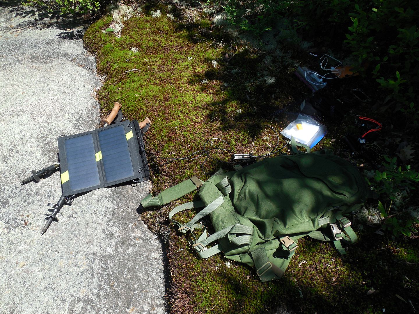

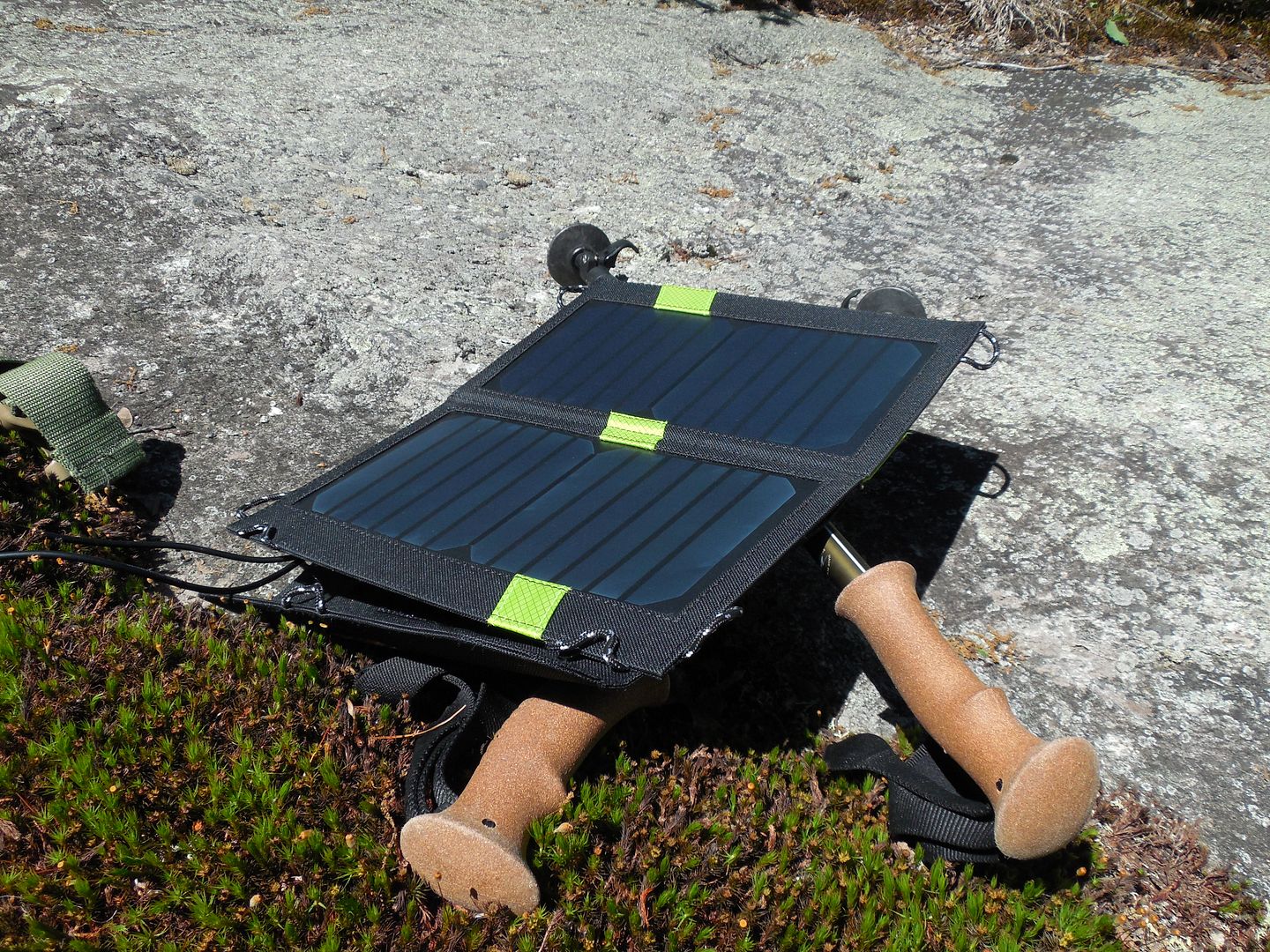

Solar power! The F1 charger never triggered a charging error during my testing despite my attempts to induce that. The F1 appears solar compatible!

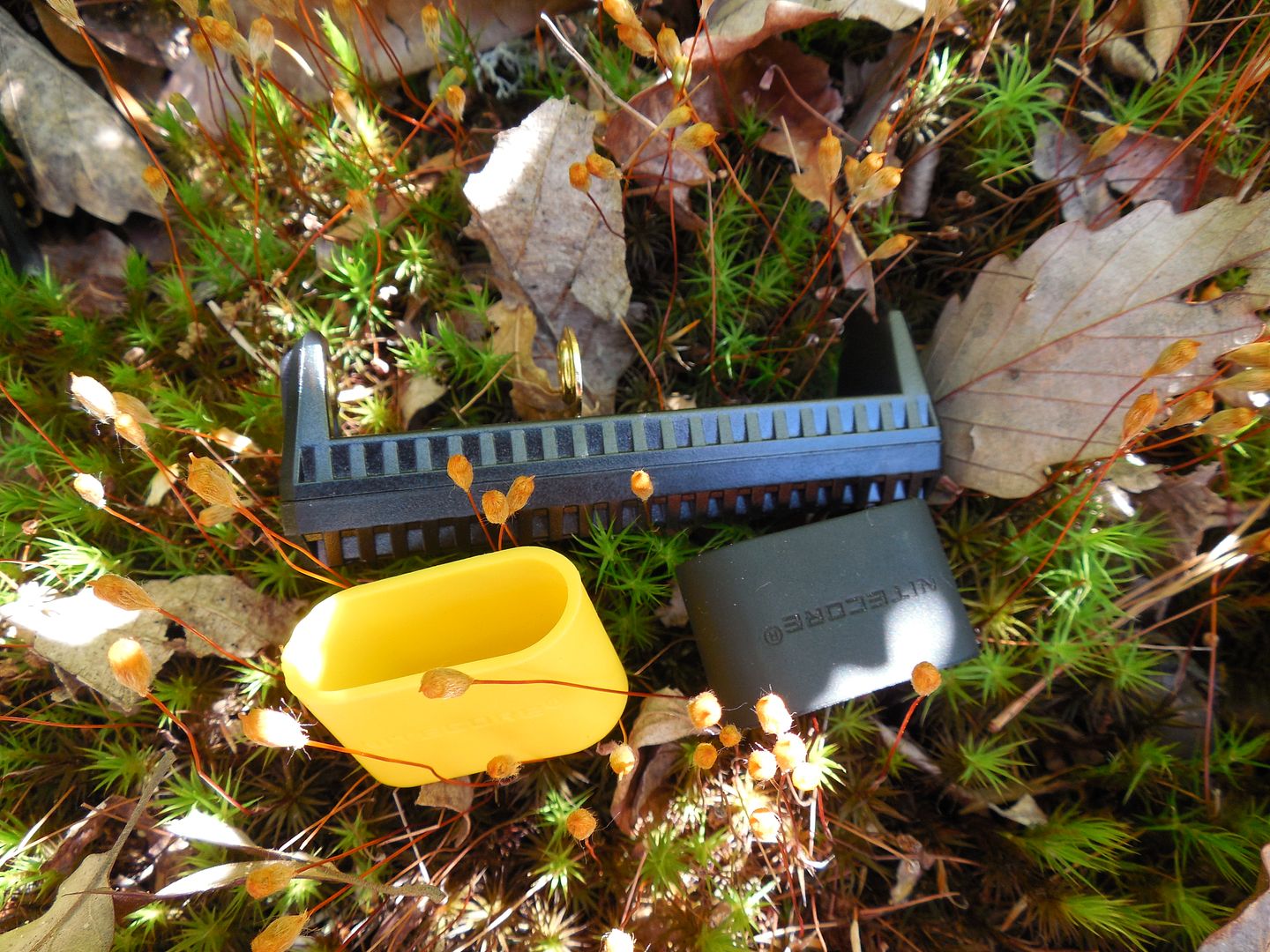

So how do the stats stack up under field use and evaluation? First let's take a look at the F1.

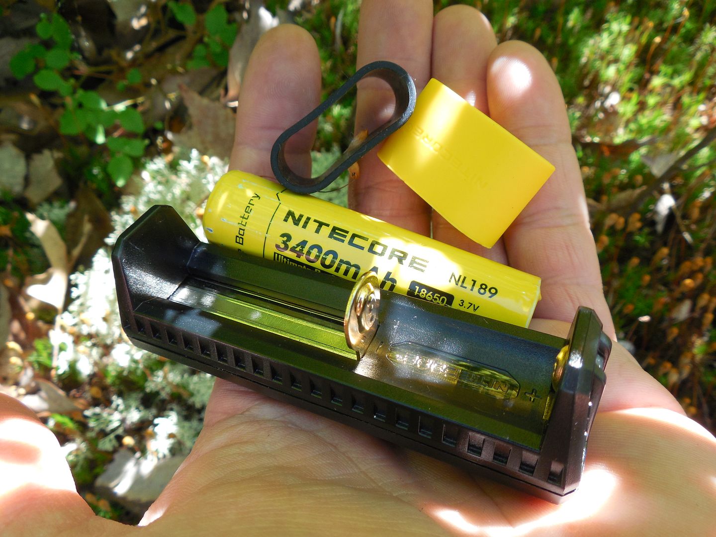

It comes with the charger and 2 wide rubber bands to secure the battery. As only one is needed guessing the extra is a backup. I use the yellow band to increase visibility.
Size comparison to a Nitecore NL189 18650.

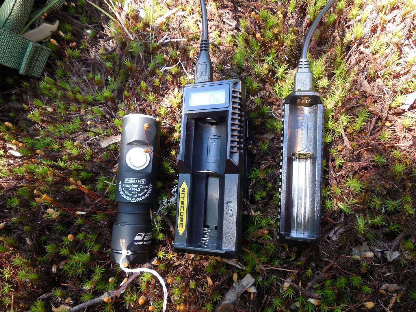

Compared to a Nitecore UM10 Lithium ion charger.
Both compared to a 1XCR123 Armytek C1 Pro.

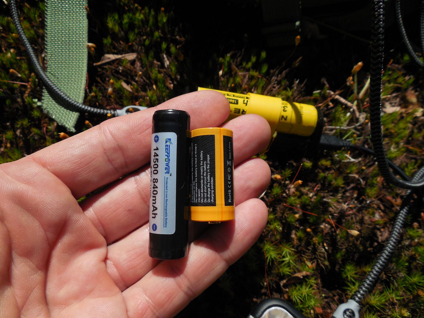

2. When F1 detects a small capacity battery (e.g. 16340, RCR123, 14500, 10440) in its slot, the three
indicators will blink to alarm the user and F1 terminates charging after five seconds to protect the battery.
I have seen flashing for low battery warning and had the F1 terminate charging. I don't remember if it was one or three flashing lights but doesn't matter as got my warning and it gets cranky around 3.3 volts. As for number 2 that's a bit in the air. It would always flash the 3 LED lights as a warning when a smaller capacity lithium ion is inserted but not always terminate the charging. Sometimes it does terminate the charge, other times it appears to trickle charge at such a slow rate as to make using 16340 and 14500 Lithium ion batteries as power banks impractical.
So yes it won't use them for the power bank function as stated but not always in the exact way as stated based on my field use based on my field use. The F1 had no issues charging any of the Lithium ion batteries tested including 16340 and 14500. Was able to use 2600 and 3400 mAh 18650 and 2500 mAh 16650 as a power banks in addition to charging them.

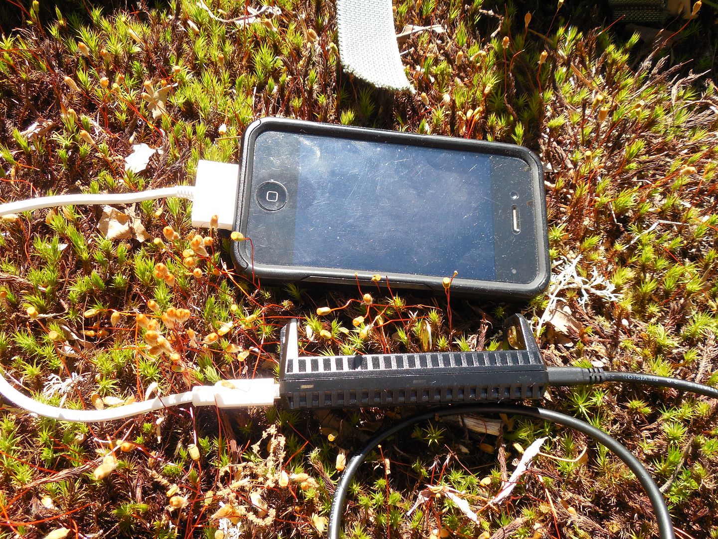

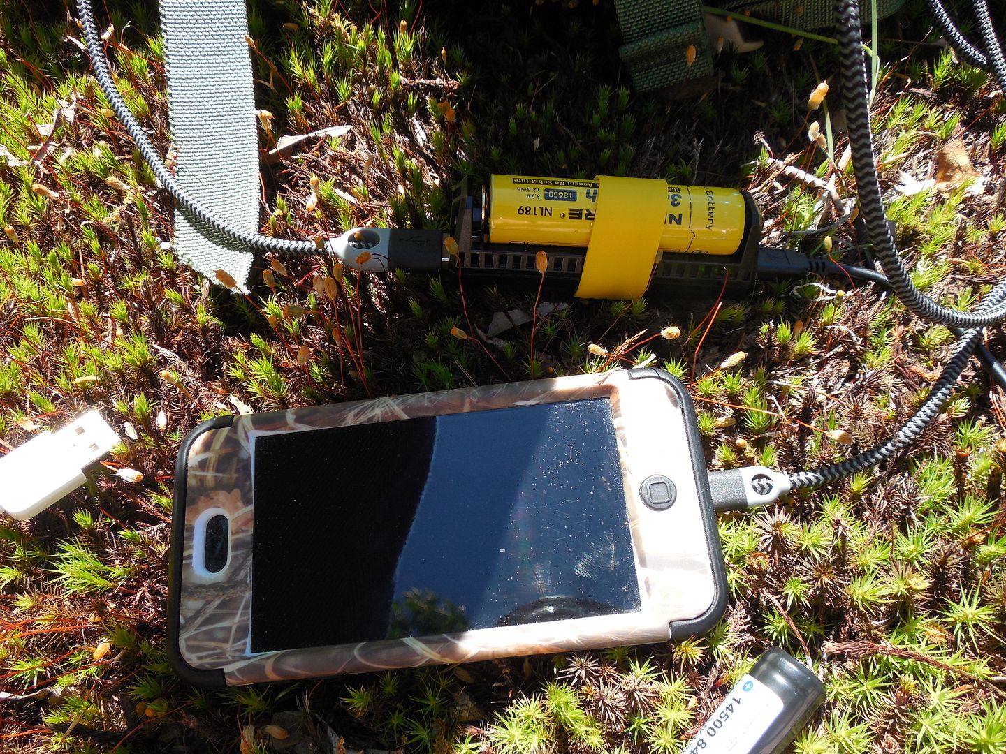

Yes that appears to be the case based on my solar testing. Pass through charging actually works. Both the battery and devices got charged simultaneously via solar.
Micro for the external power in this case solar and standard USB for outgoing power.

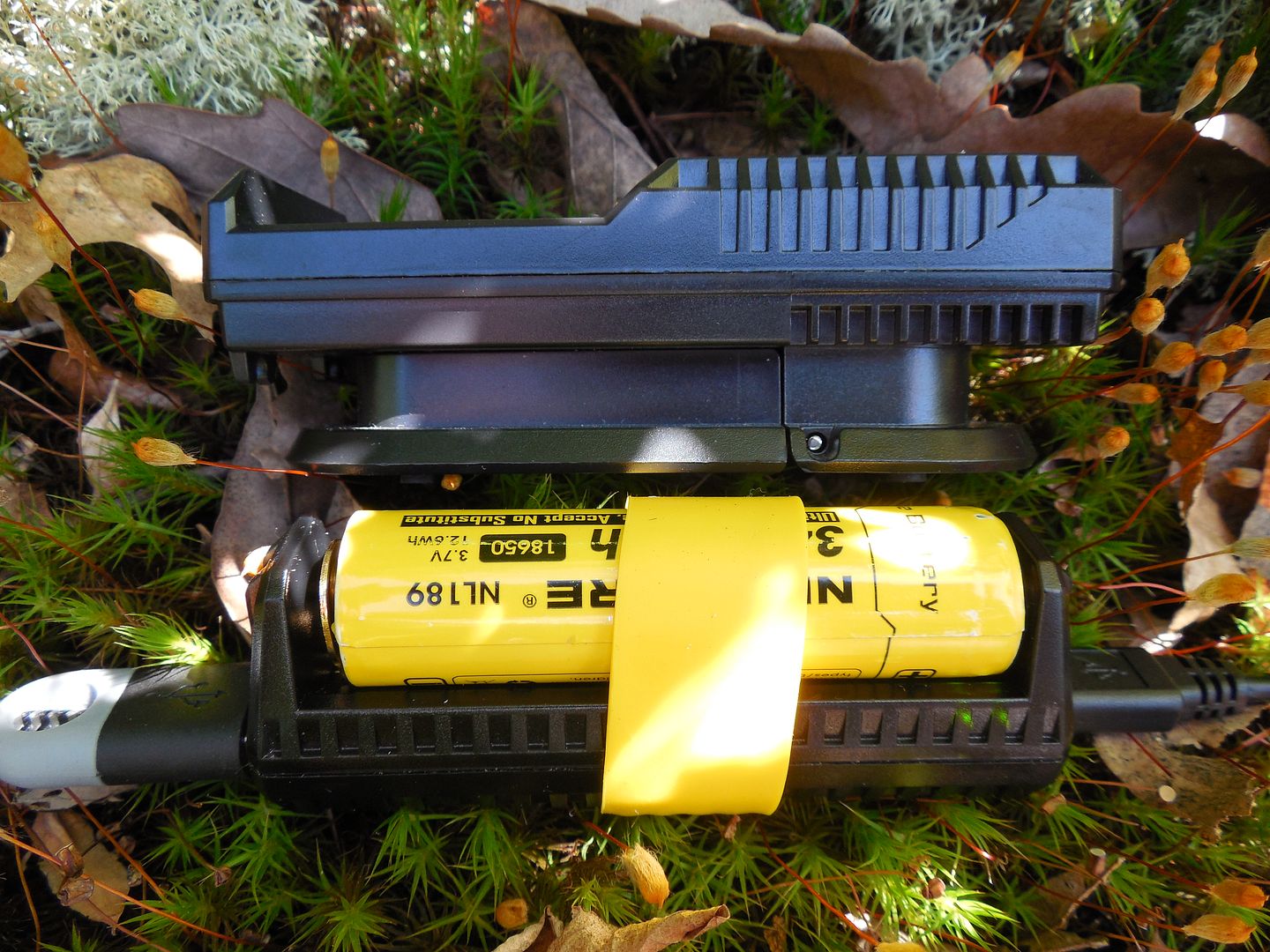

I did test an Iphone 4s and protected 18650 battery using a high efficiency 14 watt Allpowers folding solar panel charger from 10:25 am to 12 PM. The phone and battery were connected via pass through with a single USB port. At 10:25 am the 18650 was 3.7 volts, phone 59%. At 12 PM the 18650 was 4.1 volts, phone 91%.

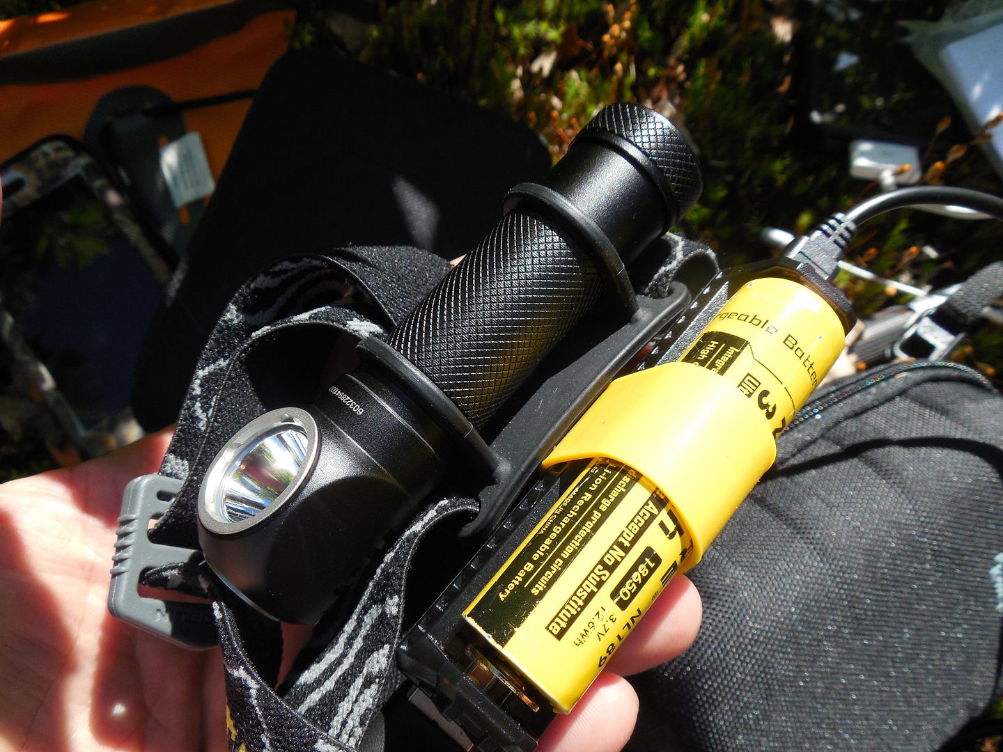

With the BIG power of 18650 batteries and the devices using them it's not hard to see the attraction of using them within outdoors and preparedness applications. For example I put the charged 18650 battery into my Nitecore HC30 headlamp.

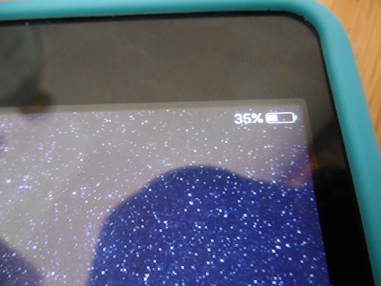

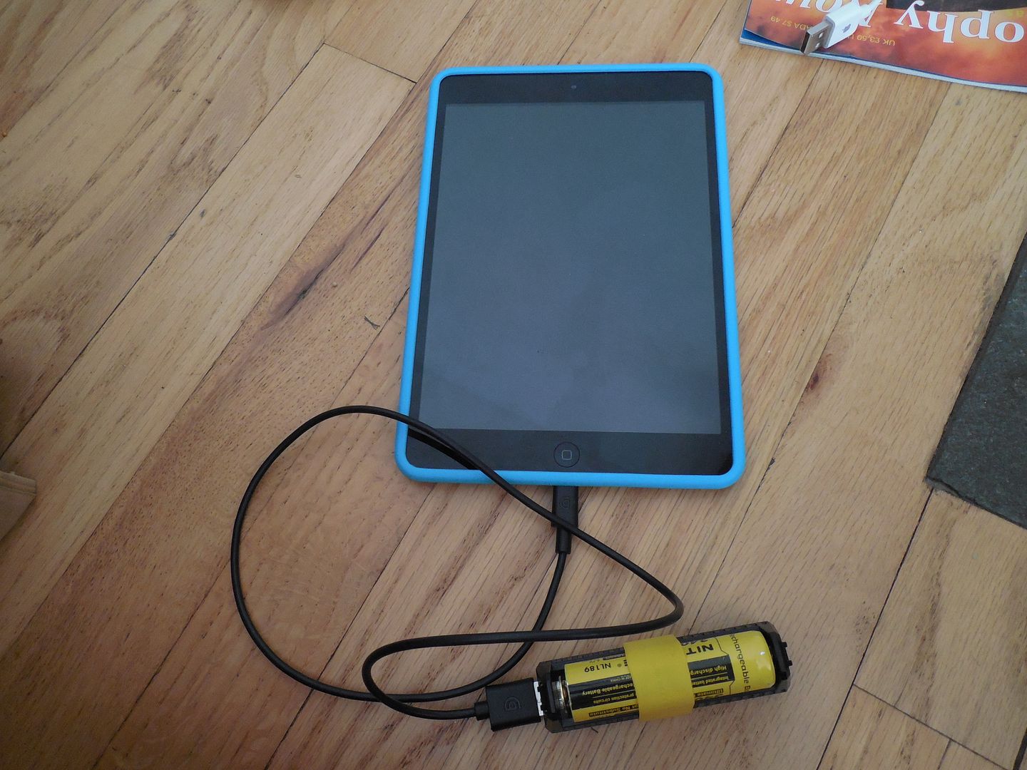

It also charged my Ipad from dead to 35% which is about right for a 3400 mAh battery.

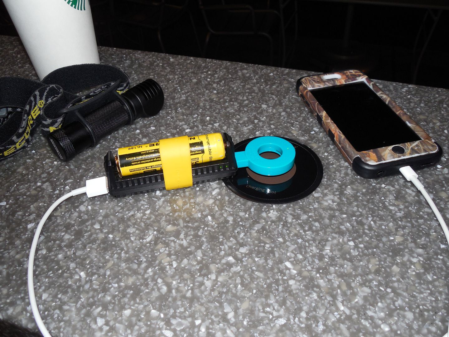

The pass through charging capability is great for times when only one plug is available which happens more often when on the fly. In the coffee shop before a night hike. I am using a public magnetic charging ring. This option is not sold for the F1 however did work just fine. Charging both the battery for the headlamp plus an Ipod 6 which is used to keep track of data like distance hiked etc etc etc. Or browsing the forums on their WiFi without sucking down the phone battery.
