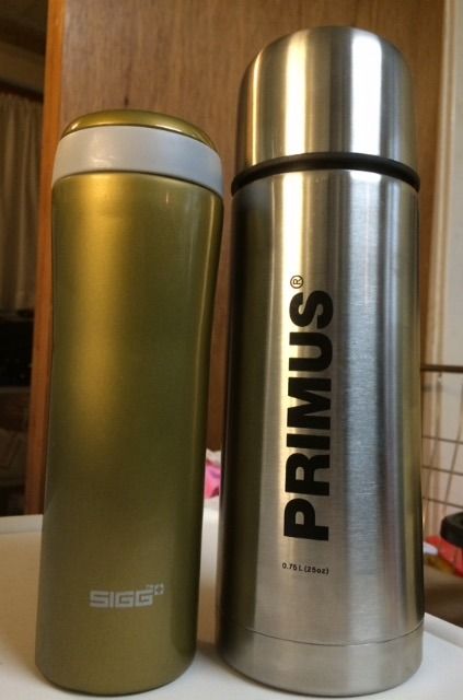

It can infiltrate every aspect of your life. For example here is a quick snap of my travel flasks for coffee... You might expect to see a Stanley or a thermos. Nope.
