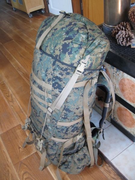

[quote="RonnyRonin"]finally got rid of the awful black drawstring closure. tried a lighter weight (1.9oz?) coyote closure but the drawstring kept binding up and not sealing well. cut that out when I finally sourced some MARPAT cordura, added a 330d roll-top closure:
adds some serious winter BOB or INCH overstuff potential, I couldn't even get the original over-the-top strap to buckle.
Excellent idea. I know you posted this a while ago but I'm considering doing this to my pack. How is it holding up against the weather and would it be too much for me to ask for a short tutorial on how you made this? I keep most of my stuff in waterproof bags but I would prefer if rain didn't get inside of the pack. I don't have a great sewing machine but I think it would handle the ILBE's material OK.
most home machines handle cordura just fine, it's only when you start stacking webbing up that they choke.
waterproofness is the same as any other cordura, will handle a shower just fine or short term rain, but I'm sure it will soak through after awhile, I've only had it out in rain for a half-hour or so.
what I did was cut the collar off but leave just enough of the black material to sew the new collar too. I then measured the opening as best I could (do it several times, this is the hardest part) and then gave myself a few inches extra. I actually sewed it to the pack before I sewed it into the tube, which let me get the diameter just right. guessing how tall to make the extension is another tricky part, it helps if you have a dry bag or another roll top to compare, and as always, give yourself extra. mine is about 12" tall.
the only thing I don't like about it is I didn't really have anything to stiffen the opening like a traditional dry bag so it doesn't roll up as nice, but anything is better then a drawstring.

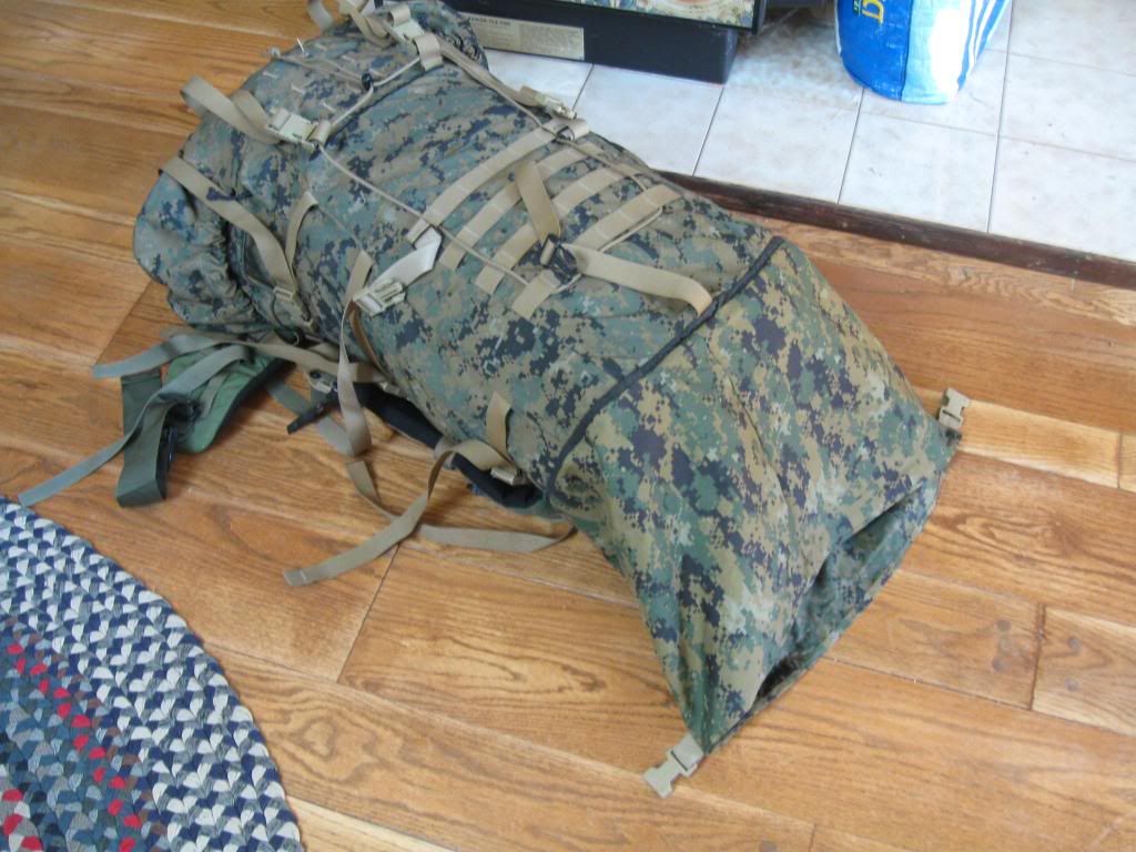

Alright, none of these mods require much sewing and I wanted to thrown them up somewhere visually to spark some interest, but the first has to do with a modified hip belt. I. Know most prefer the forward pull to tighten, so I've reverse engineered and came up with a little switch-a-roo. Good luck finding some of the hardware used as it's been a nightmare!
IMG_0363 by harmonweddings.com, on Flickr
IMG_0364 by harmonweddings.com, on Flickr
IMG_0367 by harmonweddings.com, on Flickr
IMG_0366 by harmonweddings.com, on Flickr
It's basically the hip belt setup on the FILBE main pack. I didn't cut any straps, just flat rolled them and stuck the original, after looping it through the tri-glide, back into the sew in on the hip belt.
