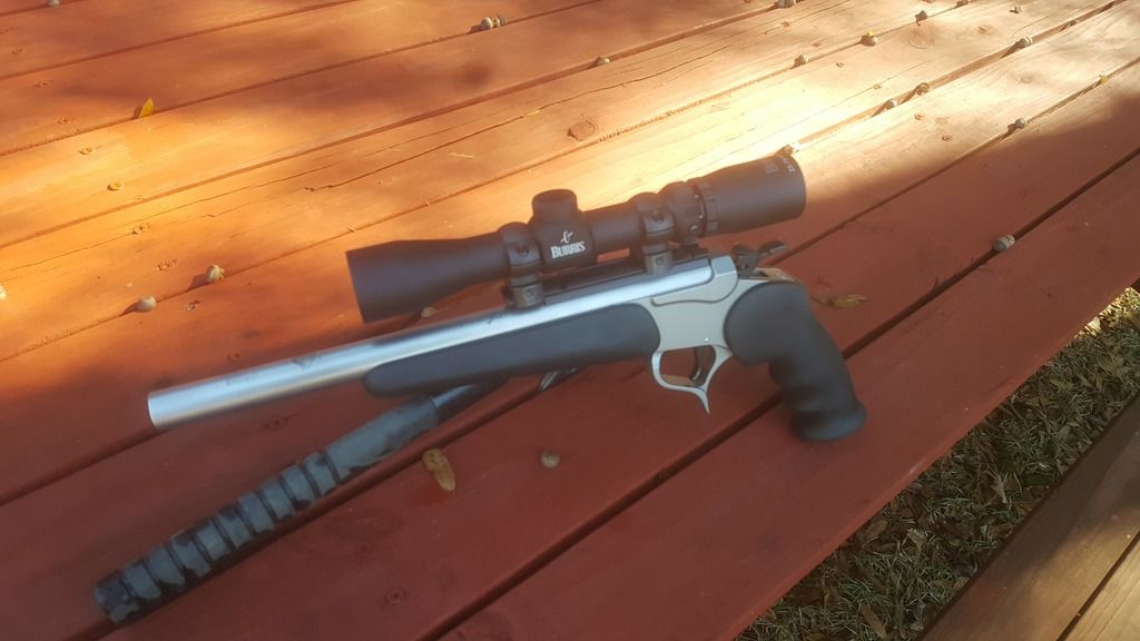

Any Medium ring will do. However, I think you'd like low rings if they will work. Once you get the scope rail mounted, go to your LGS with the scope. They should left you try a few rings for fitment.
Here's a pistol I just got together. Bull barrel, Scope mount is standard thickness of what you'd have on a rifle, Medium ring 32mm obj scope. I'd like a low ring, but on my gun it would interfere with the hammer. I could get a hammer spur and use low rings,.. but ehh,.. I'm kinda just rocking this as is.
Your setup would likely allow you to run low rings as you can get the whole scope over the gun. Just make sure the Eye relief is still good an the length of your arms on High zoom. I will tell you this, the higher the zoom the closer you have to get to the scope. You'll likely be running that scope a 3-4x all the time lest you get smacked in in the head. But,.. that all depends on the scope. Some are better than others. I have Bushnell that's more forgiving with the eye relief than the Burris I'm using now.
