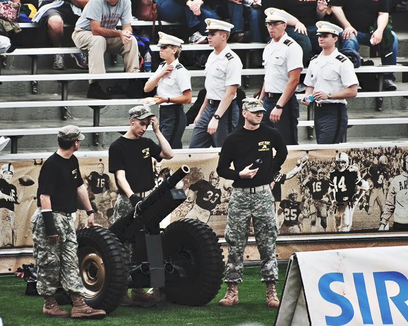

As I have may have mentioned in the past my brother is a Cadet as West Point. He is currently the first Sargent of the cannon crew that is at all of the home and some for the away football games. During the home games they use a special small cannon on the field, along with a battery of 75s a few hundred meters from the stadium. Recently they have been having problems with the smaller field gun. According to him it is a 37mm deck gun from WWI fired by way of a 10 gauge conversion shell. However this is only what he was told and he has been unable to make out the markings on the gun. The gun is getting quite dirty from all it's use as West Point is actually winning games this year. The carbon build up is quite bad, often jamming the breach mechanism and conversion shell, and they only "solution" anyone has is to spray more silicone stuff into the chamber.
My brother would like me to help him A) figure out the providence of the gun and B) find a good way to clean it. As of right now my brother thinks that the gun looks closest to a M3 from WWII that has had the barrel cut down and the breach mechanism "extensively modified". It is not, as I first suspected when I heard "WWI" and "37mm" a M1916 but rather something else. My brother is trying to get me some better pictures of the gun so hopefully we will soon have more to go by there. As for cleaning it I think I have found a solution, a Dewey Grenade and Gas Launcher Cleaning Kit 37mm, 40mm Caliber. However it might be a better idea to just get the mop and brush separately and find a longer handle/rod combo. Presumably since the gun is just firing a 10ga blank stand gun cleaning products should work, but I would like to be sure.
Here are some pictures of the gun, My brother is the one on the far right with the radio. That facial expression runs in our family.
This is a better picture of the gun, but my brother was cropped out:

I asked about the powder type and the blanks are standard smokeless 10 gauge, not black powder. The primary problem is carbon build up which is causing the subcaliber adapter to get stuck after firing and making it hard to reinsert the adapter after reloading. The current "solution" of spraying more silicone crap into the chamber is not helping. Since it's not blackpowder I think that the best bet would be normal gun cleaning chemicals (M-Pro 7, etc.) along with the brush and mop set I linked and a rod that is both thicker and longer than a stand cleaning rod as normal ones might get all bendy in the barrel.
Also we still have no idea who made the gun. I sent my brother some links to the Hotchkiss 1-pounders and he said it didn't look like that, but rather an M3 if "some of the top sides of the breech area had been cut down". Pictures will apparently be forthcoming later this week.

Post by Quartermaster » Mon Oct 11, 2010 10:54 pm
I looked at the photos and the gun could be M3 but there are a couple of other possibilities. The M1916 was a WWI French gun for cleaning out machine gun nests. The U.S. army ended up with a lot of them after the war and designated them as the M1916. There is mention of the flash suppressor being removed and the gun altered for sub-calibre firing. It is a pity there are no available markings because it could also be a Russian 37mm gun from WWI. Our country ended up with some of those following the 1919 Siberian Intervention.
I still think that either boiling hot water w/laundry soap or the home made mixture I mentioned might be the cheapest way to go.

I thought it might be an M1916 at first too, but the M1916 has a very distinctive breach and the gun is definitely not one of those.
