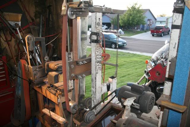

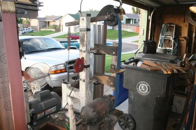

Using a stone wheel bench grinder is gonna be frustrating, slow,unsatisfactory, and potentially dangerous. The standard in the knifemaking world is a 2" x 72" belt grinder with at least a 1 hp motor, and buying those is going to start out at $600 and go up from there: http://www.grizzly.com/products/G1015" onclick="window.open(this.href);return false;
Here's a really nice one I'm eyeballing: http://www.twuertz.com/" onclick="window.open(this.href);return false; That's over $3000. Some day.
Then there're the homebrewed options:
But, without getting into making your own grinder or laying out a lot of cash, your best bet is probably going to be a steady hand and an angle grinder with the appropriate wheels. This guy's early knives were shaped entirely using and angle grinder on the balcony of an eastern European apartment.
http://tomasrucker.com/knives/Custom_Ha ... Rucker.htm" onclick="window.open(this.href);return false;
Of course, he's an artist and has a good eye for design (he takes purty nekkid lady pictures also). If you look at some of his plunge cuts, you can see it's been done with an angle grinder (not that I guessed from that, he has shown pics of his process on another forum).
You're bound to screw up the grinding on the first few, especially if you try it on a bench grinder, so I'd recommend practicing shaping with mild steel before you pay for the blanks to be cut from D2.
