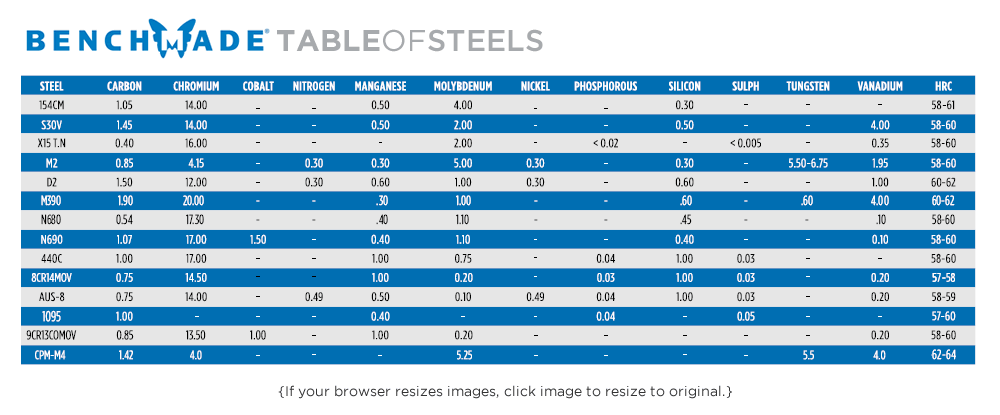

wolverine_173 wrote:So ive been doing some research on blade material. I dont like to spend a lot on knives for various reasons. It seems i can get cheaper knives from china that perform just as well as more expensive knives.
chinese brands such as harnds, enlan, and sanrenmu say they make their knives out of 8cr14mov, 8cr13mov and 8cr13mov. The knives run about 15 bucks and from my research that steel is just as good as asu-8 steel
from what i hear its on par with crkt's, spyderco, kershaw blades that cost $30.
Does anyone have insight or experience? Im also want to hear about 9cr18mov, is it much better than 8cr13 or 14mov? And how about s30v steel?
The steel is almost the same.Why are the cheaper?
1 the overall workmanship is poor
2the value of the dollar verse yen
3 cheaper labor
4 they are lying about the materials used
All I can say is buy it and try it and let us know what you think

Going from the data on the chart provided by buck85, it looks like a good alloy. I call into question whether that knife linked to on Ali Express is made of that steel, heat treated right, or any other aspect of construction on it done right. Something made from it by a maker/company that doesn't lie to you about their product is probably a good choice.
