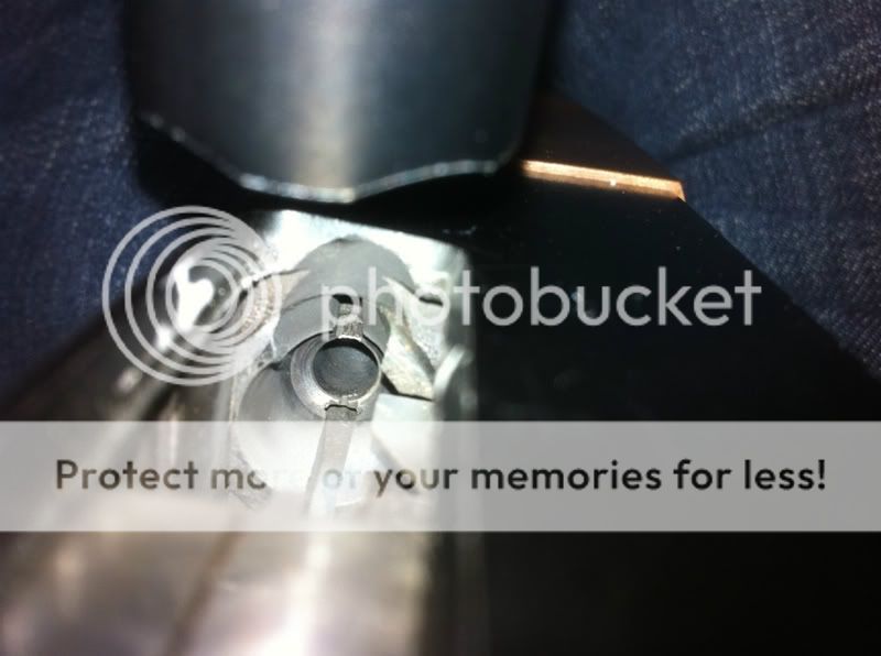

let me just say something from my experience with older rimfires: dont risk dry firing them
i have a winchester model 250 lever action .22, made in the 60's and through the course of about 200 times dry firing it, i screwed up the chamber bad, snapped off part of the the firing pin/ejector. the edge of the chamber was dented in, causing the displaced metal to jut out into the chamber, making it impossible to chamber a round. i had to go at it with a diamond etching bit on a dremel to smooth out the chamber again, and buy and install a new firing pin (was a bitch to find)
EDIT: you can see the indentation on the edge of the chamber here. it should be completely flush with the rest of the chamber
