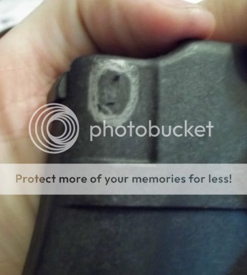

If you're determined to try and get them to fit apparently the issue is that with many of those Master Molder AK mags the mag is too large for most AK mag-wells and they grind on the front left and right when the shooter tries to insert the mag.
http://prep2survive.blogspot.com/2012/03/i-picked-up-some-new-magazines-this.html?m=1
This is the spot where many of these particular brand of mags grind when the shooter tries to insert the mag.
Using a dremel or a file a little bit at a time the way Regular Guy suggested above and then checking re-fit after each little bit is removed may help. Just remember you can always file more off, you can't add material back to the mag once it's off.

Thanks all. Mine do have rub marks on the sides similar to the above pic, but it still goes in-It just won't hook on the front. The back will latch, but the front doesn't seem to engage, and just rotates out. I'm going to take em to the LGS and see if it fits any of their AK's other than CIA WASR's. I don't think it's the rifle so much, simply because I have several other brands of mags, both steel and polymer that fit fine. None have the dreaded WASR Wobble either, they fit well. I think the front lug on the MM mags is just maybe not deep enough to engage? Either way, if I find it fits other AK's, I think I'll put em on Ebay, and just stick with what I know fits for mine. Thanks again!

I'm pretty sure that deepening the front latch and making it steeper (giving it a little more to grab onto) would work, but you're probably better off letting a gunsmith do it.
